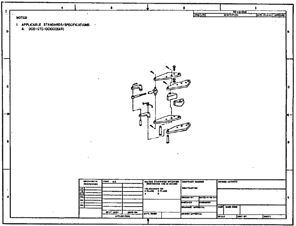

Mistake #2: Providing an Assembly Drawing Without Part Details
Another challenge with legacy components is that they may actually be the upper-level assembly of several discrete mechanical components. Assembly drawings are typically built to define how each component relates to the other when assembled. This can include how many of each component, each component's unique name, how many of each part is needed, and possibly some minor distance or fit validation measurements. Unfortunately, that does not help the manufacturer if they are needed to make the sub-components of the assembly. Manufacturers require detailed mechanical drawings of each part to properly build the finished product.
One thing a buyer or engineer can check for when sourcing for assemblies is if each component is outlined on the drawing with technical specifications. This should be specifications like dimensions, material, finishes, and markings. Assembly drawings can have a front page bill of material sections that outline the components, quantity, and sometimes (if you’re lucky) following pages in the drawing with their supplemental manufacturing information.

  • A drawing with incomplete information for the assembly parts
Assembly drawings typically do not have enough information to build any discrete subcomponents. (Image Source: DOD-STD-100D)

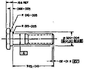

Mistake #3: The Drawing is Incomplete
This third challenge marks a paradigm shift between older, 2D-drawing-only prints and newer, CAD-controlled drawings. In CAD-controlled drawings, the best practice is to provide the 3D CAD model and use the print for supplementary critical tolerances, threads, features, finishes, etc. The 3D CAD model is sufficient for the majority of the part’s geometry while the supplemental drawing can provide select details that the 3D CAD does not. When providing a manufacturer with only a flat drawing, such as a PDF or even a hand sketch, the information must be complete. There should be a reference for every hole location, fillets, feature distances, threads, depths, etc. A fully defined drawing ensures that, if properly produced, the part will have no critical variation between manufacturing runs or individual manufacturers.
Incomplete information, like the missing thread call out in the image to the left, may not always be as obvious as a missing measurement. Sometimes it could be missing notes, like materials or finishing requirements. In legacy drawings it may be a specification call out to an unreleased internal document. Manufacturers typically look at the part, then to the title block, then to the notes, and repeat to check if all information is available to successfully produce the project.

  • An incomplete drawing
Although barely legible, this drawing looks complete until you realize the bolt hex size and the threads themselves are not defined at all. Incomplete drawings can stop a machinist from completing their work. (Image Source:DOD-STD-100D)

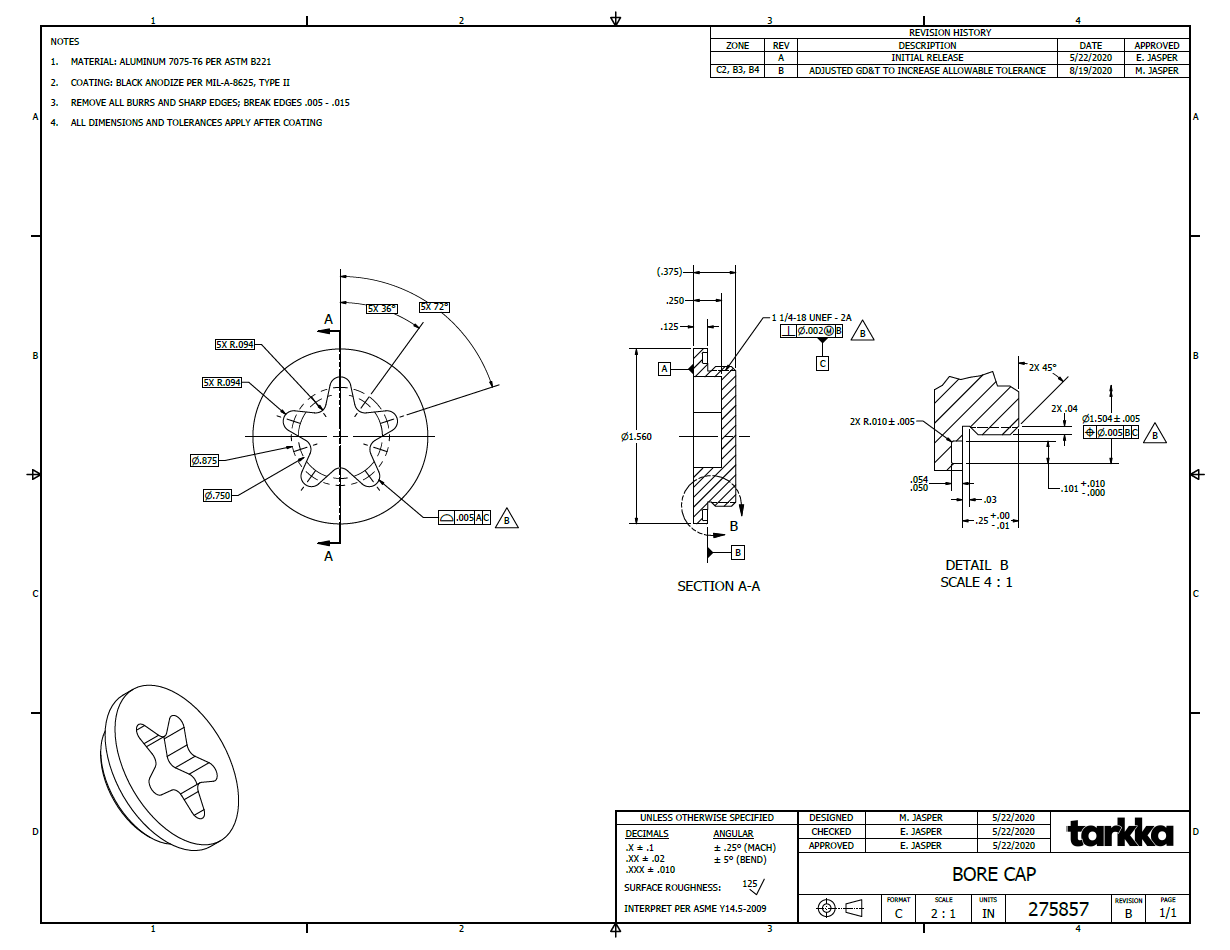

Best Practices for Manufacturing-ready Drawings
When working with a legacy drawing, scan, or hand sketch, check for the following before submitting to a manufacturer:
Title block information
  • Part name, part number, and revision
  • Unit scale (inch, millimeter, etc.)
  • Title block tolerances (e.g. per ASME Y14.5-2009)
  • Drawing perspective, e.g. 3rd angle projection
  • Sheet page and number of pages (to check for missing pages)
Part-specific information
  • Appropriate drawing views and dimensions for each feature
  • Datums, GD&T, or critical tolerances as applicable
  • Threads callouts with size, tolerance class, and depth
Numbered notes section
  • Material and alloy grade or specification
  • Coating or finishing notes and requirements
  • Edge break requirements
  • Other notes and flagged indicators on the drawing where they are relevant
