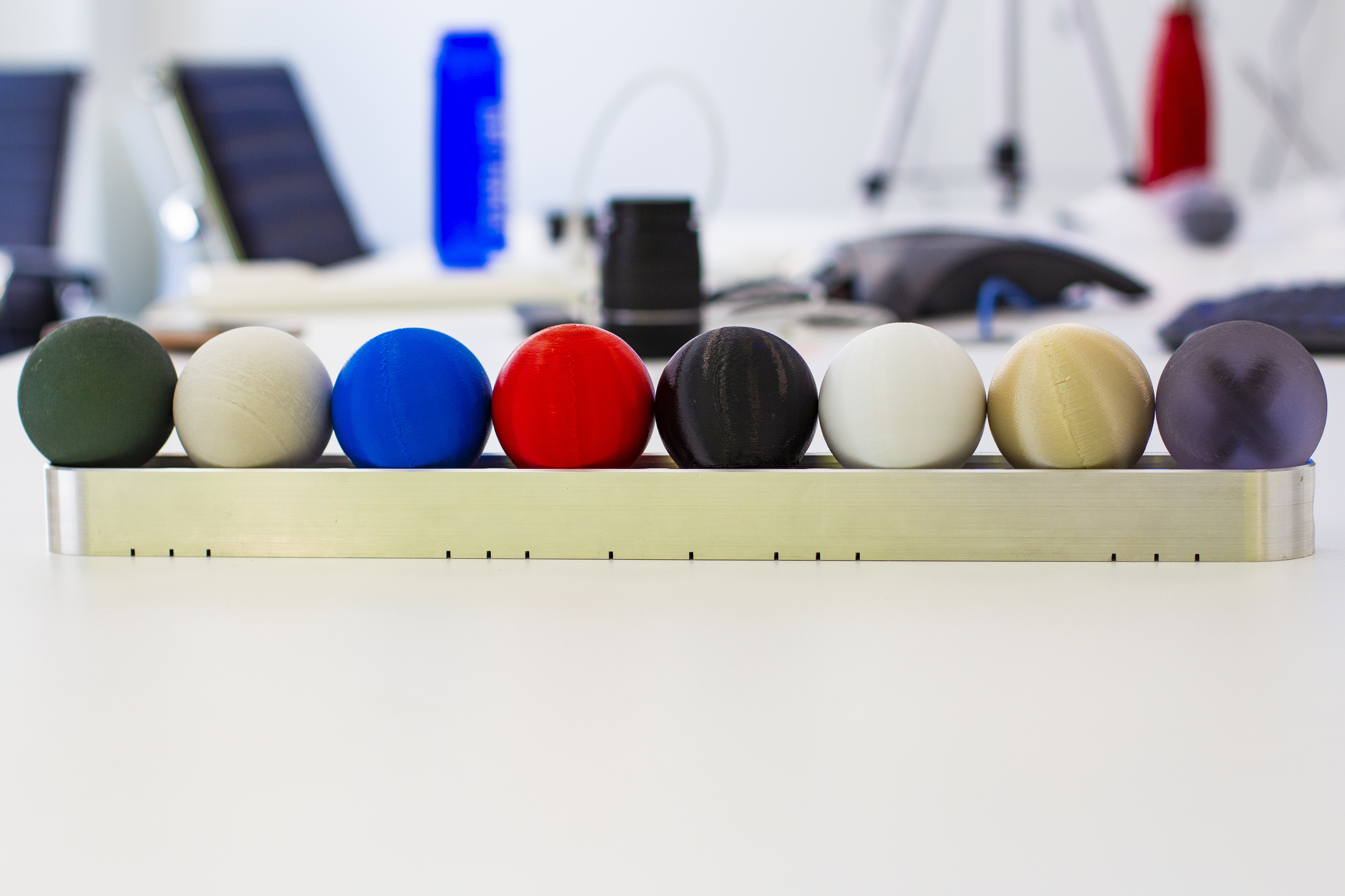

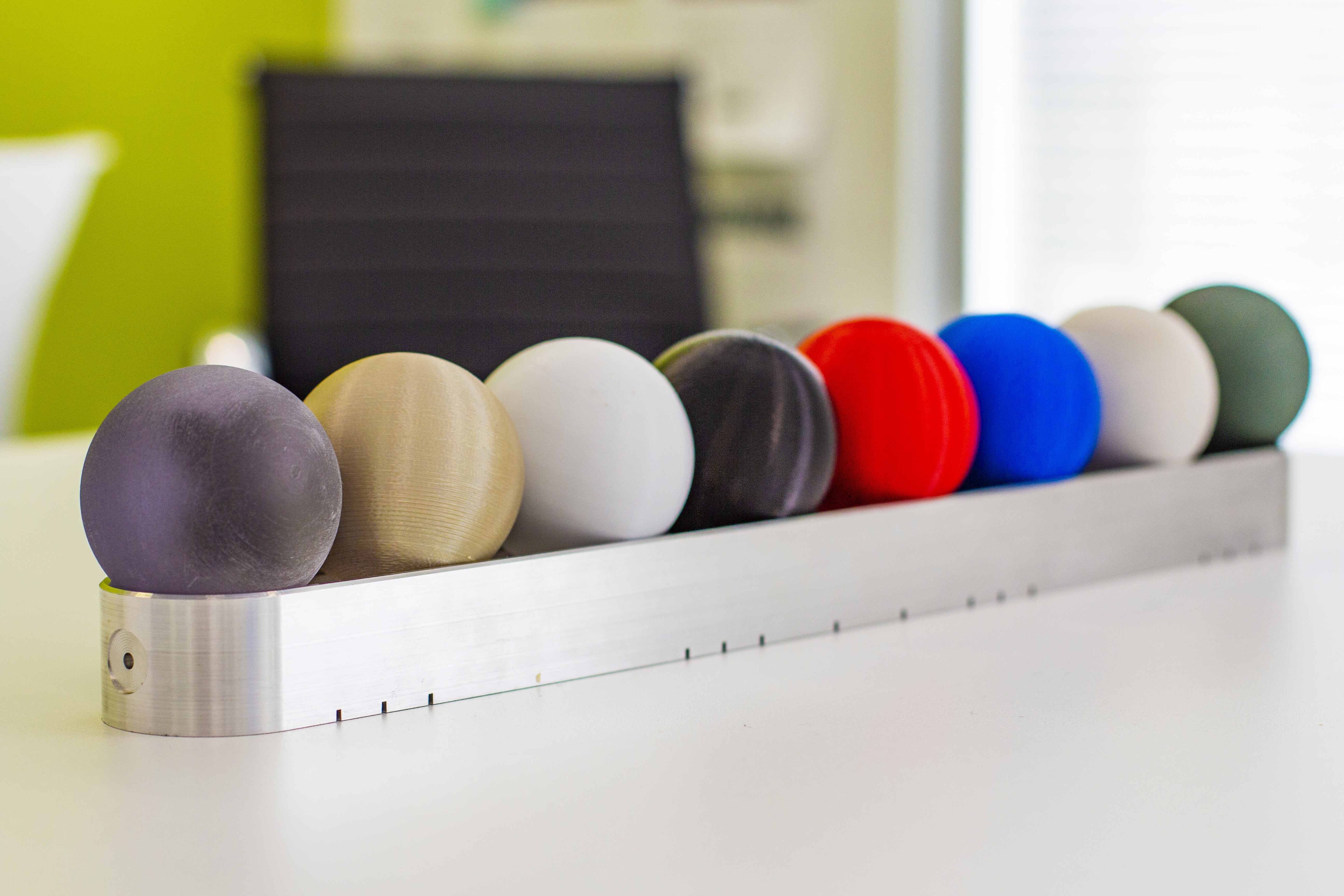

These are the materials we tested and what we suspected would happen:
ProcessMaterialHypothesis
Process
Material
Nylon 12, dyed green / Nylon 12, glass-filled
Hypothesis
No break / Possible chipping
Process
Material
ABS-M30, solid / ABS-M30, ultralight / Polycarbonate, solid / Nylon 12, solid / Ultem 9085, solid
Hypothesis
No break / Dent or break / Chip / No break / No break
Process
PolyJet
Material
Multi-material rigid / Shore A 50 rubber-like
Hypothesis
Chip or shatter / Coarse tearing
