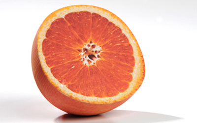

Build Material: Paper-like
Material Distribution Method: Sheet
Binding Technique: Adhesive
Photo credit: 3dprint.com
Speaking of document printers, sheet lamination is the other side of the coin that shares a link to its 2D ancestors. Instead of the jetting process that binder jetting borrows, sheet lamination borrows the medium.
Sheet lamination is the process of building up layers of paper or paper-like material (each with its own 2D pattern) to create a 3D object. It could technically be done by hand if you are good enough with some scissors and a glue-stick. The advantage to automating the procedure is accuracy and the ability to apply color to the same degree of detail we expect from document printers. This process will be great for creating model with a photo surface (such as that from a 3D scan) and is one of the more affordable processes. However, it is limited in the materials it can use, limiting its utility.
