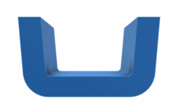

Not adding draft
Draft is needed in the mold to release the plastic part from the mold. Plastic generally shrinks towards the center of the part. Without draft, the part will stick in the mold and will not eject correctly. Design in 1° per side if possible, but any draft will be helpful to release the part.
Slide 1 of 1
  • Draft angles
Draft angles

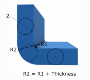

Uneven wall thicknesses
Varying Wall Sections are common in part designs and can cause unintended part properties when molding. Plastics have a hard time flowing and transitioning between uneven wall thicknesses. Thick wall sections create differential shrinkage which may lead to part deflection. Try to keep the walls at least thicker at the gate area and thinner at the end-of-fill. Shoot for .080-.120” wall thickness and utilize ribs and gusset features in your part design.
Slide 1 of 1
  • Wall Thickness should be R2 = R1 + Thickness

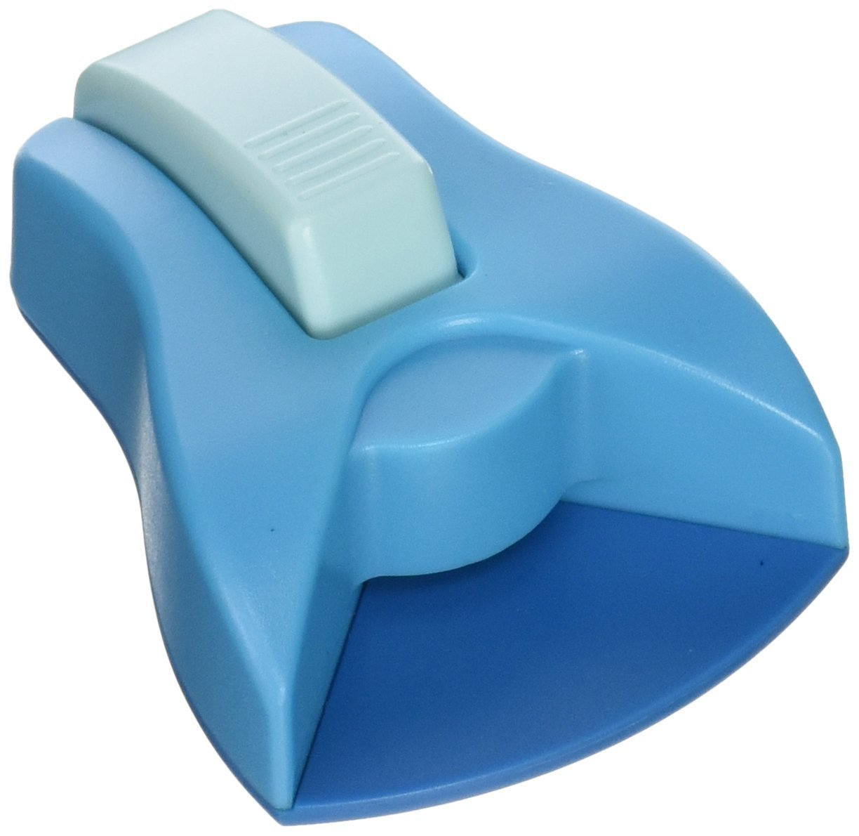

Unnecessary undercuts
Undercuts are designed-in, and often overlooked due to the complex nature of part design today. An undercut in the mold will need to be released before the part ejects or it will tear the feature out. There are many ways to release the undercuts with thru-coring design, slides, cores or lifters in the mold action. Simple rule for tooling: Undercuts+complex mold= more money.
Slide 1 of 1
  • A part with a likely unnecessary undercut
A part with a likely unnecessary undercut. These will dramatically increase costs.

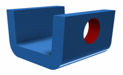

Not embracing radii
Corner Radius is often overlooked in the part design. Corner radii strengthens that area and makes it more robust in the long term. Radii reduces stress concentrations and fractures in the plastic part. It also makes the part look aesthetically pleasing and lowers any risk of injury when handling.
Slide 1 of 1
  • A part with corner radii
