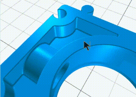

For instance, the part featured below has several different internal corner radii, which adds complexity to the design, and with it, manufacturing costs.
Slide 1 of 1
If possible, pockets such as these should be designed with the same specs. This helps reduce costs in two key ways:
  1. Eliminates the need for multiple tools, which can increase purchasing costs.
  2. Helps minimize tool changes, which can increase run time significantly.
As a best practice, we also recommend designing your part with the largest acceptable internal corner radii (note: for optimum cost efficiency, design pockets to have a depth no greater than 3X the internal corner radius). This allows for a larger cutting tool to feed faster, further optimizing cycle time and costs.
