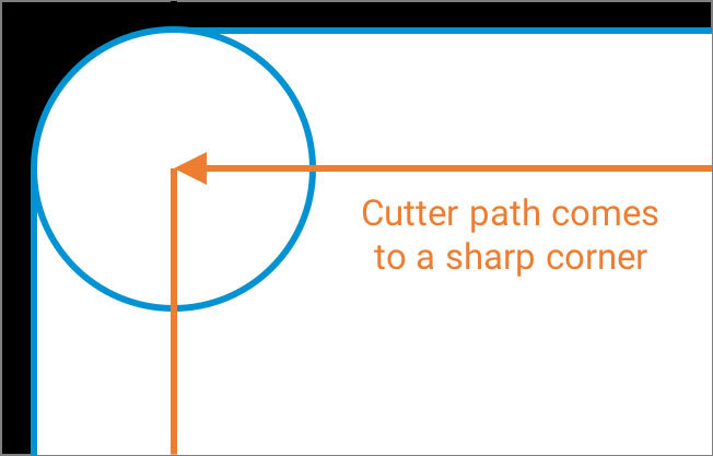

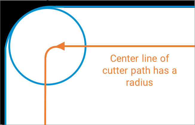

Create Wide Corner Radii
Slide 1 of 2
Diagram of cutter path coming to corner
center line of cutter path has a radius
End Mills automatically leave rounded internal corners. Larger corner radii mean that larger tools can be used to cut the corner, which cuts down on run time and as a result decreases cost. By contrast, a narrow internal corner radius requires both a small tool to machine away material and more passes — often at slower speeds to reduce the risk of deflection and tool breakage.
For optimum design, always use the largest corner radius possible and keep a 1/16″ radius in mind as a lower limit. Corner radii smaller than this require very small tooling and the run time increases exponentially. In addition, try to keep internal corner radii the same, if possible. This helps eliminate tool changes, which adds complexity and can increase run time significantly. For more information on corner radii, check out our blog on optimizing internal corner radii.

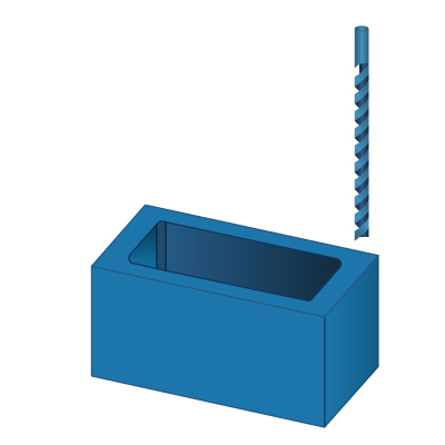

Avoid Deep Pockets
Slide 1 of 1
Image of part and drill bit
Parts with deep internal cavities are often time-consuming and expensive to manufacture.
The reason is that these designs call for fragile tools that are susceptible to breaking during machining. To avoid this, the end mill should be progressively “stepped down” in uniform increments. For example if you have a pocket that is 1″ deep, you may take repeated passes with 1/8″ Depth of Cut and then a final finish pass with a 0.010″ depth of cut as a finish pass.

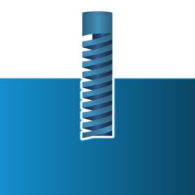

Use Standard Drill Bit and Tap Sizes
Slide 1 of 1
image of drill bit
image of drill bit
image of drill bit
Utilizing standard tap and drill sizes will help reduce time and save money on your parts. When drilling, keep sizes to a standard fractional number or letter. If you aren’t familiar with drill and end mill sizes, it’s safe to assume that conventional fractions of an inch, like 1/8”, 1/4”, or whole numbers of millimeters will be “standard.” Avoid using measurements like 0.492” or 3.841 mm.
For taps, 4-40 taps are more common and generally more available than 3-48 taps.
