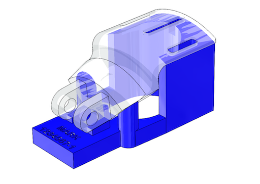

A 3D printable fixture for laser marking
This laser marking guide was 3D printed using PolyJet Shore A95 rubber-like material to prevent damage to the part.

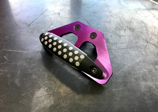

Jigs and fixtures often are built using a variety of materials
This part of a large fixture uses a COTS handle and fasteners to assemble purple anodized machined aluminum and acetal sub-components.
