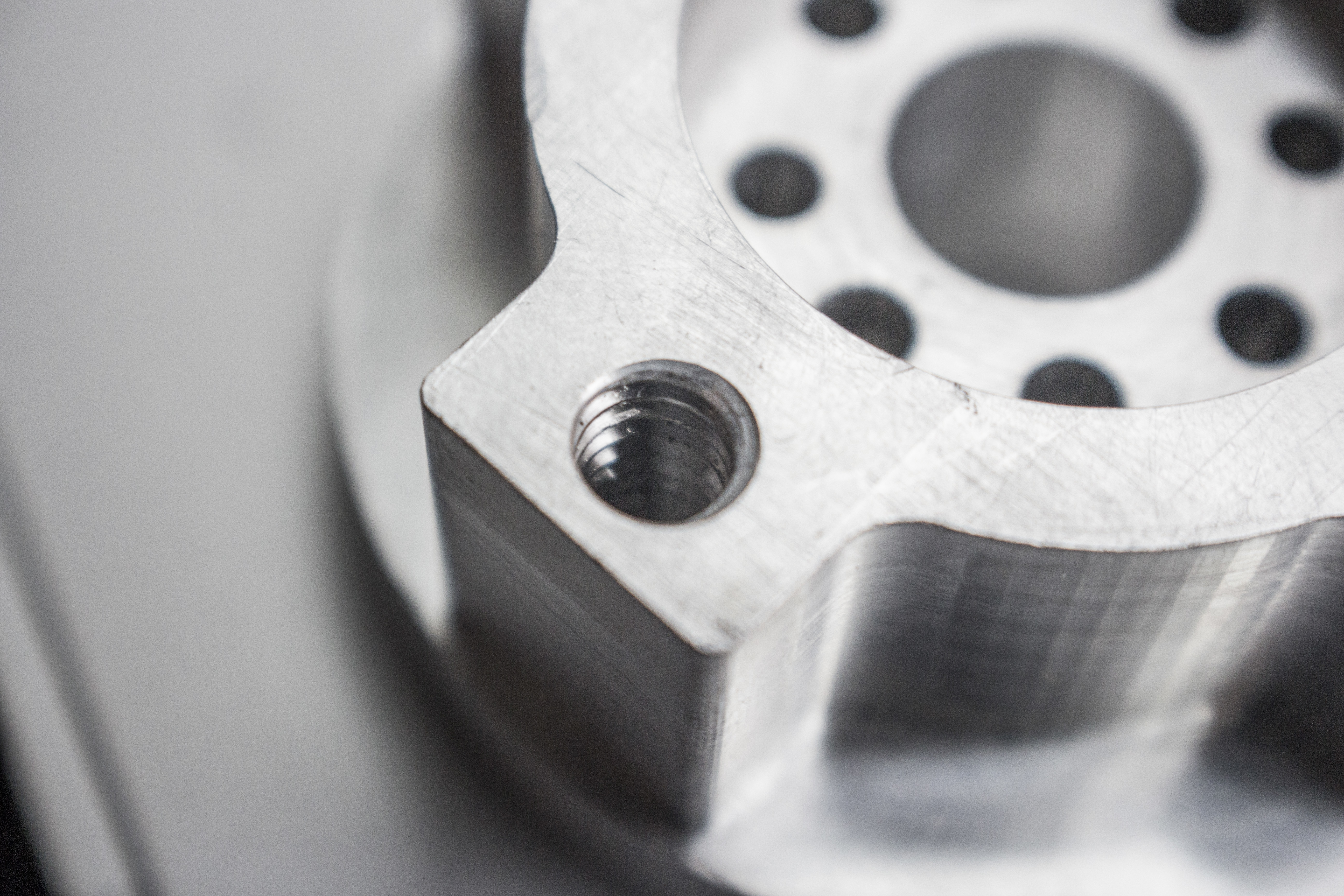

Tapped Holes
Tapping
Xometry technicians use taps or dies to cut or form threads into parts. This works well with machined components, printed metals, and SLS nylon. For more information regarding the required hole size and depth for your design, please refer to this chart.

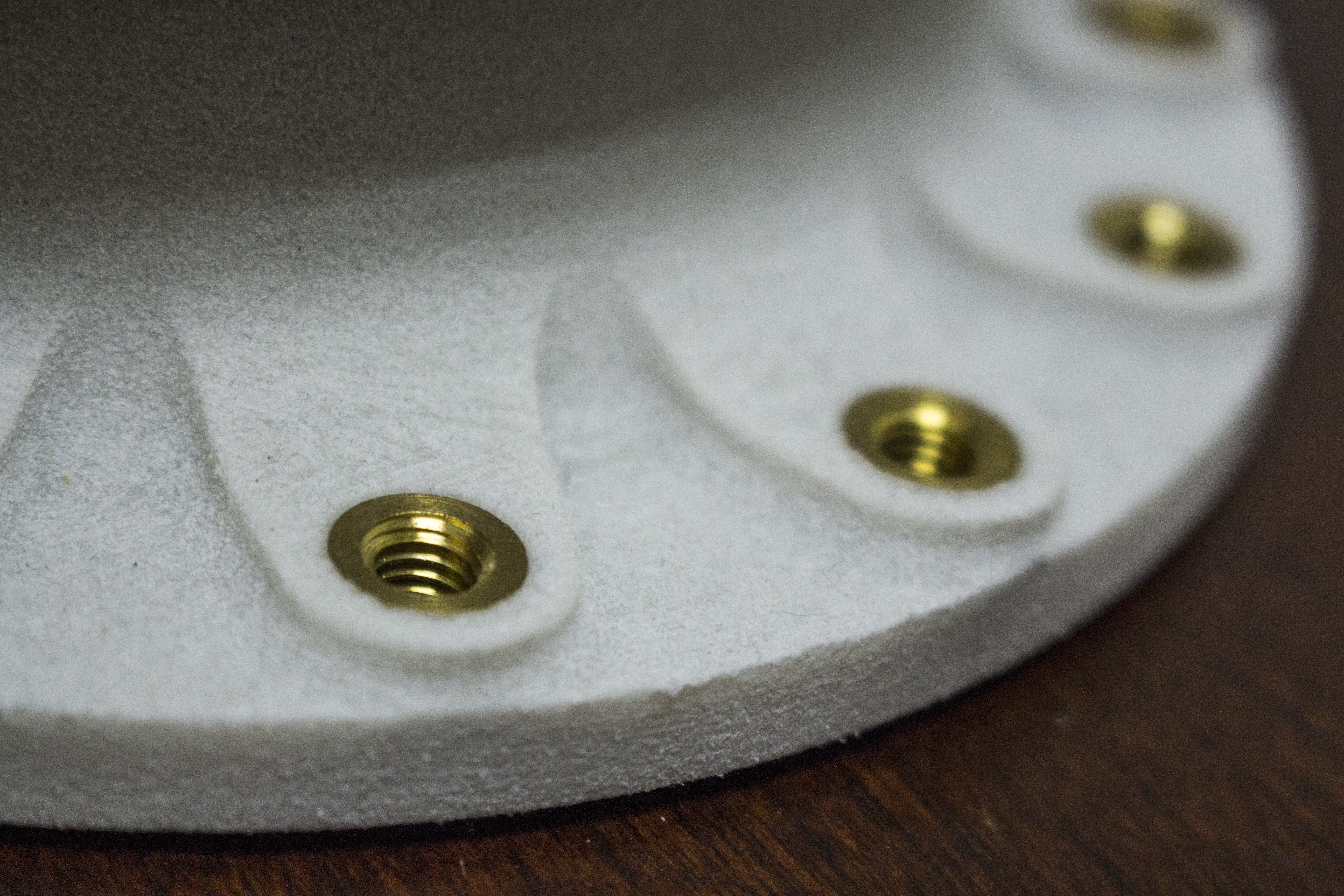

Inserts
Inserts
At Xometry, we recommend designing your parts for press-fit inserts when the material may be soft, such as nylon, since they tend to be more robust than tapped holes, especially when screw installations or uninstalls may be repeated or your part needs to withstand higher torque.
By adding an insert, such as a brass screw-to-expand or helical thread, you are able to provide a durable thread for your part. Please see information regarding the required hole size for your design here.
