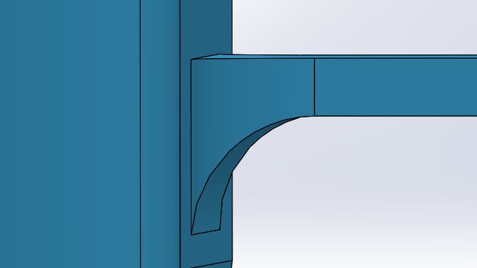

Image of a fillet
Image of a fillet feature

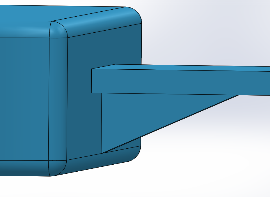

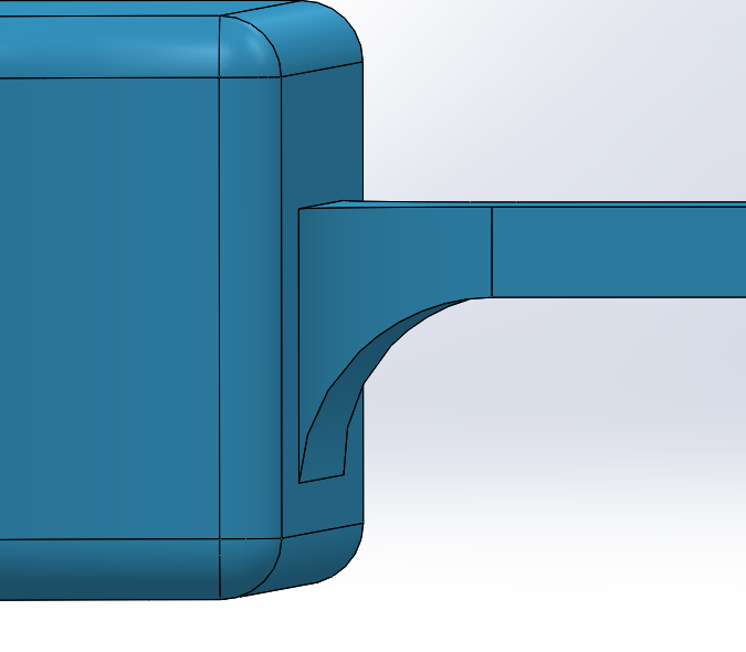

Ribs and Fillets
Ribs and fillets are a great way to increase structural support in your part. But designing them too thin or improperly levels them susceptible to breaking. In all additive processes, it is important to make fillets as large as possible in order to increase surface area involved in a connection.

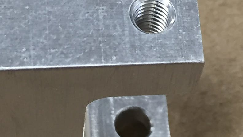

A tapped hole
An example of a tapped hole

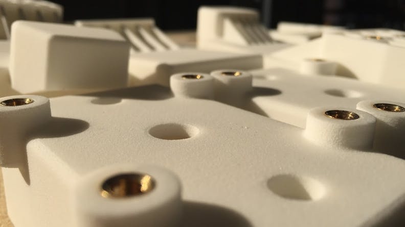

An insert
An example of an insert

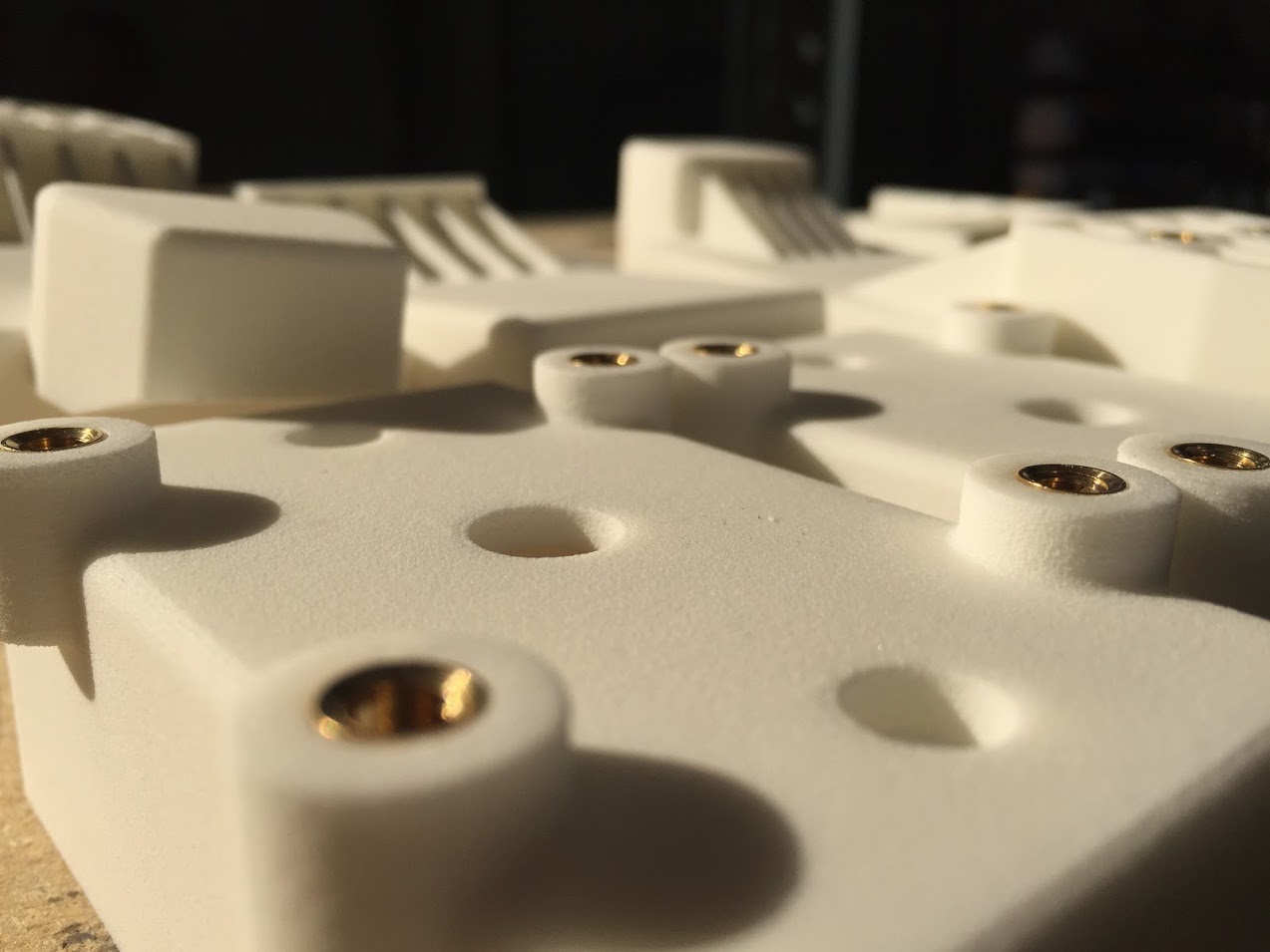

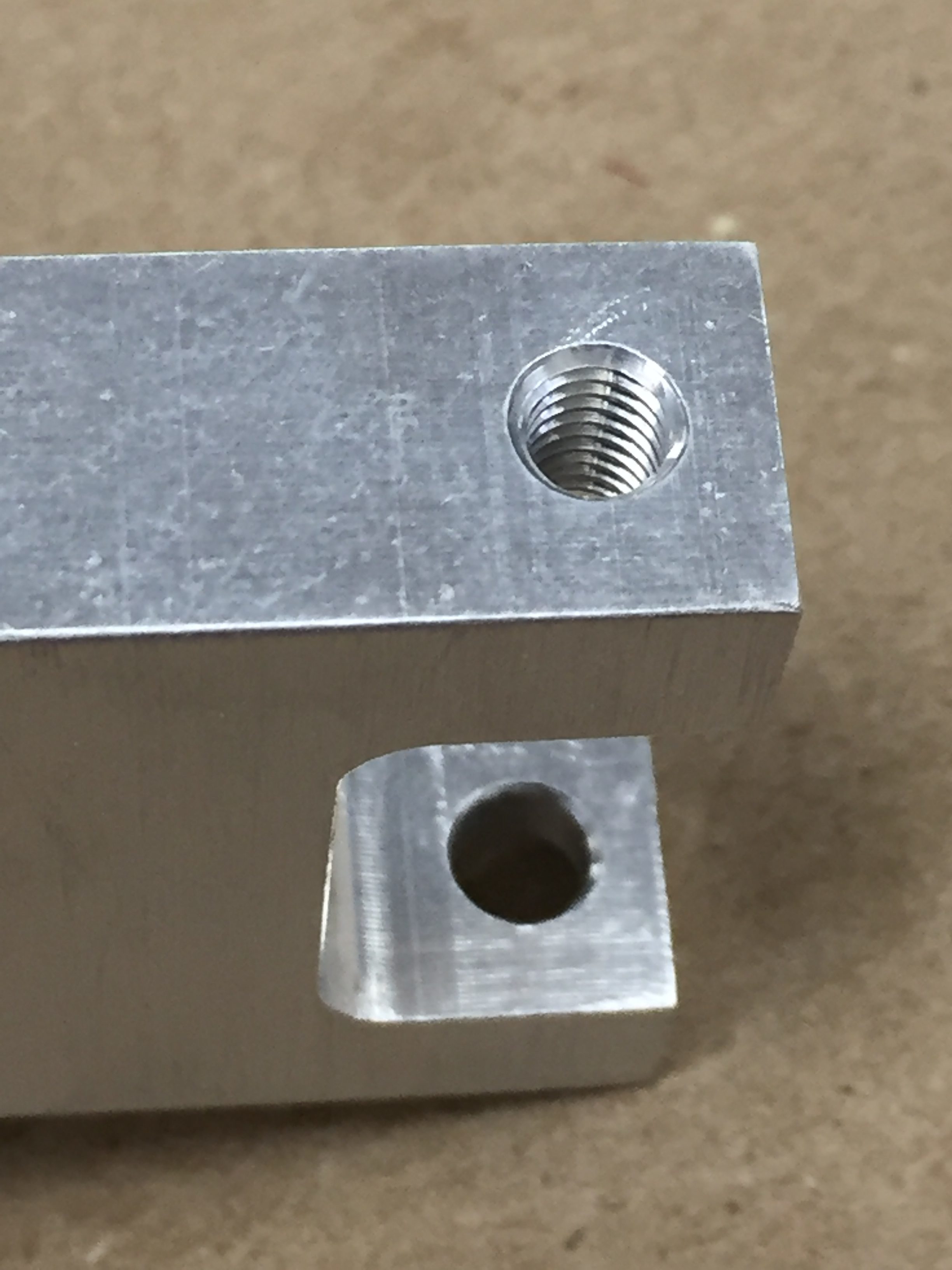

Tapping and Inserts
At Xometry we use taps and dies to cut or form threads into parts for printed metals and SLS nylon. And for inserts, we drill holes to specified sizes and then insert press-fit brass inserts.
For more information on tapped holes and inserts,check out our blog post here.

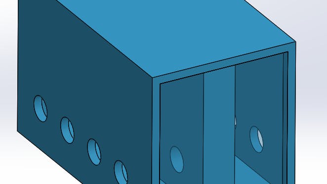

Cavity with relief holes
Cavities with relief holes

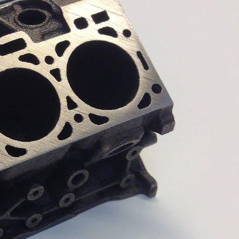

Pockets and Cavities
Parts with confined cavities or pockets make it impossible to remove material during post-processing on SLS and Metal Binder Jetting.
For SLS make sure to design relief holes to allow un-sintered material to exit the part when completed. Xometry recommends 2 or more relief holes 0.500” (12.7 mm) in diameter if possible. Building these holes within line-of-site allows for much more successful cleaning.
And for Metal Binder Jetting, the number of exit holes depends on the height of bosses and size of enclosures. Xometry recommends an exit hole at least 0.1” (2.54mm) in diameter and every 0.5” (12mm) to guarantee sufficient cleaning.

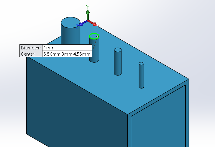

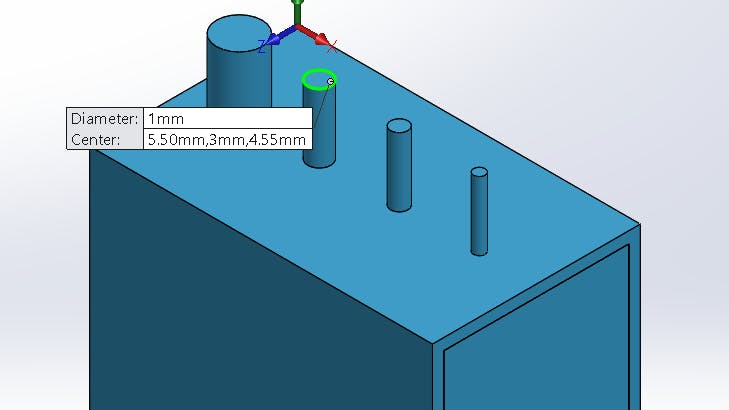

Pin diameter
Pins with an explaination diameters
SLS Pins
The main difficulty when designing pins for SLS is the risk of small pins breaking off during post-processing. The taller the pin, the greater the risk of breaking; increasing its diameter will give a tall pin more strength. Alternatively, part performance can be improved by created a hole where a pin would be and inserting a separate metal pin during post-processing.
