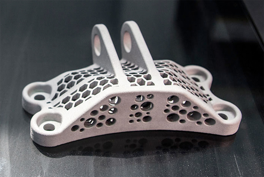

What is the complexity paradox? Well, in traditional subtractive manufacturing, the more complex your part is, the more expensive. That’s because you’re starting with a solid block of material and cutting away from it, and the more you have to cut away from it (i.e., the more complex it is), the more work it is for the machine and the higher the price. So a solid block with a hole in it is a lot easier to manufacture than a solid block that has features like pocketing and ribs for removing weight, since each of those pockets needs to be cut out from the material. Because the price for 3D printing only increases with the amount of material being used, those pockets represent less material that needs to be printed, reducing the price of the part. Added complexity can actually lower your costs, which is why 3D printing can serve as a wonderful alternative for complex pieces.
There’s a common mistake I see companies make when they decide to dip their toes into the world of 3D printing. This mistake is typically made by larger organizations that have heard 3D printing can reduce costs for their low-volume parts, so they put together a team to investigate additive manufacturing and assess the price differential. The problem is that they come in with a design that has absolutely no modifications from the CNC version of the part. In other words, rather than designing a part specifically for additive manufacturing, they’re using the exact same CAD file they’ve used in the past. The original part was often designed for as little subtraction as possible, which drove down the cost of CNC machining but will drive up the cost for 3D printing. Remember: the more material that’s used in 3D printing, the more expensive the part is and the longer it takes to build.
A DMLS part
Understanding the Complexity Paradox can help you design better and save money on your 3D Printed parts!
What these companies should be doing is modifying their designs to the strengths of the 3D printing process being investigated. This will not only allow you to take advantage of the complexity paradox, but the part will be much lighter, which in many cases improves the performance of an overall product.
