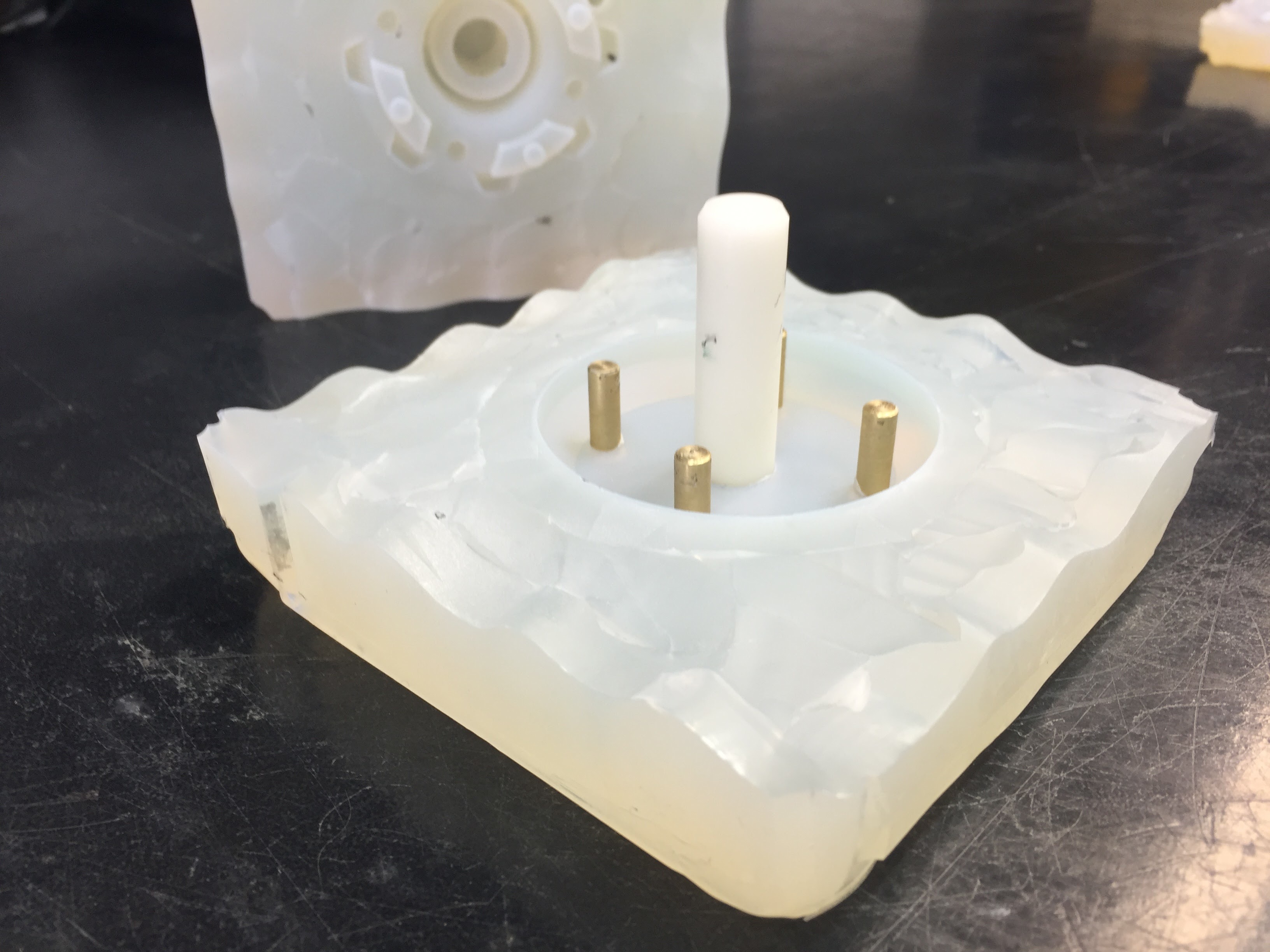

Urethane casting is a two-part process. First, a 3D printed “master pattern” is created to serve as a template for a silicone mold. Once created, the mold is then used to cast urethane parts.

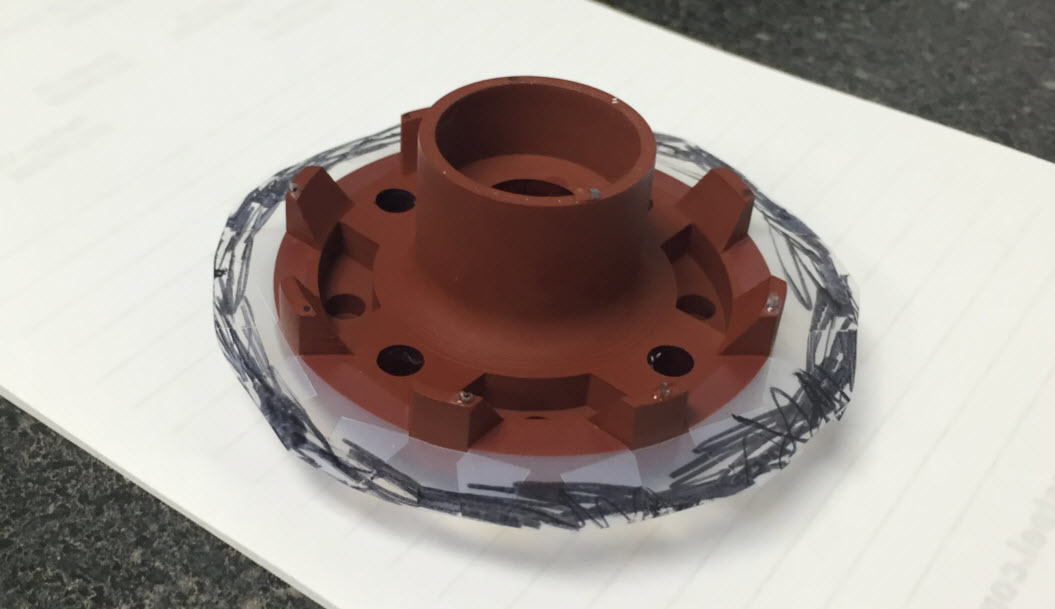

Polyurethane part
Polyurethane part
