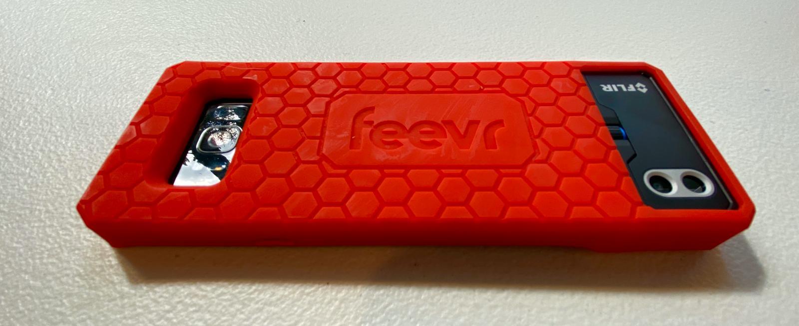

A compression-molded rubber case for Feevr device
Pictured: A compression-molded rubber case secures a thermal camera and smartphone to the Feevr device
A recent example is the rubber housing for the Feevr contactless thermal imaging device. This required several undercuts and an uneven wall thickness, which made it an ideal candidate for compression molding. An added advantage of compression molding this part was that the final product did not retain any gating marks and knit lines typical of injection molding, which can sometimes change the part’s cosmetics.
