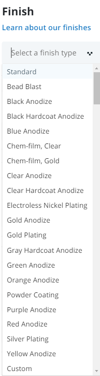

Xometry offers over 25 finish options for parts machined through its network in the Xometry Instant Quoting EngineSM. These finishes and more are also offered through Xometry Finishing Services for parts that have already been machined through other suppliers. Our latest X-tiles video series answers various questions our customers often ask about CNC Machined Metal Finishes.

The first video on our list briefly highlights different surface finishes for aluminum CNC machined parts. In this case, a 1.5” X-tile was machined out of 6061-T6 aluminum. While the standard finish is left as-machined, we compare other tiles which show chromate conversion (chem film), anodizing (Type II and Type III), and nickel plating.
