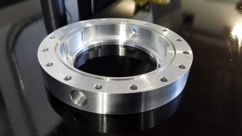

cnc machined aluminum 6061
A rocket engine injector radial passage CNC machined from aluminum 6061 for engineers at UC Irvine. Source: https://www.xometry.com/blog/case-study-xometry-helps-uc-irvine-rocket-team-prepare-for-spaceshot
