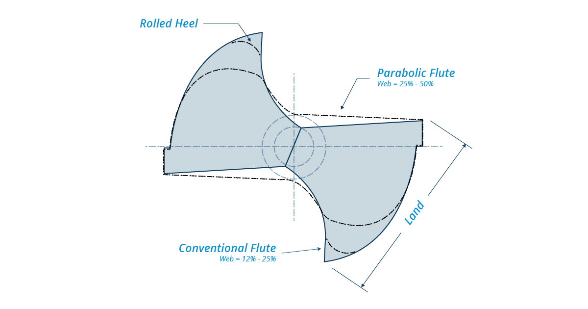

Flute Styles:
Your tool type (read: speed and feed), material type, operation type, and the drilling depth you’re after are the most important factors for choosing a flute style.
Most twist drills have flutes that expel the chips at an unspecified angle and are pretty suitable for most applications. When you need something a bit (puns, amirite?) more specific, there are a range of other specialty twist drills. For example, drill bits designated as “High Helix,” “Fast Spiral,” “Low Helix,” and “Slow Spiral” are all designed for specific applications requiring higher or lower spindle speeds or feed rates. These guys are pretty much only good at their specific jobs, though, so don’t mess around.
