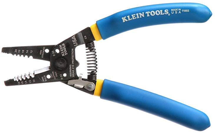

Wire Stripper
This article was brought to you by your local wire stripper.
