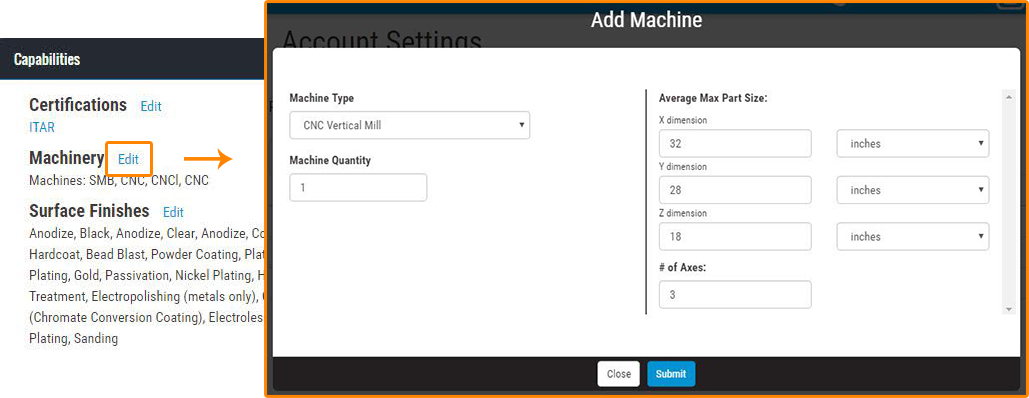

Setting Up Your Account
Back to top
  1. Add your shop’s capabilities, including machines, finishing capabilities, and certifications. We will use that information to match jobs that are best suited to your shop.
  2. Sign our non-disclosure agreement (NDA) due to the highly sensitive nature of our customers’ work.
  3. Fill out a short demographic on-boarding questionnaire about your shop.
  4. Once you have filled out the required information, we will reach out to you with instructions for completing the first job with Xometry, which is the final step in the on-boarding process.
Xometry Partner Portal - Add Machine

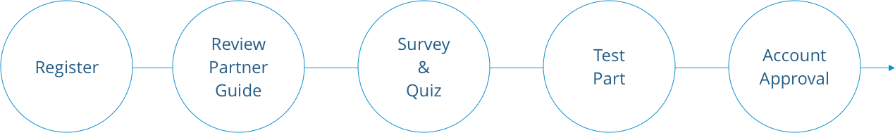

Onboarding Process
Back to top
partner onboarding process
  1. Register: Once you complete your shop profile, the information will be reviewed by our Partner team to determine whether your capabilities are a match for our needs.
  2. Partner Guide: Review this Partner Guide to understand our processes from taking a job through production, inspection, shipment, and payment.
  3. Survey and quiz: You will be required to complete a short survey and take the associated Partner Guide quiz.
  4. Test part: Before receiving full approval into the Xometry Partner Network, all new partners are required to complete one trial job. Chosen parts will be sent to you via email upon completion of the on-boarding questionnaire. Parts will be shipped back to Xometry for full inspection and acceptance. Once accepted, you will be able to submit for reimbursement for the cost.
  5. Account approval: Once the test part is accepted, the following actions will take place:
  • You will complete an onboarding call with a member from our Partner Development team
  • You will receive a link to invoicing and payment system.
  • Your status is updated to approved.
  • You are sent a confirmation email with detailed information.
  • You will be permitted access to the live job board.

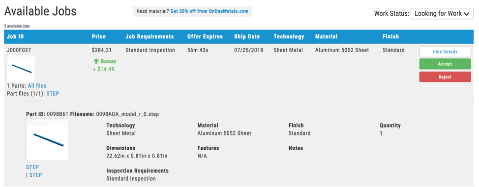

1. Navigating the Job Board
Back to top
Xometry will send an email notification to the account holder every time we post a job to your account (these notifications can be managed in your account settings). If you follow the link in the email, it will take you to our job board where you will be able to review the parts and their requirements. Xometry provides all of the job details (price, lead time, material, etc.) for you to view. You can also access the job board by visiting work.xometry.com and logging in. The 3D CAD files, drawings (if available), materials, and part quantities are all in one place.
Your job board has a selection of filters you can use to narrow down the jobs shown. Current filters include price, technology, material, finish, and job size. This video walks you through the search filters available on your Job Board and how best to make use of them to find the right jobs for your shop.
Over certain jobs you may see an orange "Recommended Job" icon. Our job recommendation system uses a machine learning algorithm that compares each new job on your board to past work that you've completed. Over time, the algorithm learns what types of jobs you tend to accept. The more work you complete, the more it learns about you. In making these recommendations, the system considers materials, quantity, and part complexity along with hundreds of geometric features that we extract from the CAD files. Jobs that are most similar to your past work will receive the highest scores.
If the price, lead time, and job requirements for a job are a fit, simply accept the job and a PO will be generated automatically. Some jobs will be listed at the top of the job board, including Auction Offers, Exclusive Offers, Updated Price offers, or Repeat Work offers.
Xometry partner job portal

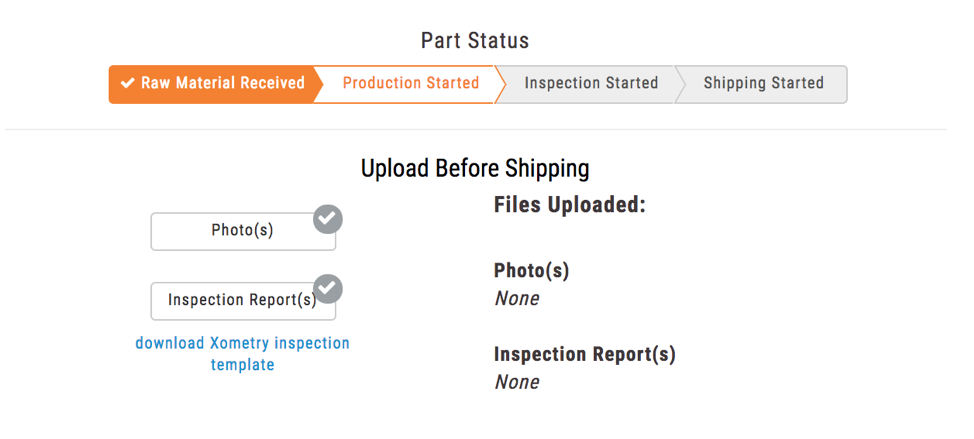

2. Accepted Jobs & Manufacture of Parts
Once a job has been accepted, jobs can be managed using Xometry’s web application. You can easily provide status updates, upload inspection reports, photos, CofCs, MTRs, and finishing certs when required. You can also communicate directly with Xometry if you have questions about dimensions or tolerances. For CNC parts the standard finish is “as Milled”. Bead blasting is not permitted unless specified on the Purchase Order. Do not Bead Blast parts prior to Finishing unless specified on the Purchase Order.
For CNC and Sheet Metal parts, welding repairs are not permitted without permission from Xometry. Parts that are submitted that have been welded and repaired without prior approval will be rejected in Inspection. Partners who ship unauthorized weld repaired parts to customers will be subject to penalties.
Upon acceptance of the job, you are agreeing to manufacture of parts in your own facility. These parts cannot be made in alternative locations without explicit consent from Xometry. The only types of work that can be subcontracted without advance consent from Xometry are Grinding, Heat Treating, EDM, Welding and Finishing, and only where the subcontractors can meet the specific requirements of the drawings or specifications. (surface finish, material properties, plating, painting, anodizing, chem-film, welding specs, etc.). Additionally, you are responsible for ensuring all subcontractors comply with the relevant Xometry’s Partner Terms & Conditions.
As a Best Practise, we recommend that when part non-conformances are caught by your internal QC Department, the parts should be sent back to the manufacturing floor for rework. After reworking, parts should have a final check by the QC department before shipping.
Xometry partner job portal accepted jobs

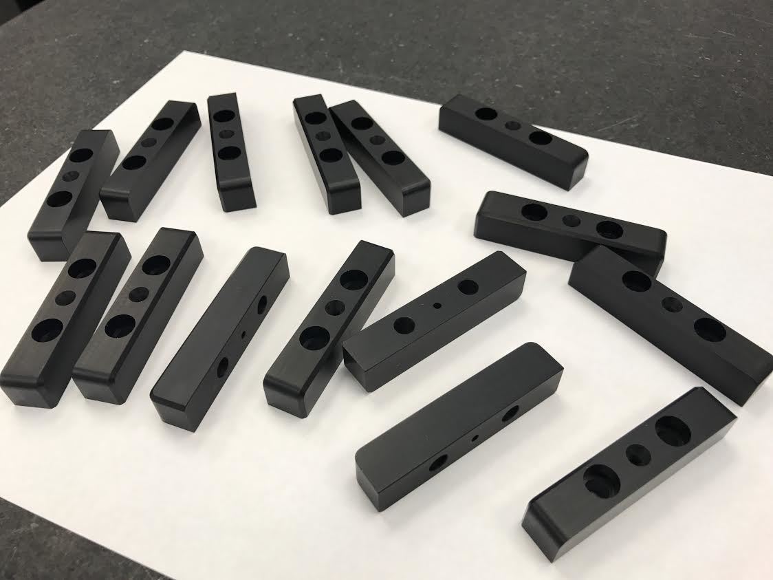

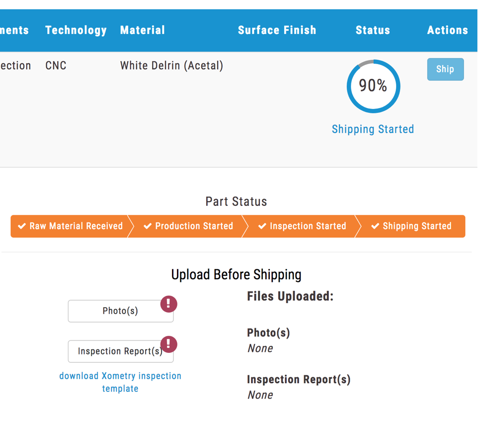

3. Part Photos
Part photos are required to complete the workflow online. This allows us to have clear documentation of a completed job prior to it being shipped to Xometry or directly to the customer, and should only take a few moments of your time. Please make sure the photos are clean and the subject is clearly in view.
Good Part Photo
good part photo
  • Good lighting
  • Parts contrast with background
  • Each part is clearly defined

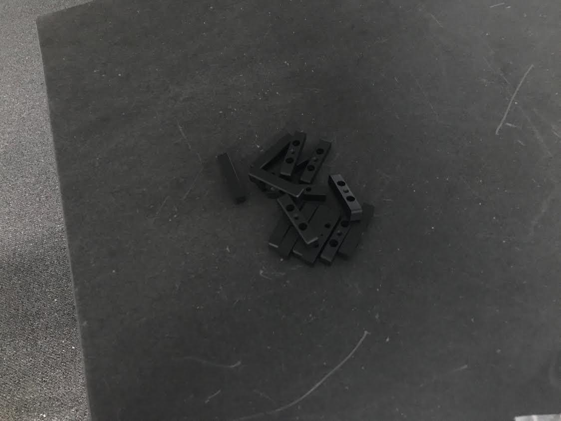

Bad Part Photo
bad part photo
  • Bad lighting
  • Hard to distinguish parts from background
  • Overlapping parts

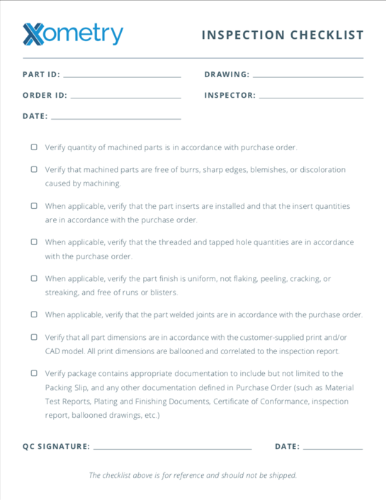

We want our partners to be in the habit of checking their work. As such, we will require you to inspect each job based on the subsequent inspection requirements and complete the Xometry Inspection Report, which can be downloaded from your Xometry Account Profile in the Resources section. The checklist below is for reference and should not be shipped, but should be uploaded to the job board with the other documentation. Learn more about Xometry's Inspection and Quality Standards as well as see how to complete the Inspection Checklist and Report here.
When placing an order with Xometry, the customer must select one of the following options for inspection: Standard Inspection, Formal Inspection, CMM Inspection with Dimensional Report or First Article Inspection Report.
inspection check list

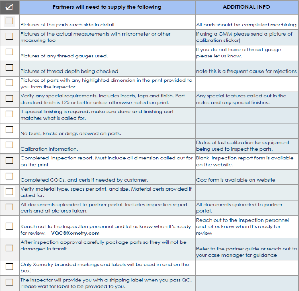

2. Direct Ship and Remote Inspections
All new partners will ship work directly to Xometry for additional inspection. There will be cases where partners will be asked to do a remote inspection from time to time. A remote inspection is an inspection done through a complete inspection report as well as photos of certain dimensions supplied by our Visual Quality Control (VQC) team. Below you will see a copy of our exact requirements and guidelines for a photo inspection. This request will vary, and partners are expected to complete the remote inspection. Partners that achieve an excellent track record of producing high-quality, on-time parts will be approved to ship directly to our customers as a direct ship partner, with no inspection from us needed.
photo inspection list

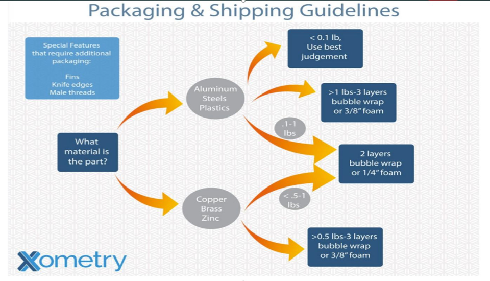

Packaging Policy
Please ensure that all parts have been deburred and are free of dirt and oil prior to shipping. To ensure all parts are received by the customer unharmed and free of dings and scratches, we recommend the following packaging procedures:
1. Selecting the Right Box
Single Walled Boxes
- Single walled boxes should not be used for anything weighing over 20 pounds
- This type of box is acceptable for additive parts (SLS, FDM, and Poly Jet)
Double Walled Boxes
- Double walled boxes are the preferred box for CNC and sheet metal orders
- Boxes that are over 24” should be double walled
- If at all possible do not pack parts weighing over 50 pound into a single double walled box. If more labels are needed contact support@xometry.com and more will be provided to you.
Note: DO NOT RE-USE BOXES, USE BRANDED BOXES, OR INCLUDE ANY BRANDED ITEMS IN THE BOX. (Examples: Amazon boxes. boxes with logos or other company names, etc.)
Key Take Aways from Flow Chart
- The most important factor that determines how something should be packed is what material the part is made out of. Soft metals (copper, brass, and zinc) should be packed with more care. A minimum of 2 layers of bubble wrap (3/16” standard small bubble) is needed no matter the size of the part.
- “Use Best Judgement” but minimally these small parts need to be put in individual poly bags. Zip Lock sandwich bags are not an acceptable substitute for poly bags.
2. Tips and Tricks to Packaging
- Use Cardboard separators between heavy parts. This will prevent them from hitting each other during shipment.
- Keep a minimum of 1 inch between the part and box.
- If you can feel a sharp edge or corner of the part through the bubble wrap or foam, then add more packaging material.
- Conduct a “Shake Test” on the box. If you can hear parts hit each other, or parts moving in the box, then it needs to be packed tighter. This can be achieved by adding more filler into the box, or adding more bubble wrap to the parts.
- Thin parts (less than ⅛”) should be sandwiched between 2 pieces of cardboard.
Large bubble wrap (½ inch or bigger) is not preferred for large parts. The voids between the bubbles will cause part to part contact, which will ultimately result in damage.

  • Xometry provides a FedEx 2-Day or Ground delivery labels for all jobs unless otherwise noted. To utilize the Xometry shipping account, you must generate a shipping label through the online portal. To generate a shipping label, click the Ship button on the Current Jobs page to go to the Shipping page. Note that the Ship button will only become active on the Job Details page when all stages of the job status workflow have been completed.
  • Once on the Shipping page, click the Print Packing Slip button to generate a packing list. From there you will be prompted to generate a Shipping Label.
  • If you have multiple packages for the same order, please request custom shipping labels on the Shipping page. When Xometry support personnel provide custom labels, you will be able to download them and complete the job from the Shipping page. If you do not generate a shipping label through the online portal, you will not be reimbursed for shipping costs incurred.
  • Labels are to be requested and/or printed only on the same day as the job will ship. Jobs should be updated to shipping complete ONLY if the package will receive an origin scan that same day.
  • By requesting/printing a label or by selecting “complete shipping” you are committing that it will be scanned and in transit on that day.
  • To avoid risk of mislabelling the packages, please print labels as close to time of packaging as practical and confirm that the correct label is affixed to the box.
Xometry will not be responsible for organizing FedEx pick-ups. Partners are expected to organize the truck’s arrival and handle associated fees. To set up a pick-up, please make the label via our site then log into FedEx.com or call 1-800-463-3339 (1-800-GOFEDEX).
  • Partners with a FedEx Account: Can set pick-up via phone or online
  • Partners without a FedEx Account: Can set up a pick-up via the phone. Ask representative to create a Site Profile for future pick-ups.
All shipments must receive an origin scan (e.g. they cannot be deposited in a drop box). We do not consider an order complete, and you will be solely responsible for all losses, if you do not receive an origin scan.
Xometry partner job details ship button

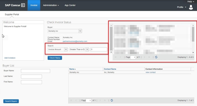

  • How do I view the status of my invoice? To check the status of an invoice, use the Search function towards the middle of the page on your Concur Dashboard. Search for invoices with amounts greater than zero to populate results on the right-hand side.

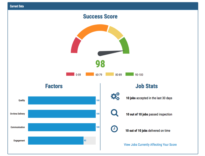

Partner Success Score
Back to top
Your Partner Success Score is a measure of factors that are critical to delivering customer satisfaction that ensures your success on the Xometry network. We track a number of metrics to measure the quality of your parts, the timeliness of parts shipped, engagement with your Partner Portal and job board, as well as communications about active jobs.
Xometry partner success score portal
The specifics of our scoring system are proprietary. However, please note that being late on deliveries or shipping parts with specification defects will affect your score severely. At a minimum, we use the last 30 days of data to calculate your score. We’ll go back as far as needed to get to a sample size of 10 jobs, but won’t use any data over 6 months old. This means that being a long-time partner, taking high-value jobs, and taking many jobs can all help your score. And being new to the platform or if you have limited capacity will not count against you either. You can improve your score with every new job you complete.
Scores will be recalculated daily and available to you on the Partner Portal. Your Partner Success Score determines the number and type of jobs you see as well as the bonuses you get as part of the Partner Success Bonus program. Please note, the Xometry Partner Bonus Program is currently only available to partners who do CNC, sheet metal, or 3D printing work.
