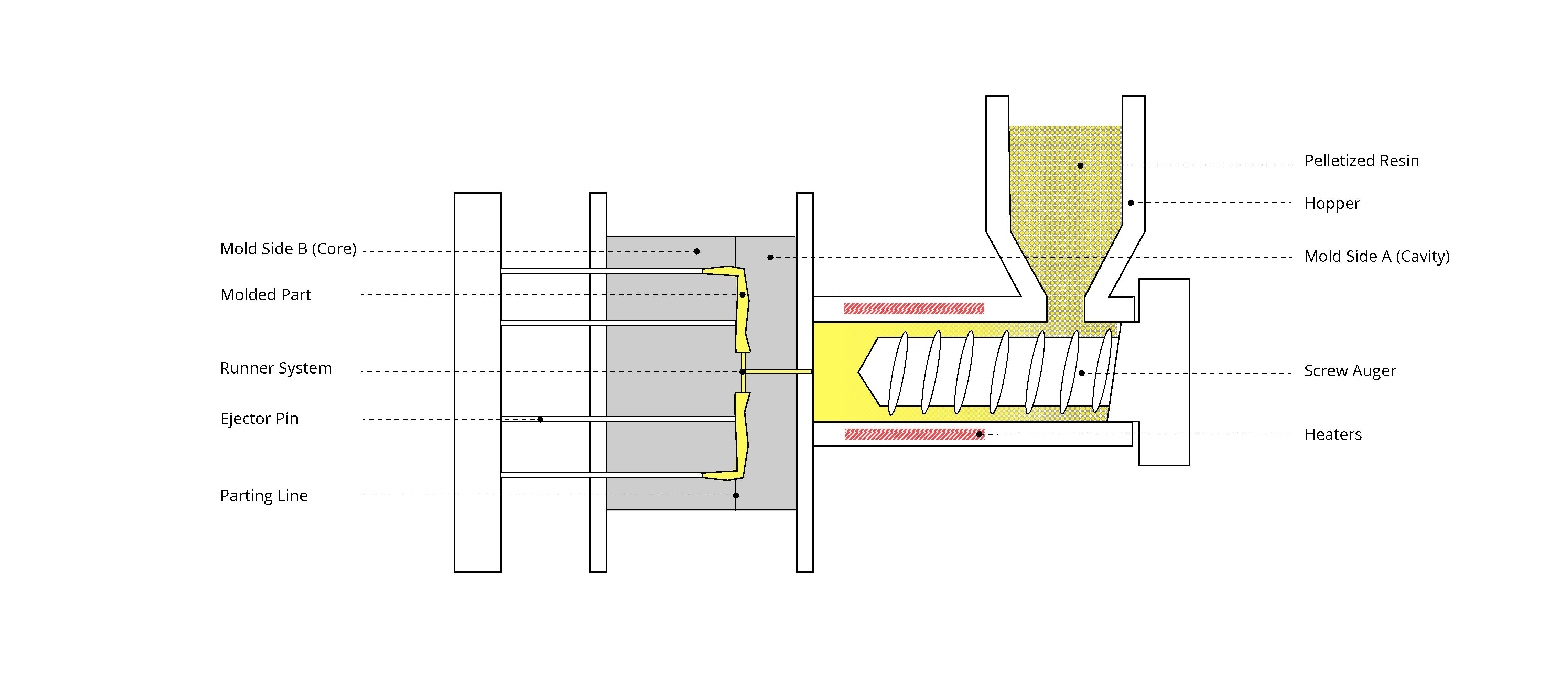

Plastic injection molding is a method used to produce plastic parts at an extremely high rate. As such, it should be no surprise that injection molding is the go-to technology for most plastic consumer products. The plastic injection molding process consists primarily of the following components:
1. Injection Unit
Plastic pellets are fed into the injection unit using a hopper. These pellets fall into a heated barrel which melts the plastic. A screw conveyor moves the plastic through the barrel and also serves to mix it for even heating. In addition to this, modern screws have tapered shapes that force pellets against the side of the barrel to add additional frictional heat. A significant proportion of the heating is achieved through this friction effect and heater bands supply the remainder. Once a predetermined amount of plastic has been melted in front of the screw, it is pushed forward and forced into the mold.
2. Mold

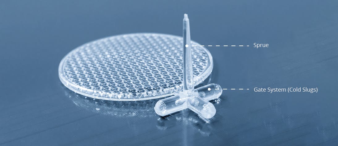

The mold is effectively a negative of the product and typically consists of 2 or more separate parts. The plastic is injected into the mold’s open cavity, also known as the cavity image, where it solidifies and takes on the shape of the part. Air is allowed to escape through vents machined into the mold. This solidification process can be accelerated using strategically placed cooling channels to cool the mold quicker. The part is then ejected from the mold using ejector pins. The location of these ejector pins can be seen on injection-molded parts as circular indentations. They are often placed on a less visible side of the plastic part. Depending on the complexity of the part being manufactured, molds can be extremely expensive.
3. Clamp
Plastic injection molding is done at extremely high pressures. As such, when plastic is forced in, the pressure will try to separate the two halves of the mold. To stop this from happening, the halves of the mold must be clamped tightly together. The clamping pressure is typically supplied by a hydraulic ram.

Molds consist of at least two sections. They also contain cooling channels that are close enough to the surface of the mold to be able to quickly cool the part. In addition to cooling channels, air release vents need to be machined on the face of the mold to allow air to escape during the injection process. These vents must be extremely narrow so as to allow air to escape but no plastic.
