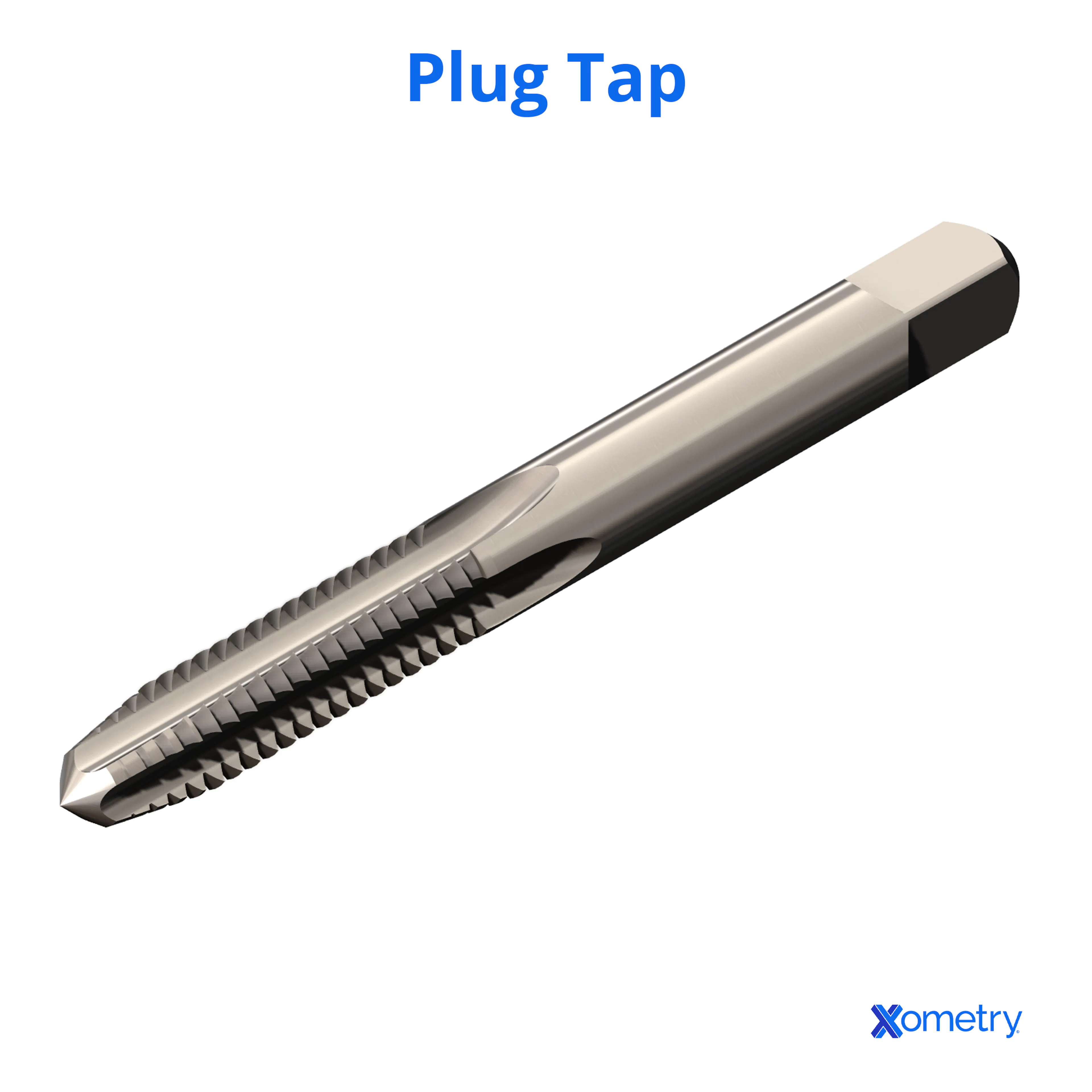

Plug Tap
A plug tap is a type of hand tap, distinguished from bottoming and taper taps by the length of its cutting chamfer. A plug tap has a five-thread chamfer and slowly removes material in the thread beginning with the smaller diameter of the thread. Plug taps are most commonly used for through holes and where there is enough room at the bottom of a blind hole. One of the main advantages of plug taps is that they are easy to use through holes, but provide a more complete set of threads in comparison to taper taps. However, a plug tap is not as well suited to blind holes as taper taps. Figure 2 shows a plug tap:

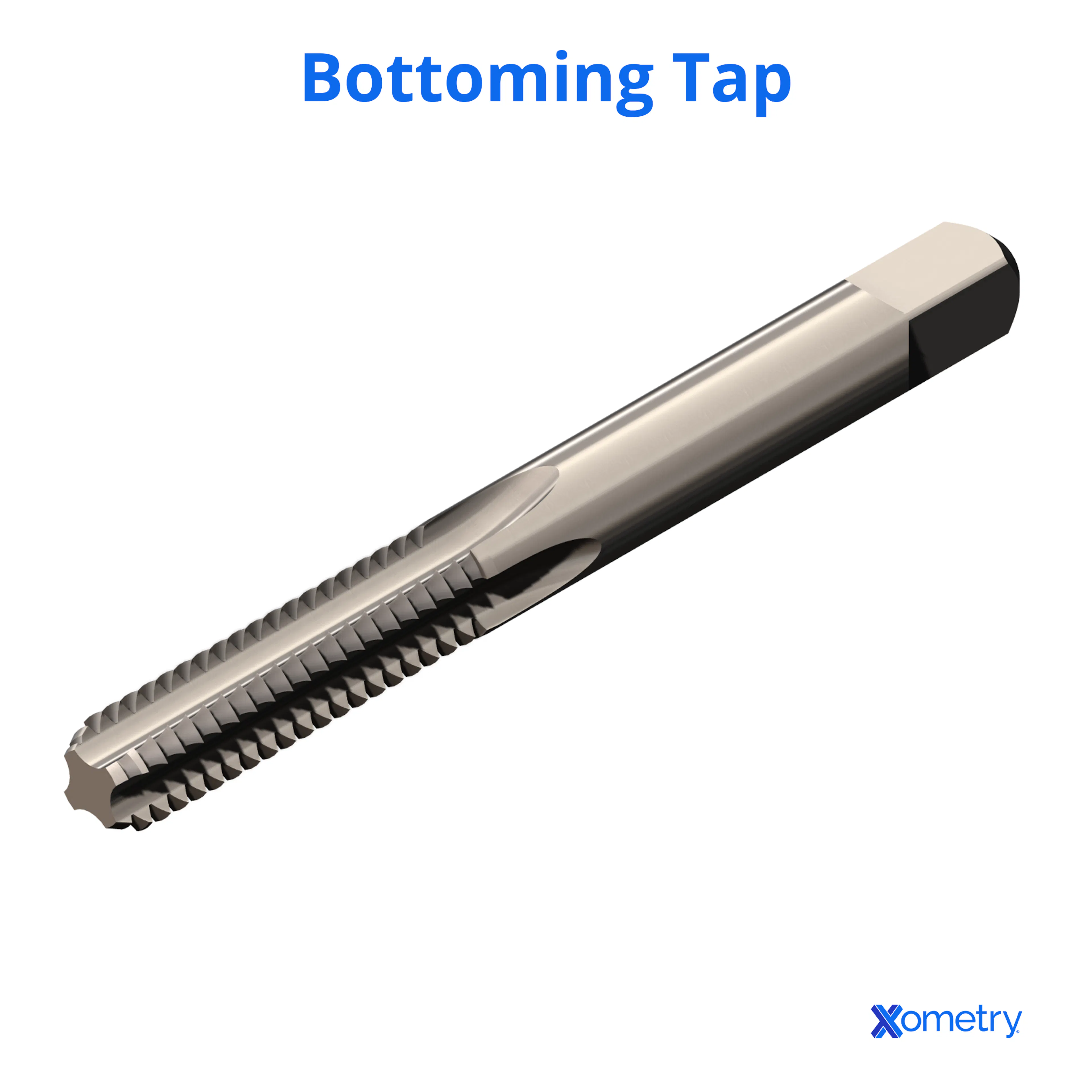

Bottoming Tap
A bottoming tap is a type of hand tap used to cut threads. It is important to note that the bottoming tap has the smallest thread chamfer of 1.5 and is used to complete the end portion of a blind hole. One of the main advantages is that it can get right to the bottom of a blind hole to complete the threading, unlike a plug or taper tap. However, it is not well suited to removing the majority of material from the hole. Figure 3 shows a bottoming tap:

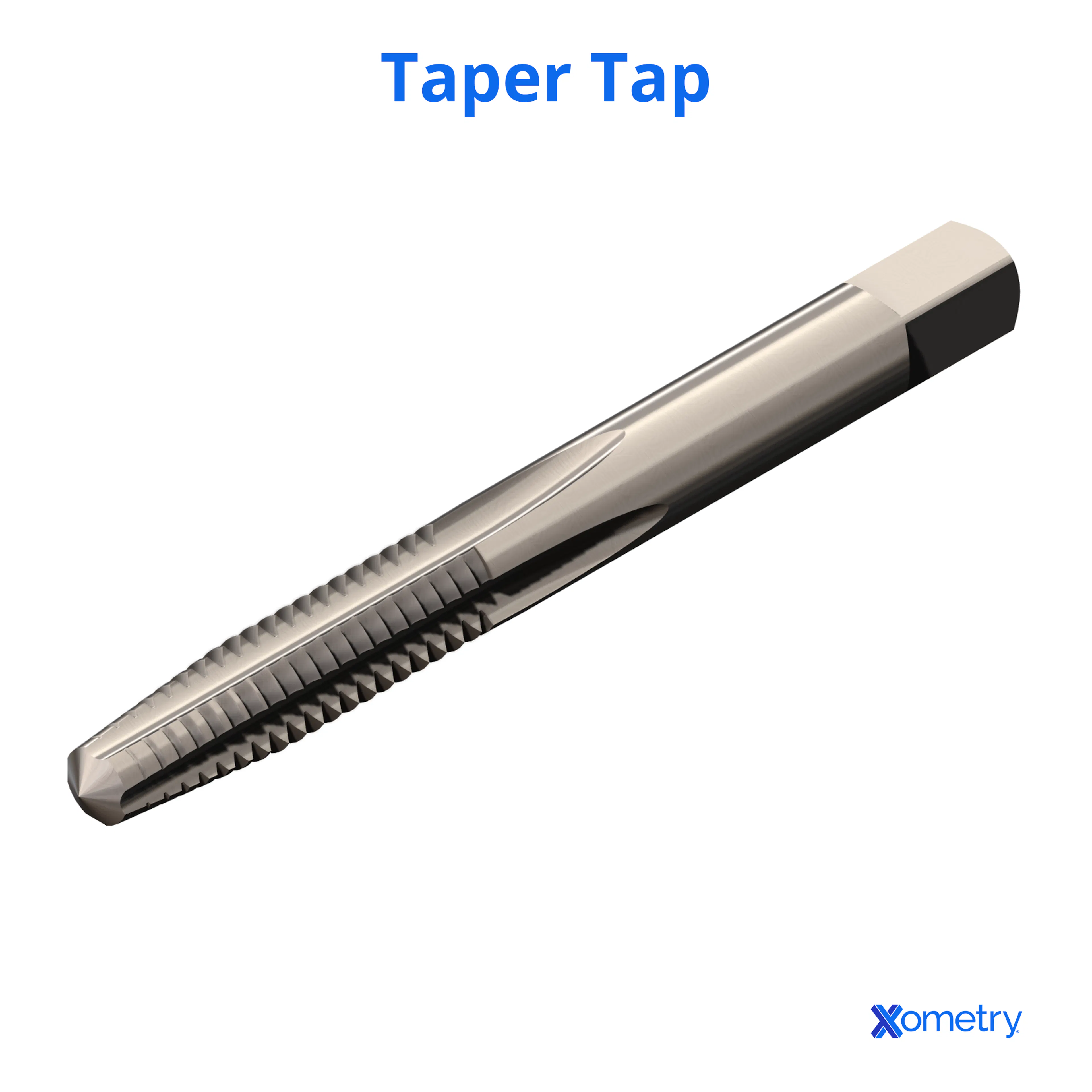

Taper Tap
A taper tap is a form of hand tap used to cut threads into a piece of material. Taper taps have a nine-thread chamfer and have the smallest diameter of all hand taps. Taper taps are usually used as starter taps in blind holes or through-hole applications. One of the advantages of taper taps is that they can remove the majority of material initially, however, they are not particularly suited to completing the bottom of blind holes as they tend to leave incomplete threads. Figure 4 shows a taper tap:

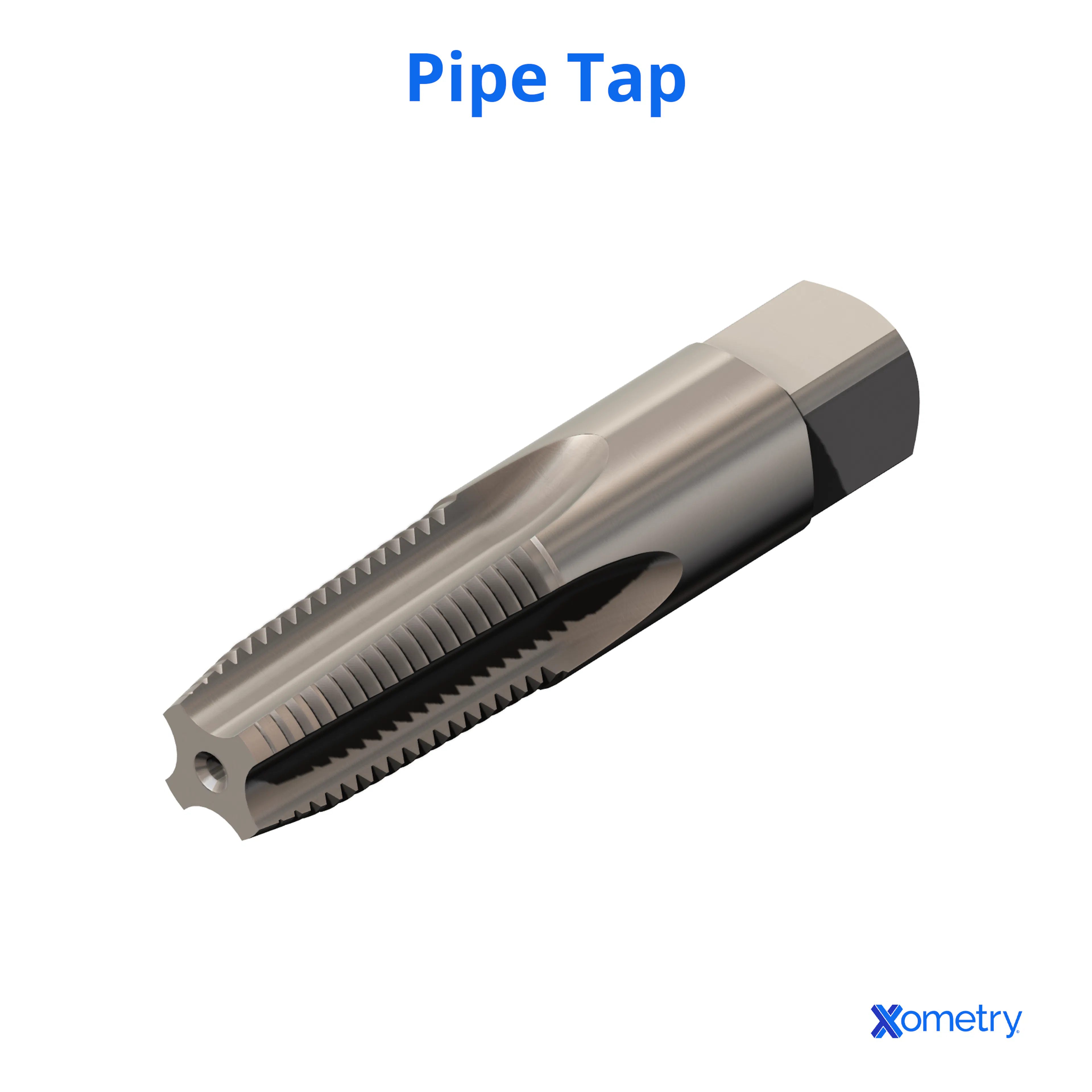

2. Pipe Tap
Pipe taps are a tool used to carve internal thread into parts that will be fitted to form a pressure-tight joint. Pipe taps come in different varieties, with some designed for hydraulic and gas applications, mechanical joints, and hose couplings. Pipe taps are used specifically for threading pipes and must be used more accurately in comparison to other forms of tapping as they are designed and made to mechanically seal a joint for pressure and prevention of leaks. Figure 5 shows a pipe tap:

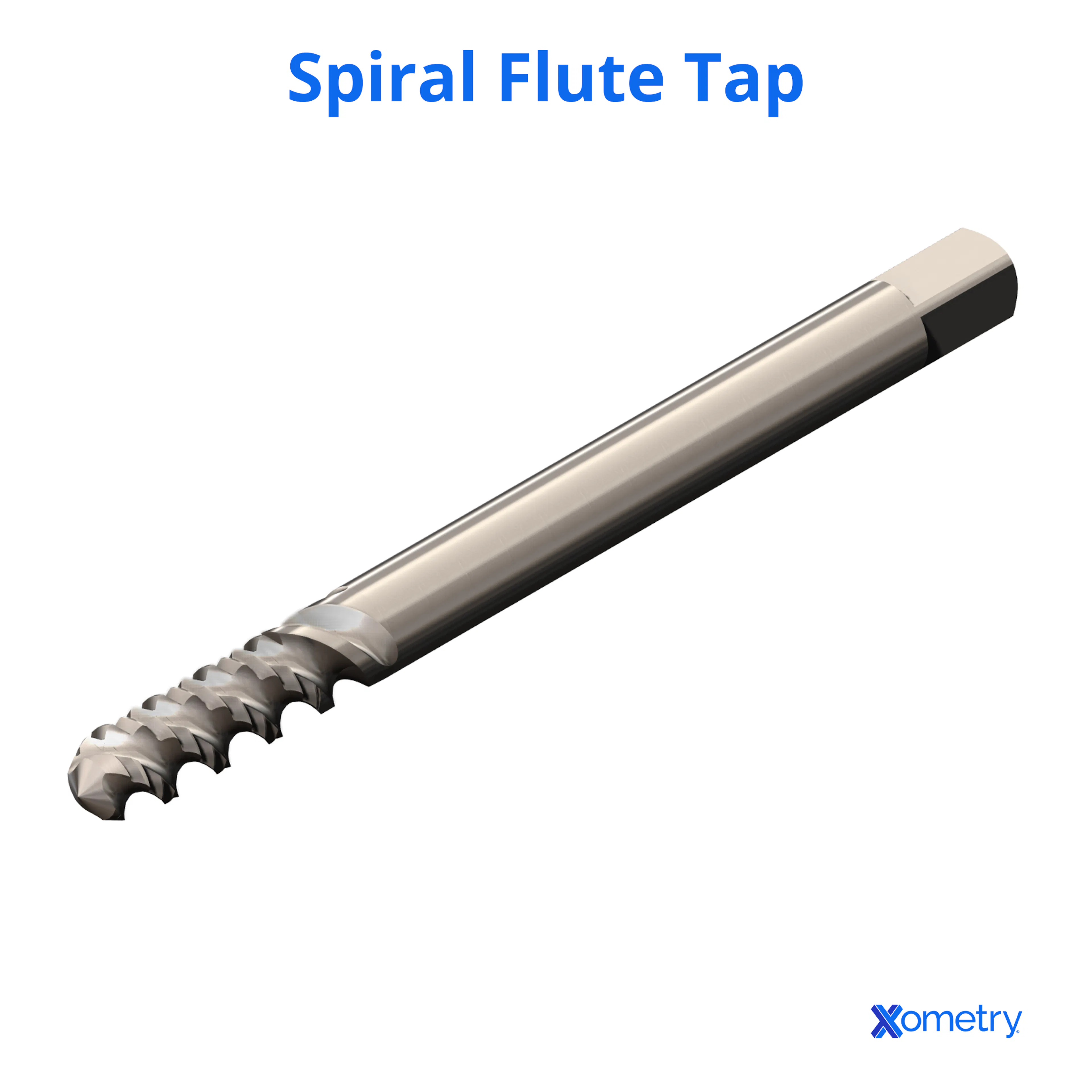

3. Spiral Flute Tap
Spiral flute tap is a form of thread tap used widely across the manufacturing industry. A spiral flute tap has flutes wrapped around the tap’s axis in a helical or spiral formation. Spiral flute taps are commonly used for tapping threads into blind holes and then pulling the chippings out of the hole in the opposite way to the tapping direction. In comparison to hand taps, spiral flute taps do not offer as strong of a cutting edge and have spiral-shaped flutes. Figure 6 shows a spiral flute tap:

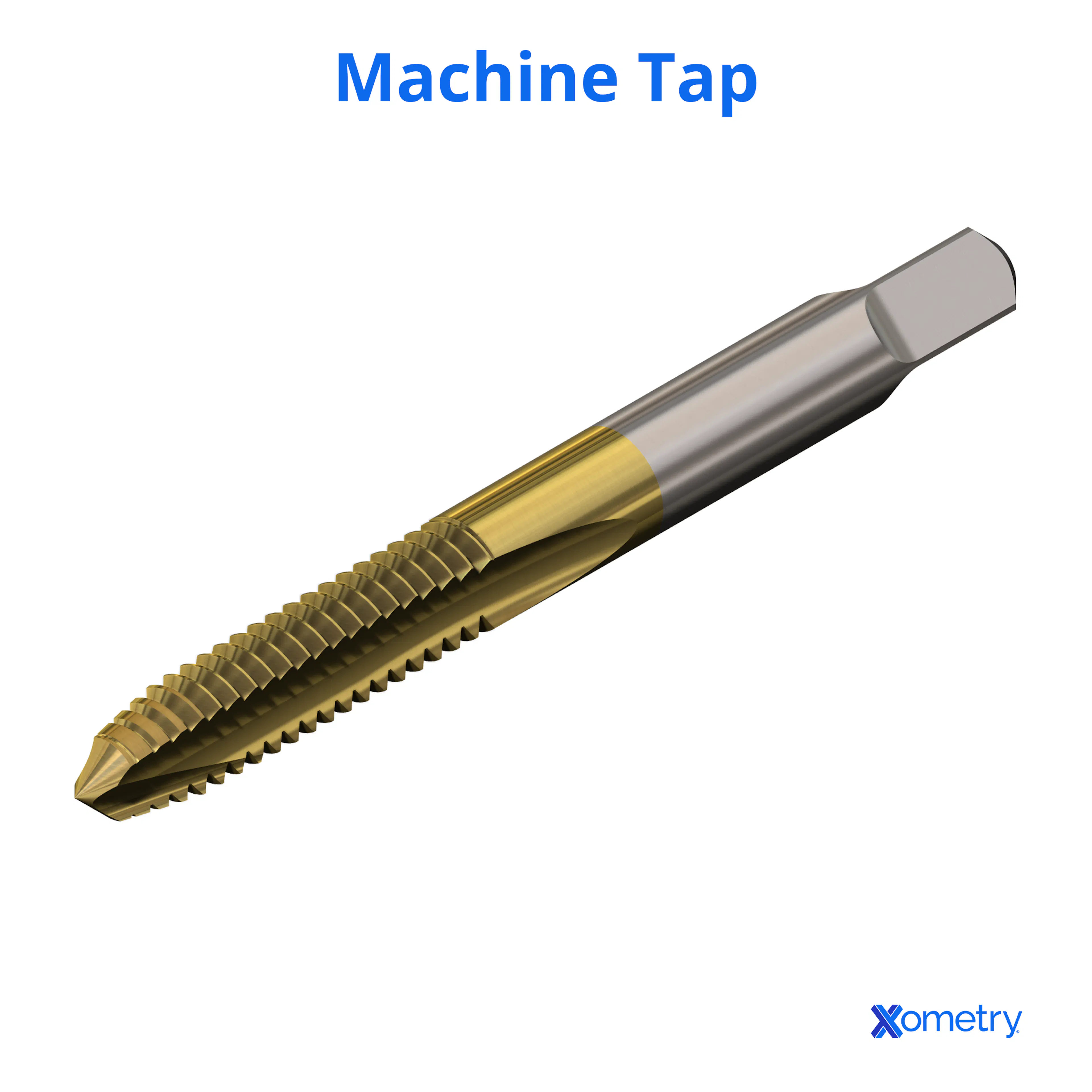

5. Machine Tap
Machine taps are used for threading and have grown in popularity and importance recently in line with the increased use of machinery in production. Threading tools used in these machines are now required to be increasingly wear-resistant and durable. Machine taps are fully automated and used in threading hard materials and are suited to both blind holes and through holes. Machine taps are used for hard materials, unlike spiral flute taps. Figure 8 shows a machine tap:

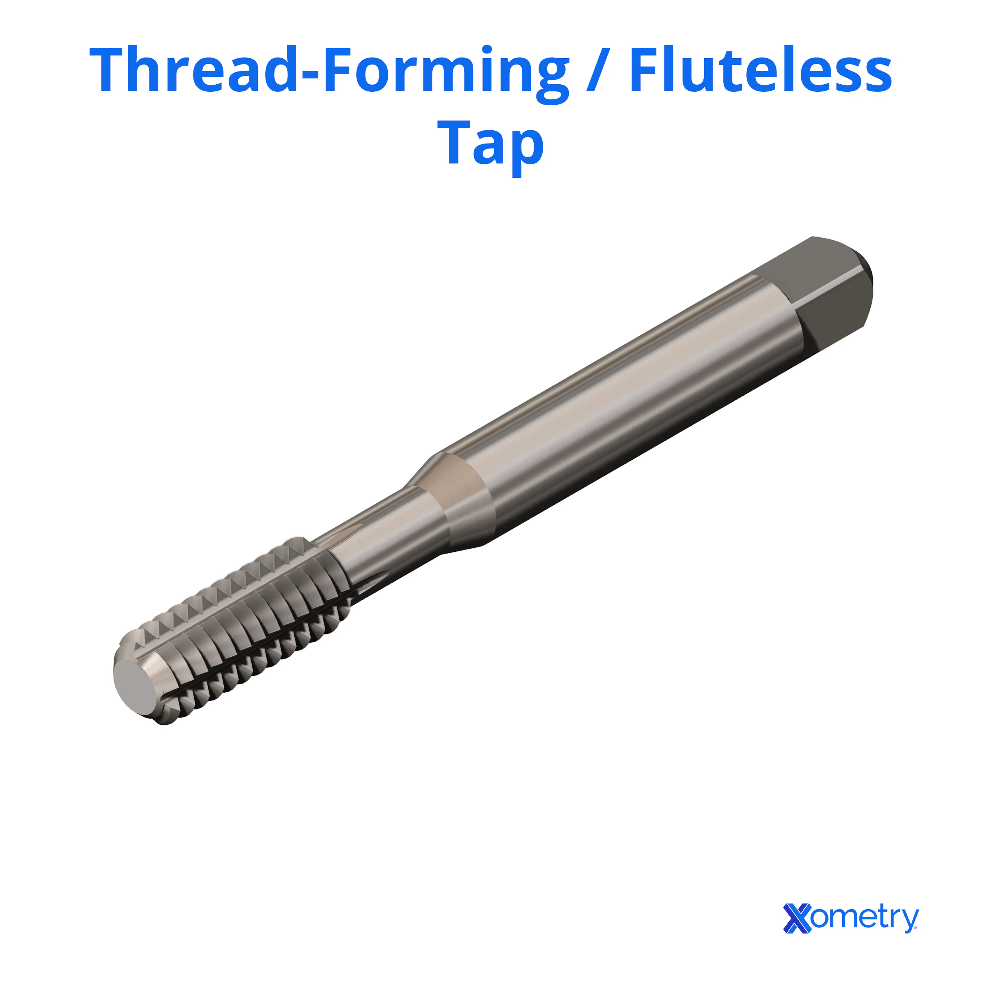

6. Thread-Forming Tap
Thread-forming taps are also known as form taps, roll taps, or fluteless taps, and they create threads by removing the material without producing chips. Thread-forming taps are commonly used on medium alloys and mild steels such as: copper, aluminum, brass, and stainless steel. Unlike other forms of thread taps such as hand taps, the thread-forming tap molds the material to form threads, as opposed to cutting it. Therefore, the material is displaced inside a hole to make space for threads to be formed. Figure 9 shows a thread-forming tap:

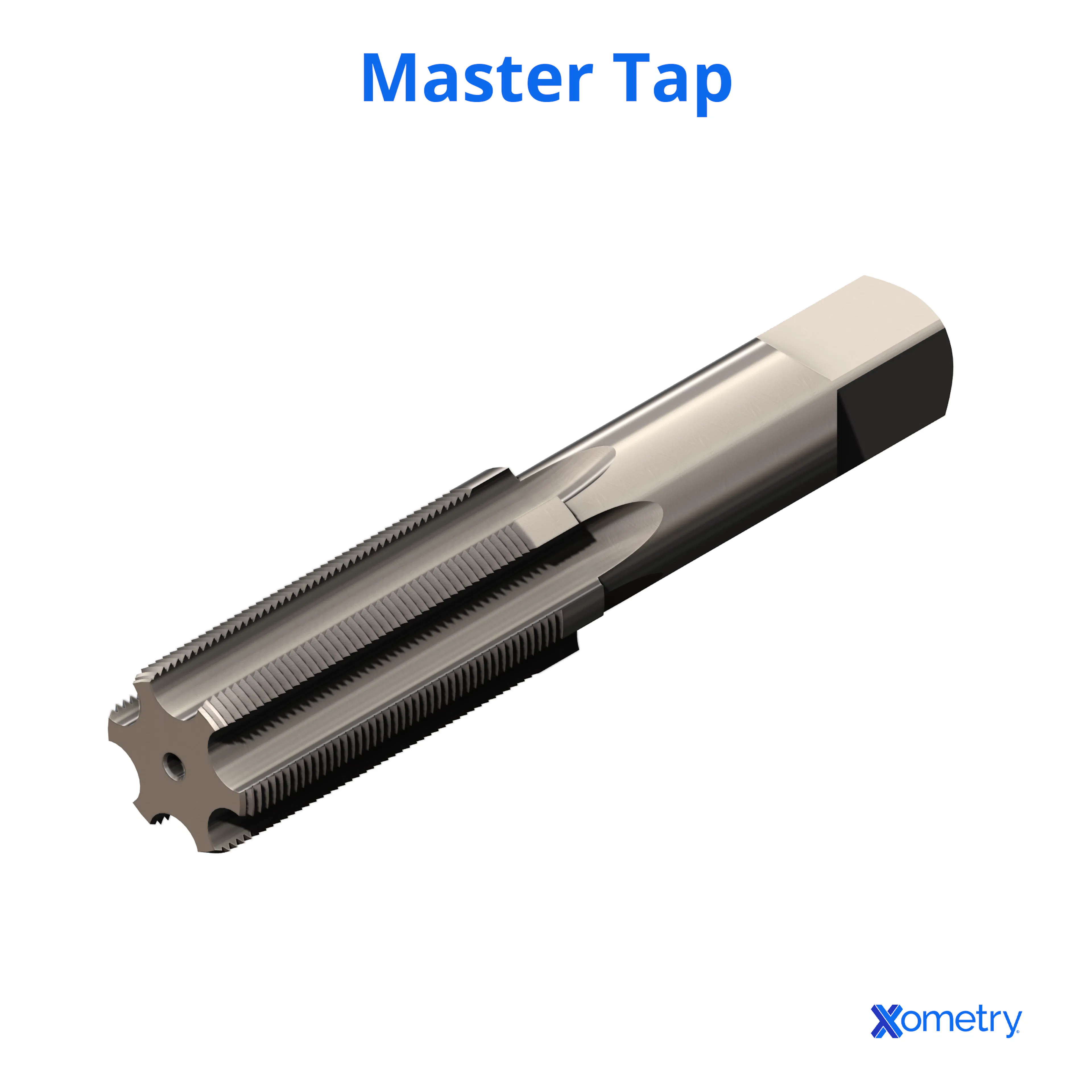

7. Master Tap
A master tap is a variety of threading tap and is widely used across a range of industries. Master taps are known for their universality and diversity and are most commonly used to cut clean threads in strong and hard materials. Master taps are similar to taper taps, however the key difference is in the number of flutes. The master tap has more cutting faces and on average 7 to 10 flutes. Figure 10 shows a master tap:

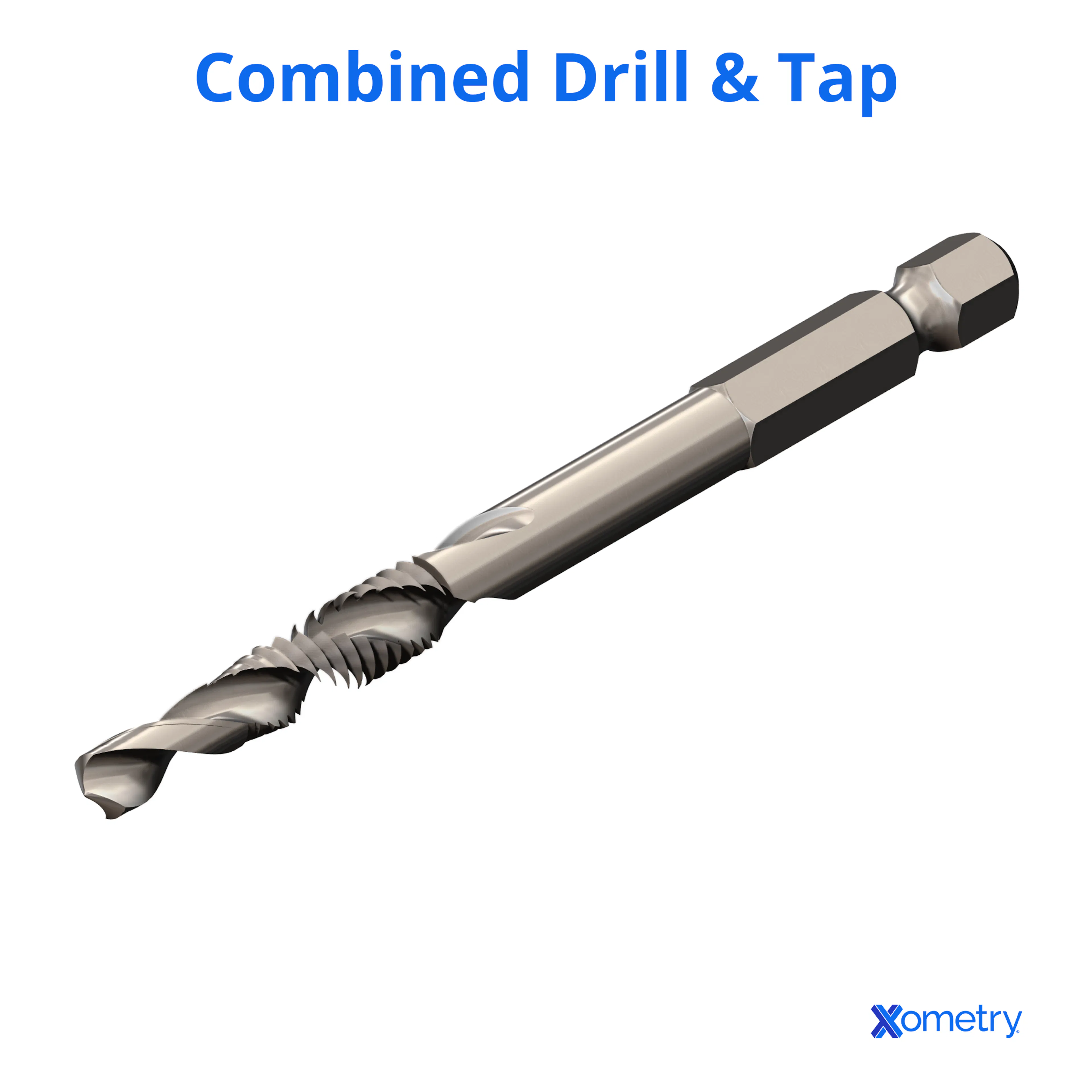

8. Combined Drill and Tap
A combined drill and tap enables the manufacturer to drill the hole and tap threads in one operation, without the need to switch tools, saving both time and money on a production drilling job. It can be used for a variety of materials, including: aluminum, malleable iron, and brass. Similar to a spiral flute, this implement has a helical flute design. Figure 11 shows a combined drill and tap:

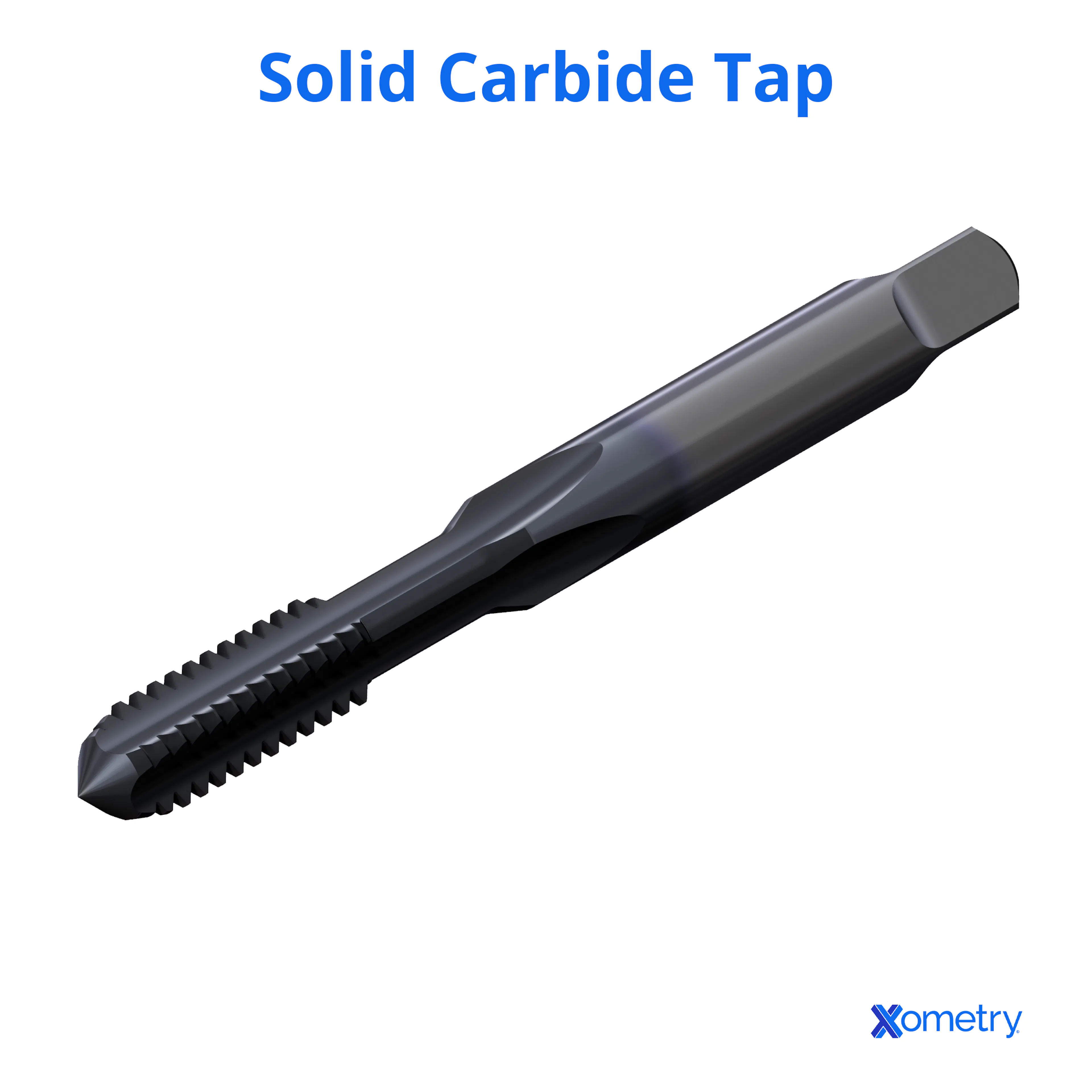

9. Solid Carbide Tap
Solid carbide taps are threading implements made of composite material that consists of sintered ultra-fine tungsten carbides. They are commonly used on hard materials as solid carbide has an extremely high hardness and wear resistance. One of the key benefits of solid carbide taps is the long life span of this tool, even in more challenging working environments. Figure 12 shows a solid carbide tap:

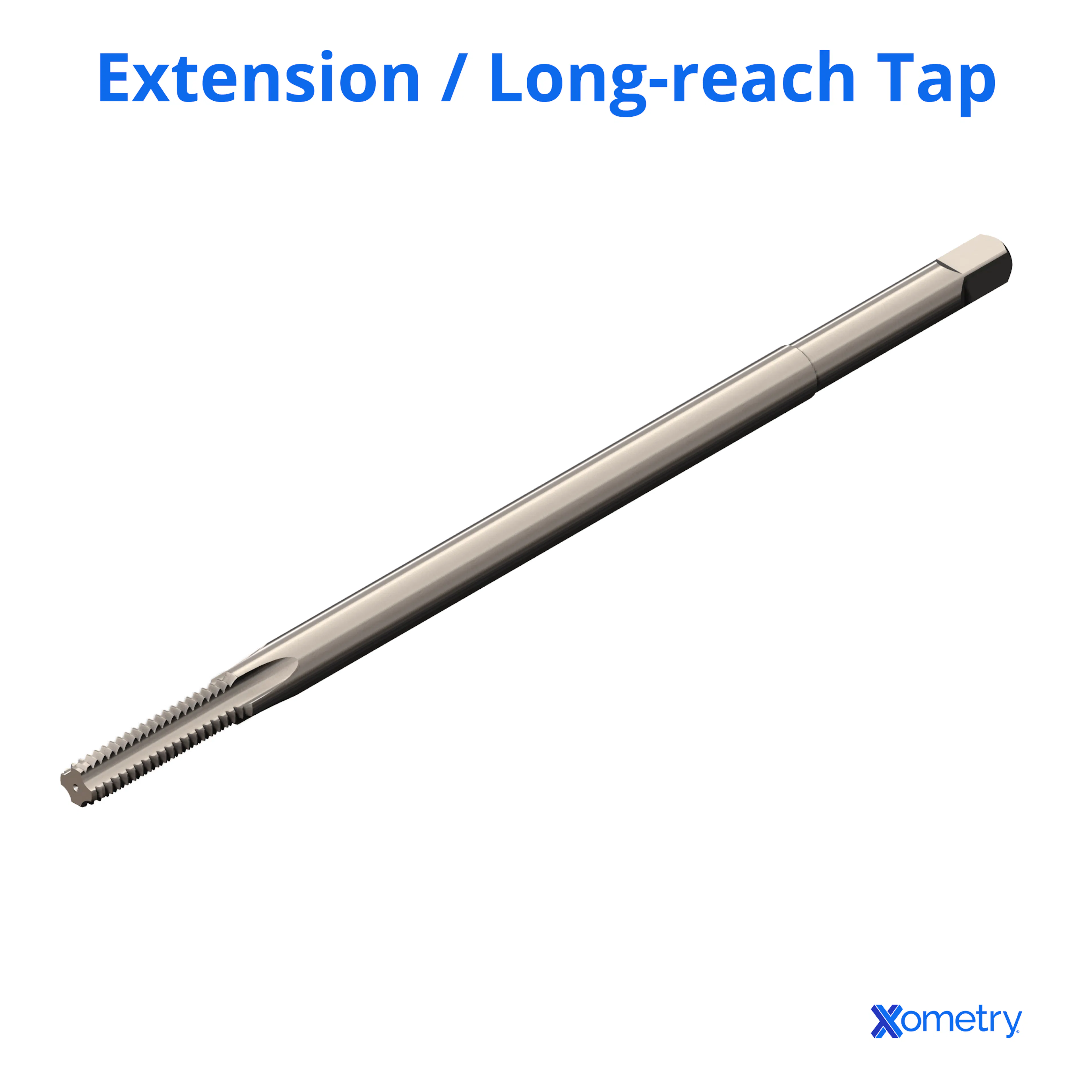

10. Extension Tap
Extension taps provide an alternative form of thread tap. Due to their long shank on top of the body, extension taps are commonly used to reach more inaccessible holes, for example, the hub of a pulley. The extension tap is very similar to hand taps. Figure 13 shows an extension tap:

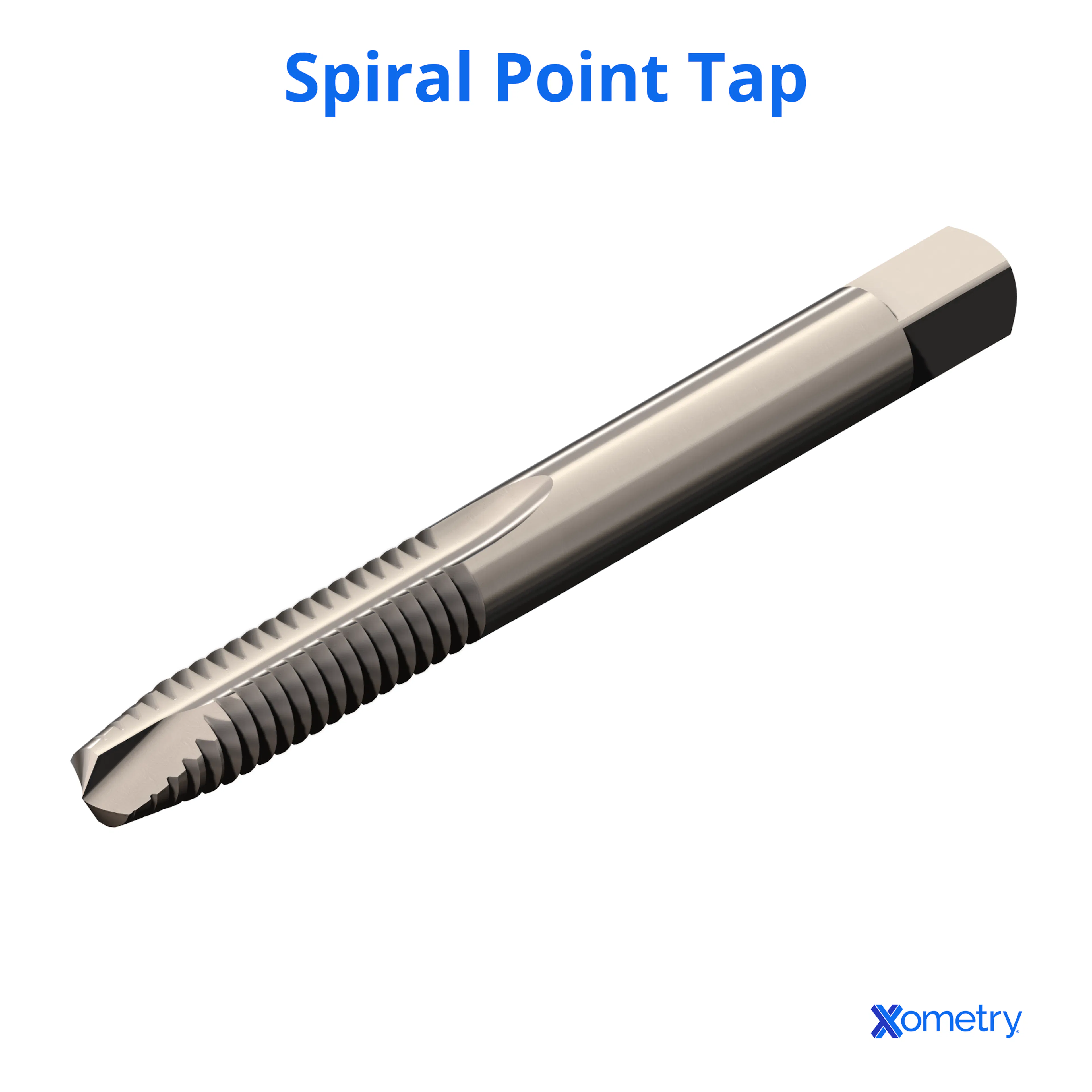

13. Spiral Point Tap
A spiral point tap is an alternative form of threading tap used to create threads into a material. By its design, the spiral point tap is used in situations in which higher tapping speeds are required, with lower power to drive and greater strength than other threading taps. In comparison to conventional taps, a spiral point tap has a shallower flute passage, enabling the spiral point tap greater cross-sectional area. While they may be considered very similar compared to a straight flute tap as they share the same general physical dimensions, the key differentiator is the cutting face of the spiral point tap. Figure 16 shows a spiral point tap:
Slide 1 of 1
spiral point tap
spiral point tap
spiral point tap
Spiral point tap.
Image Credit: https://www.rennietool.co.uk/products/hss-ba-spiral-point-taps

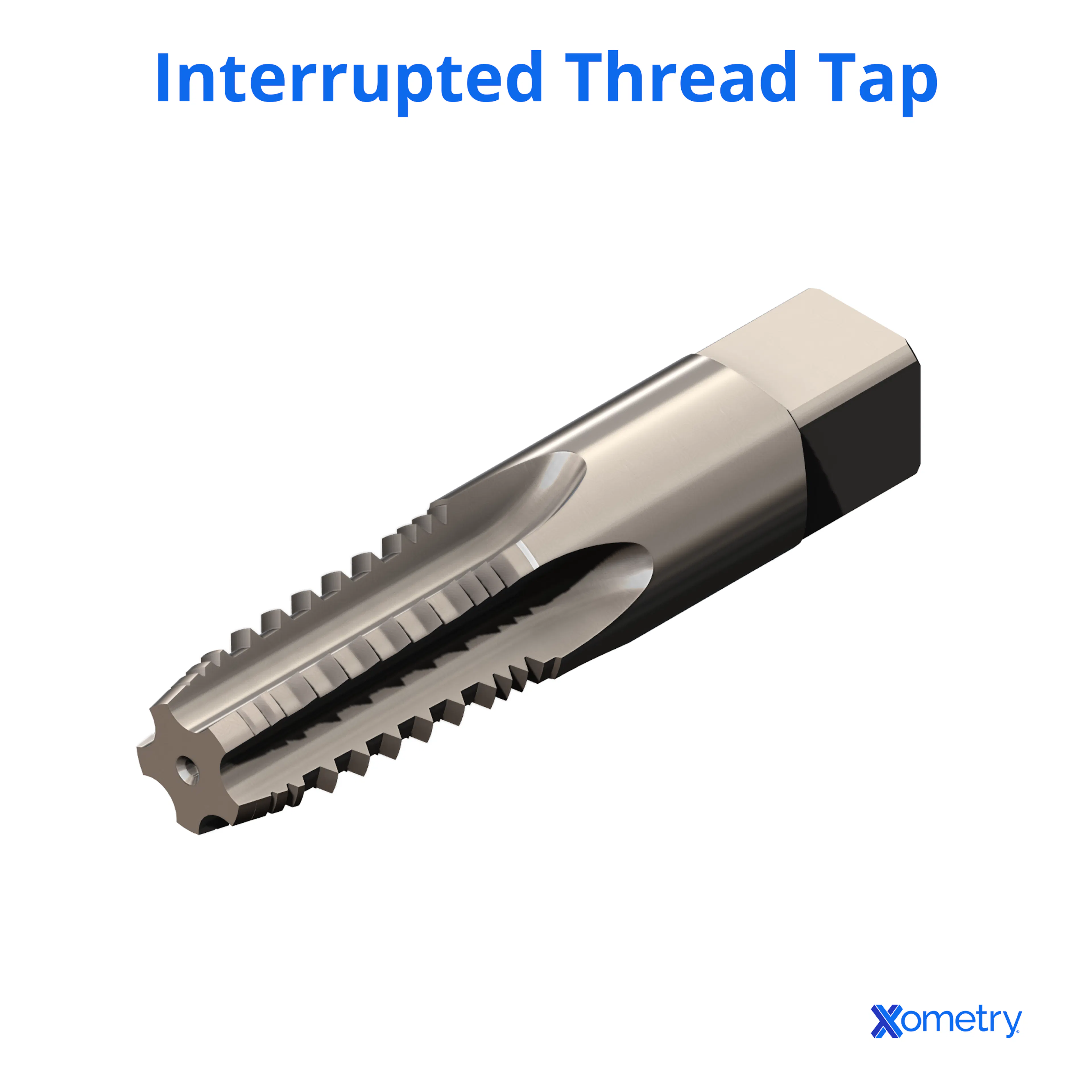

16. Interrupted Thread Tap
These thread taps only have a tooth for every other thread.  The idea is to provide improved chip extraction.  Removing every other tooth helps break chips and also provides more room for the chip to escape and for lubricant to come in and do its job.

18. Form or Roll Taps (Thread Forming Taps)
Thread Forming taps don’t cut threads at all. Instead they cold form. Threads made this way are often called “rolled” threads.
With this process, the metal is pushed out of the way and compressed into position rather than being cut.  There are no chips to remove.  As a result, the taps themselves are less likely to break and the threads they make are stronger. If your application allows Form Taps, they are generally the best thing going for those reasons.
Form Taps do require different feeds and speeds and they require a different starting hole size, so be aware of that before using one.
While many believe they’re only good for soft materials like aluminum, they can actually be used on materials up to a hardness of 36 HRC, which is about 340 BHN. That covers a surprisingly wide range of materials including a lot of steels.
I will almost always choose a Form Tap over a Cutting Tap out of the available types of taps if the material isn’t too hard for thread forming.

What Is the Type of Thread Tap Used for CAM Milling?
Machine taps can be used for CAM (computer-aided manufacturing) milling. Machine taps are fully automated and are therefore compatible with specialized software that automates the manufacturing process. Machine taps can be used on a wide variety of materials used in CAM milling and can be used to thread both through and blind holes.
This article presented the different types of thread taps, explained each of them, and discussed how and when to choose which type of thread tap. To learn more about thread taps, contact a Xometry representative.
