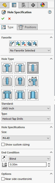

2. Specify Insert Type Using HoleWizard
Click on the HoleWizard tool. Select the Type tab. The Hole Specification window will appear in the Design Tree. Select Hole as the Hole Type. Select ANSI Inch in the Standard drop-down list. Select Helicoil Tap Drills in the Type drop-down list. Select #4-40 in the Size drop-down list in the Hole Specifications area. The HoleWizard Hole Specification will look like this.
Xometry Instant Quoting Engine Add-In for SOLIDWORKS - HoleWizard with Hole Type: Hole, Standard: ANSI Inch, Type: Helicoil Tap Drills, and Size: #4-40

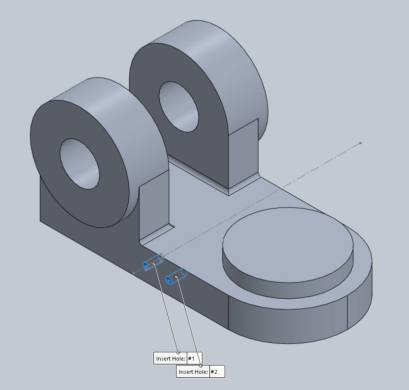

5. Toggle Insert Visibility On/Off
Xometry for SOLIDWORKS will annotate the detected holes in the Graphics Area. The Show on Model toggle can be used to turn Insert Hole annotations on and off.
Xometry Instant Quoting Engine Add-In for SOLIDWORKS - Insert Holes Visible and Labeled on Simple Bracket Model

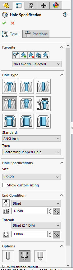

7. Specify Threaded/Tapped Hole Type Using HoleWizard
Click on the HoleWizard tool. Select the Type tab. The Hole Specification window will appear in the Design Tree. Select Straight Tap as the Hole Type. Select ANSI Inch in the Standard drop-down list. Select Bottom Tapped Hole in the Type drop-down list. Select ½-20 in the Size drop-down list in the Hole Specifications area. The HoleWizard Hole Specification will look like this.
Xometry Instant Quoting Engine Add-In for SOLIDWORKS - HoleWizard with Hole Type: Straight Tap, Standard: ANSI Inch, Type: Bottom Tapped Hole, and Size: 1/2-20 Selected

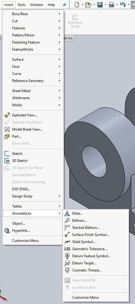

16. Create Surface Roughness Annotation
Utilize the Xometry for SOLIDWORKS surface roughness detection feature by assigning surface roughness annotations to your part file using the SOLIDWORKS Annotation tool. You can assign surface roughness information using the Insert Annotations drop-down list.

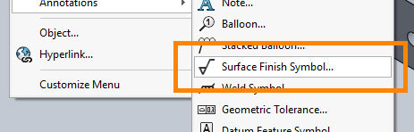

17. Specify Surface Roughness Value
Click on the Surface Finish Symbol command. In this tutorial, we will specify 32 uin in the Maximum Roughness input field.
Xometry Instant Quoting Engine Add-In for SOLIDWORKS - Surface Finish Symbol Button Highlighted in Annotations Sub-Menu

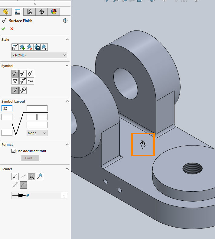

18. Position Surface Roughness Annotation
Click in the Maximum Roughness field (upper left field in the Symbol Layout) and specify a value of 32. Select a feature to which you would like to apply the surface roughness. In this case, we will apply the surface roughness to the top surface on the Simple_Bracket_A part file.
Xometry Instant Quoting Engine Add-In for SOLIDWORKS - Positioning Surface Roughness Annotation on Simple Bracket Model
