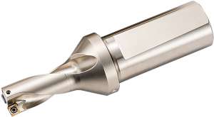

Kyocera S100DRV0812406, DRV Magic Drill 0.8120" Drill Diameter, 4xD, Indexable Drill
Kyocera
Economical inserts with 4 cutting edges and excellent chip evacuation~2xD to 6xD drilling lineup with 4 chipbreakers for various machining applications~High speed and highly efficient machining with the combination of a CVD outer insert and PVD inner insert~Excellent hole accuracy with a highly rigid design for better chatter resistance
Kyocera S100DRV0812406, DRV Magic Drill 0.8120" Drill Diameter, 1.000" Shank Diameter, 4xD, Coolant-Through Indexable Drill
Manufacturer Part Number 8859070
Shank Type Weldon
Compatible Inserts SCMT060205-GH-E, SCMT060205-GM-E, SCMT060205-SM-E, SCMT060205-XM-E, SCMT060210-GH-I, SCMT060210-GM-I, SCMT060210-SM-I, SCMT060210-XM-I
Drill Depth Ratio 4xD
Max Drill Depth 3.25
Coolant Through Yes
Shank Diameter 1
Overall Length 6.217
Shank Length 2.126
Min Diameter 0.812
Max Diameter 0.5315
Holder Style DRV
Num Inserts 2
Holder Type Indexable Drill
Head Length 4.091
Num Flutes 2
Material HSS
Diameter 0.812
Manufacturer Kyocera
