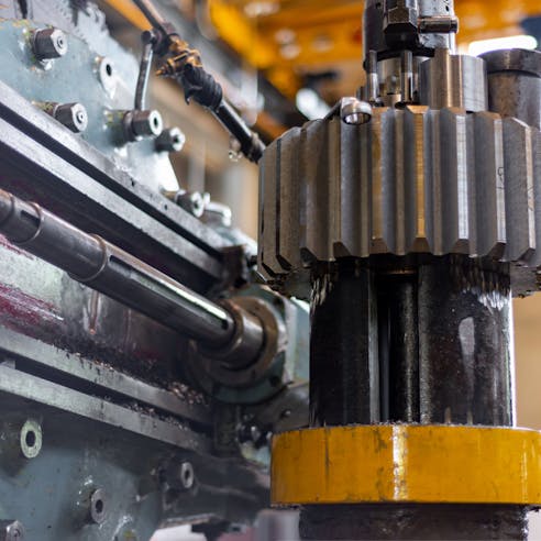

Gear hobbing is a commonly utilized gear-cutting process that involves the use of a hobbing machine and multipoint hobbing-cutting tools to create precise and repeatable pinion teeth. It is an efficient and precise method for producing cylindrical, spur, screw, and helical gears.
The gear hobbing process starts with a hobbing machine. This consists of a rotating spindle that holds the gear blank (the workpiece) and a hobbing tool mounted on a movable carriage that runs perpendicular to the axis of the gear blank (for spur gears) or at the required engagement angle (for bevel gears). This rotating tool can be fed along its axis, along the radial axis of the blank, or in cooperating feeds on both axes, depending on the complexity of the required tooth forms. For screw gear teeth and curved bevel gear teeth, more complex relationships apply between the blank rotation and the hobbing rotation. Hobbing tools exist off the shelf for all standard gear profiles, and they are selected based on the gear type and specifications—particularly tooth size, tooth profile, and helix angle.

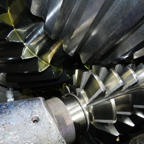

Hobbing with axial feed is a type of gear cutting that uses a hobbing machine to cut gear teeth by feeding a hobbing tool axially along the outer face of a rotating gear blank. This process is commonly used for the production of cylindrical spur gears. It is simple to set up and operate, and it delivers high accuracy.
Axial-feed hobbing is the most widely used method for the manufacture of gears, as the great majority of demand is for basic, straight-toothed (non-helical) spur gears. It allows the output of gears with accurate tooth profiles, and the process is suitable for various gear types, sizes, and applications. This technique is commonly used in industries such as: automotive, industrial machinery, and aerospace. It finds application at a wide range of scales, from watchmaking to heavy equipment like steel bars and plate rolling mills.

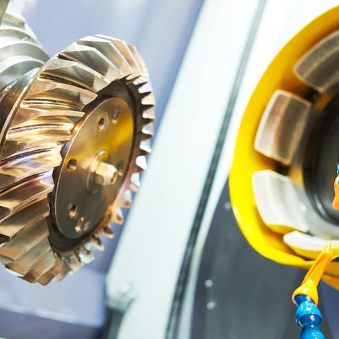

Gear hobbing with radial feed is a gear-cutting process that involves using a hobbing machine to create gear teeth by feeding a hobbing tool radially into the rotating gear blank. This method is commonly used for the production of gears with helical or spiral tooth profiles such as worm gears. This is also generally a cyclic process in which the radial offset of the hobbing gear is progressively reduced in multiple passes. Alternatively, the axial feed of a tapered hobbing tool will allow a progressive creation of the full tooth profile/depth.
Radial feed gear hobbing is a specialized method primarily used for producing gears with helical or spiral tooth profiles. These profiles are more common in high-speed gear systems and those in which meshing noise is considered a problem, facilitating the use of more costly tooth forms that alleviate the issue. The process finds applications in industries such as: automotive, aerospace, and machinery manufacturing—whenever gear noise and operational efficiency are critical factors.

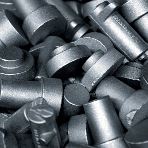

  1. Cast Iron: In its most basic type, gray iron can be cast and machined into high-quality gears. The application of cast iron is an alternative to phosphor bronze, as long as the material’s magnetic field is not an issue. Gray-iron castings are low-cost to produce and can deliver the complete net shape of the gear. Cast iron is selected for relatively low-speed and well-lubricated applications, offering low-cost and moderate wear properties.
  2. Ductile Iron: Ductile or nodular cast iron offers all of the advantages of gray cast iron, with improved toughness and wear properties—at a slightly higher cost.
