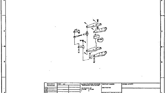

Mistake #1: Drawings that are Plain Illegible
When an old drawing finally gets scanned into a digital file, there is no guarantee that the drawing used is actually the original. It could be, itself, a copy or from a series of copies. Each time a copy is made, there is a chance that details may be lost. By the time some older prints, like those originally made in the 1950s, ’60s, or ’70s, are digitally scanned, there may be so many artifacts in the print that it may take serious detective work to figure out what the notes or dimensions actually say. One of the first things manufacturers look for when reviewing 2D technical drawings is if there are any unreadable or ambiguous areas that require clarification.
Other examples of this mistake are when prints are half-scanned, cutting off critical information on edges such as a title block or notes callout. This is common for large blueprint drawings that may have been too big to be scanned in one go. Either way, the part may require some reverse engineering or calls to the original engineers to find a better copy or make a brand new version of the file. A general rule of thumb is that if you cannot read it, neither can the manufacturer.

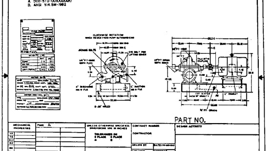

Mistake #2: Providing an Assembly Drawing Without Part Details
Another challenge with legacy components is that they may actually be the upper-level assembly of several discrete mechanical components. Assembly drawings are typically built to define how each component relates to the other when assembled. This can include how many of each component, each component's unique name, how many of each part is needed, and possibly some minor distance or fit validation measurements. Unfortunately, that does not help the manufacturer if they are needed to make the sub-components of the assembly. Manufacturers require detailed mechanical drawings of each part to properly build the finished product.
One thing a buyer or engineer can check for when sourcing for assemblies is if each component is outlined on the drawing with technical specifications. This should be specifications like dimensions, material, finishes, and markings. Assembly drawings can have a front page bill of material sections that outline the components, quantity, and sometimes (if you’re lucky) following pages in the drawing with their supplemental manufacturing information.

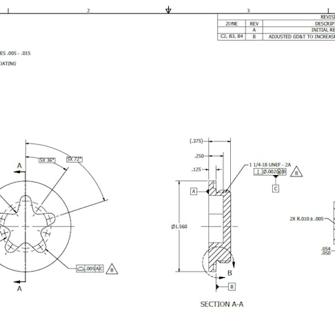

Mistake #3: The Drawing is Incomplete
This third challenge marks a paradigm shift between older, 2D-drawing-only prints and newer, CAD-controlled drawings. In CAD-controlled drawings, the best practice is to provide the 3D CAD model and use the print for supplementary critical tolerances, threads, features, finishes, etc. The 3D CAD model is sufficient for the majority of the part’s geometry, while the supplemental drawing can provide select details that the 3D CAD does not. When providing a manufacturer with only a flat drawing, such as a PDF or even a hand sketch, the information must be complete. There should be a reference for every hole location, fillet, feature distance, thread, depth, etc. A fully defined drawing ensures that, if properly produced, the part will have no critical variation between manufacturing runs or individual manufacturers.
Incomplete information, like the missing thread callout in the image below, may not always be as obvious as a missing measurement. Sometimes it could be missing notes, like materials or finishing requirements. In legacy drawings, it may be a specification call out to an unreleased internal document. Manufacturers typically look at the part, then to the title block, then to the notes, and repeat to check if all information is available to successfully produce the project.
