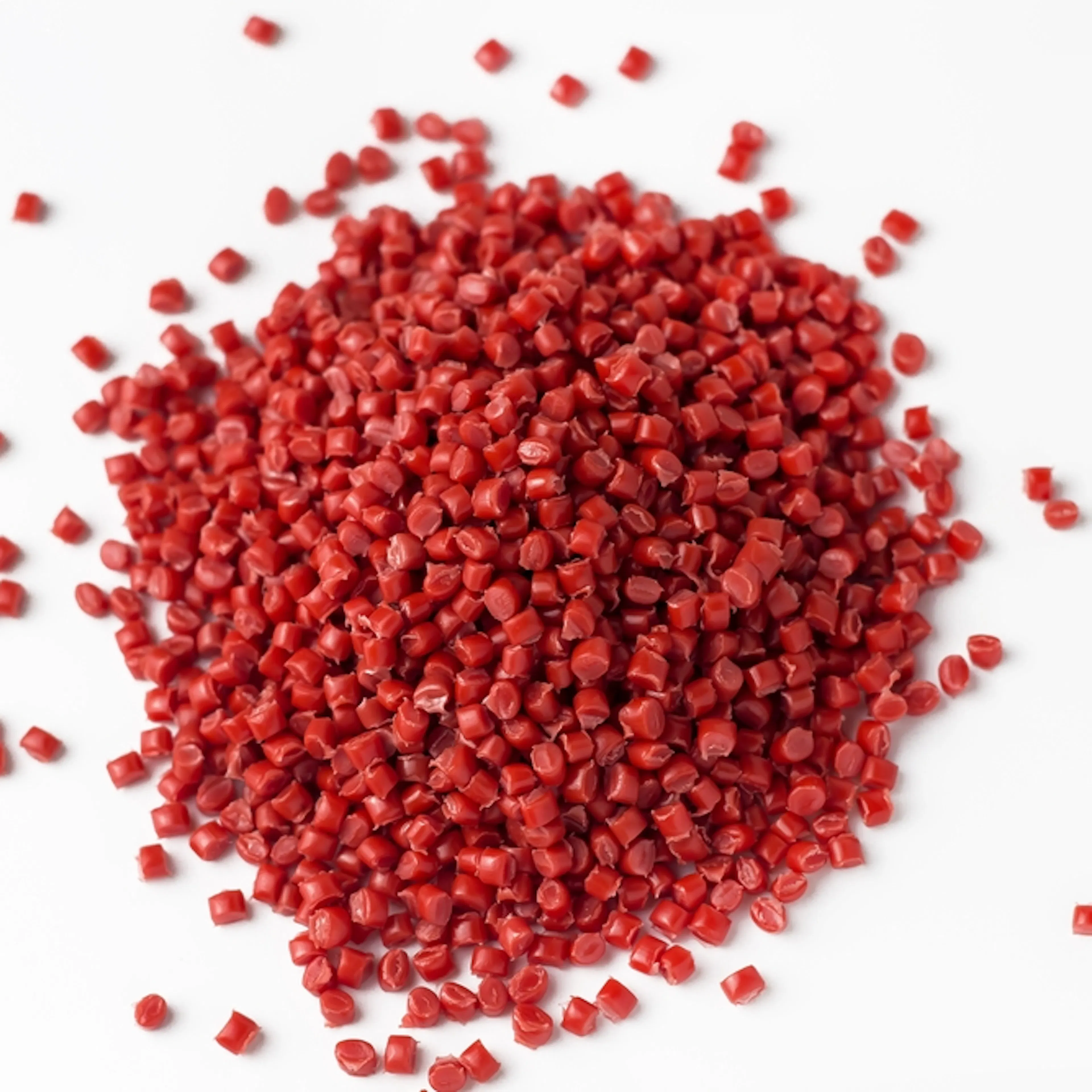

Red granules of polypropylene. Image Credit: Shutterstock.com/Anastasiia Burlutskaia

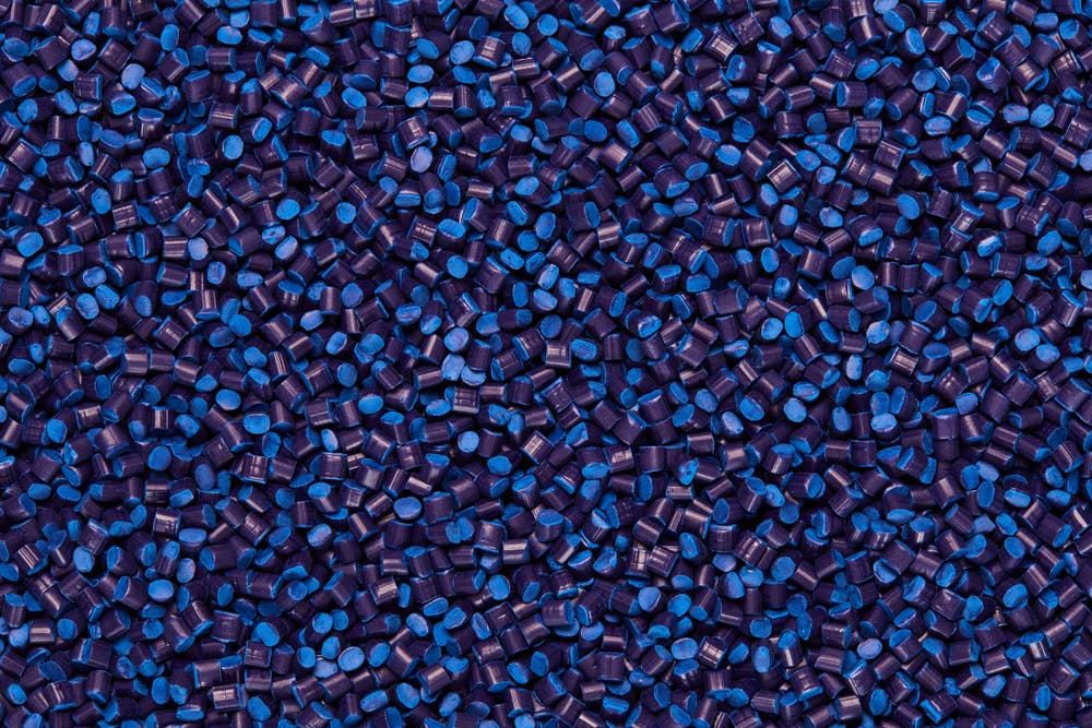

Figure 1 is an example of polypropylene pellets:
Slide 1 of 1
dark blue and medium blue polypropylene pellets
Polypropylene pellets in two colors.
Image Credit: Shutterstock.com/sveticluka
The packaging industry is the largest consumer of polypropylene, accounting for roughly 30% of the market. Electrical and equipment manufacture take up about 13% each. Construction materials take up 5% of PP’s market, followed by household appliances and automobiles which consume 10% each. The remainder is made up of other, more minor applications.
As an addition polymer, polypropylene is produced by connecting monomers together through straightforward additive reactions with no byproducts. Polypropylene is produced from a mixture of propylene monomers and has the chemical formula (C3H6)n. The two main synthesis processes for polypropylene are metallocene-catalyzed polymerization and Ziegler-Natta polymerization.
Polypropylene may form the basis of live hinges using CNC, injection molding, thermoforming, or crimping processes. It can also be easily copolymerized with other polymers, such as polyethylene, to create composite plastics. In comparison to using pure polypropylene, copolymerization dramatically alters the material's characteristics, enabling more durable technical applications.

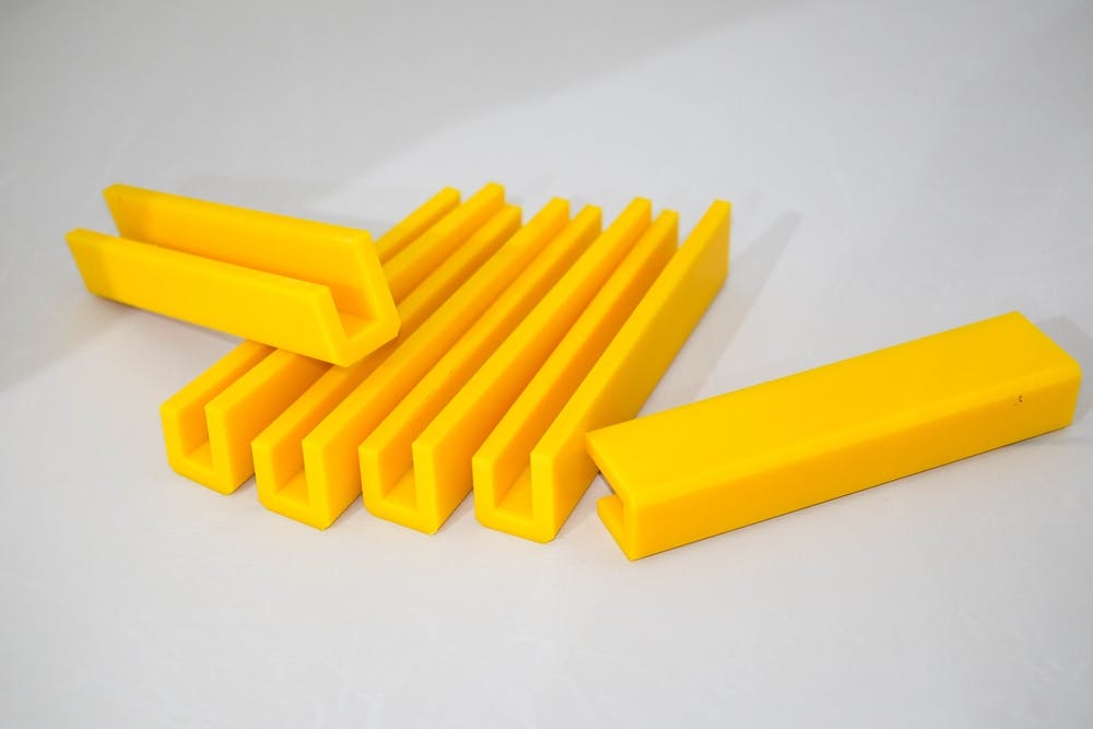

Figure 2 below is an example of nylon:
Slide 1 of 1
nylon sliders
nylon sliders
nylon sliders
An example of nylon sliders.
Image Credit: Shutterstock.com/Sander K
The four primary polyamide nylon grades are nylon 66, 11, 12, and 46. These designations are derived from the respective lengths of their polymeric chains. The diamine's carbon atom count is represented by the first number, and the acid's carbon count is represented by the second. The term, "PA" (e.g., PA 6 or PA 6/66), is commonly used to refer to nylon, which is most frequently seen in black, white, and natural-hue (off-white or beige) variants. Nylon 66 is the most common type for engineering applications and the plastic industry. The chemical formula for Nylon 66 is (C12H22N2O2)n.
Toothbrushes, gloves, wheels, guitar strings, strings for tennis rackets, medical devices, electrical connectors, fishing line, and more get made out of nylon.
