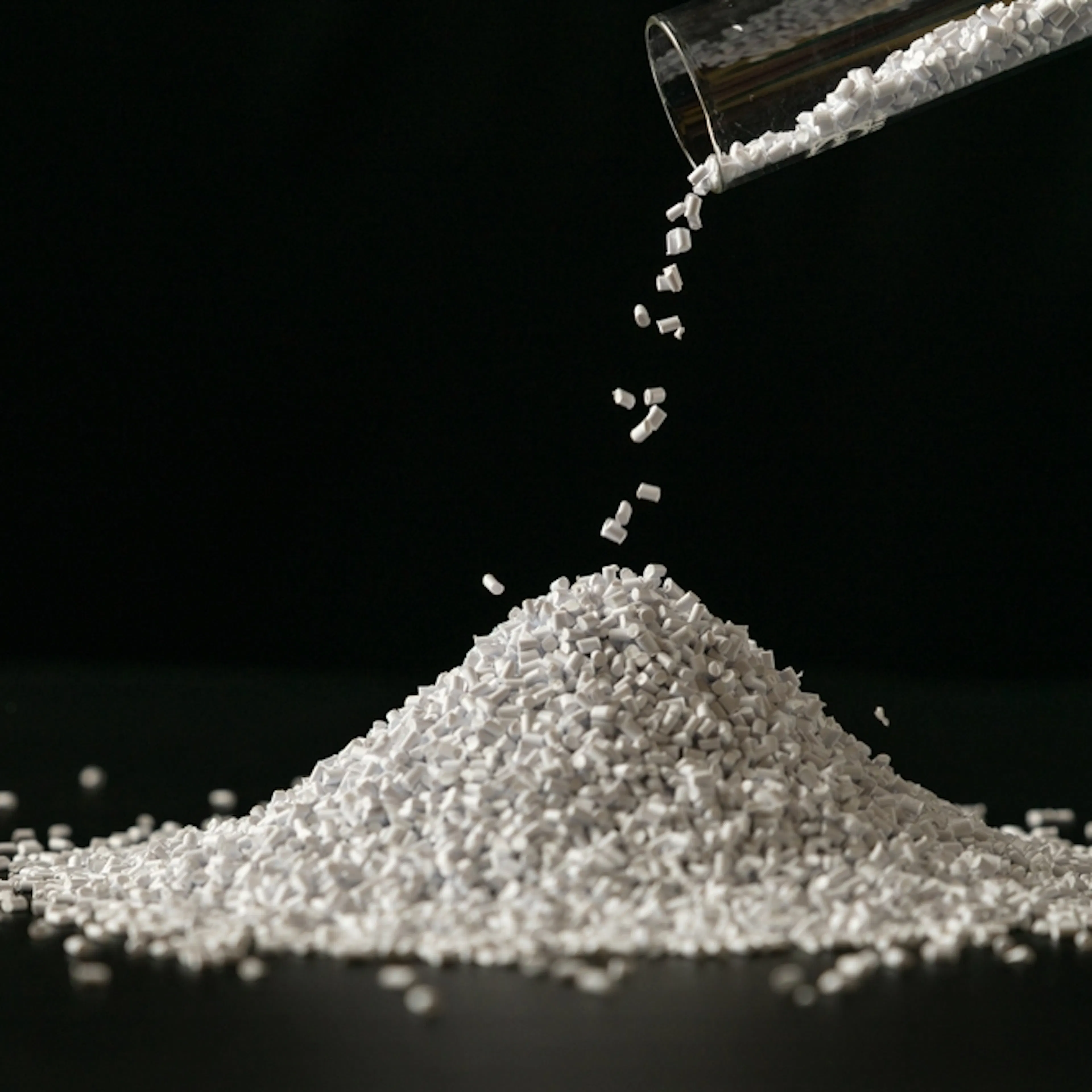

White polymers. Image Credit: Shutterstock.com/Meaw_stocker

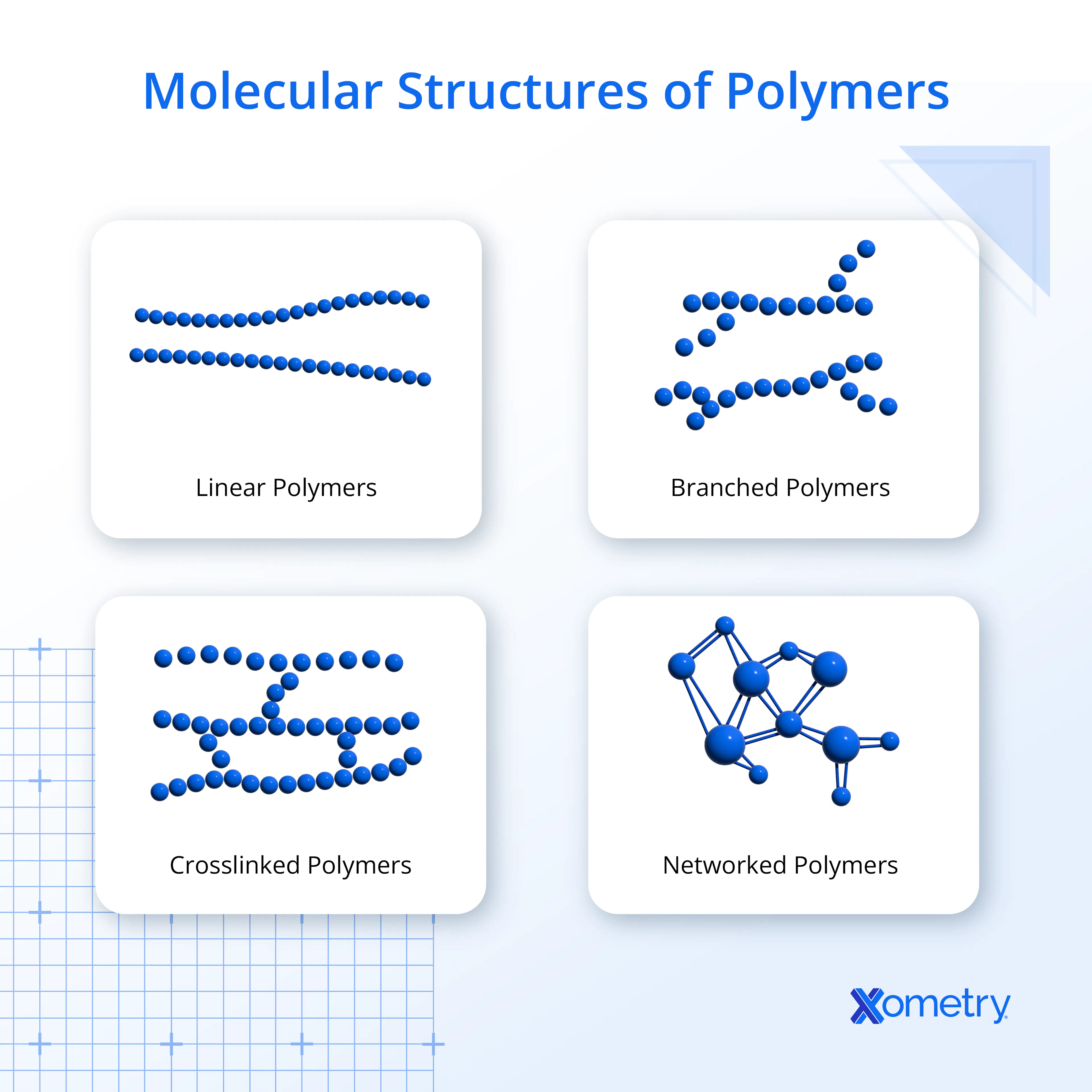

Illustration of polymer molecular structures

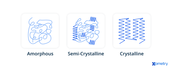

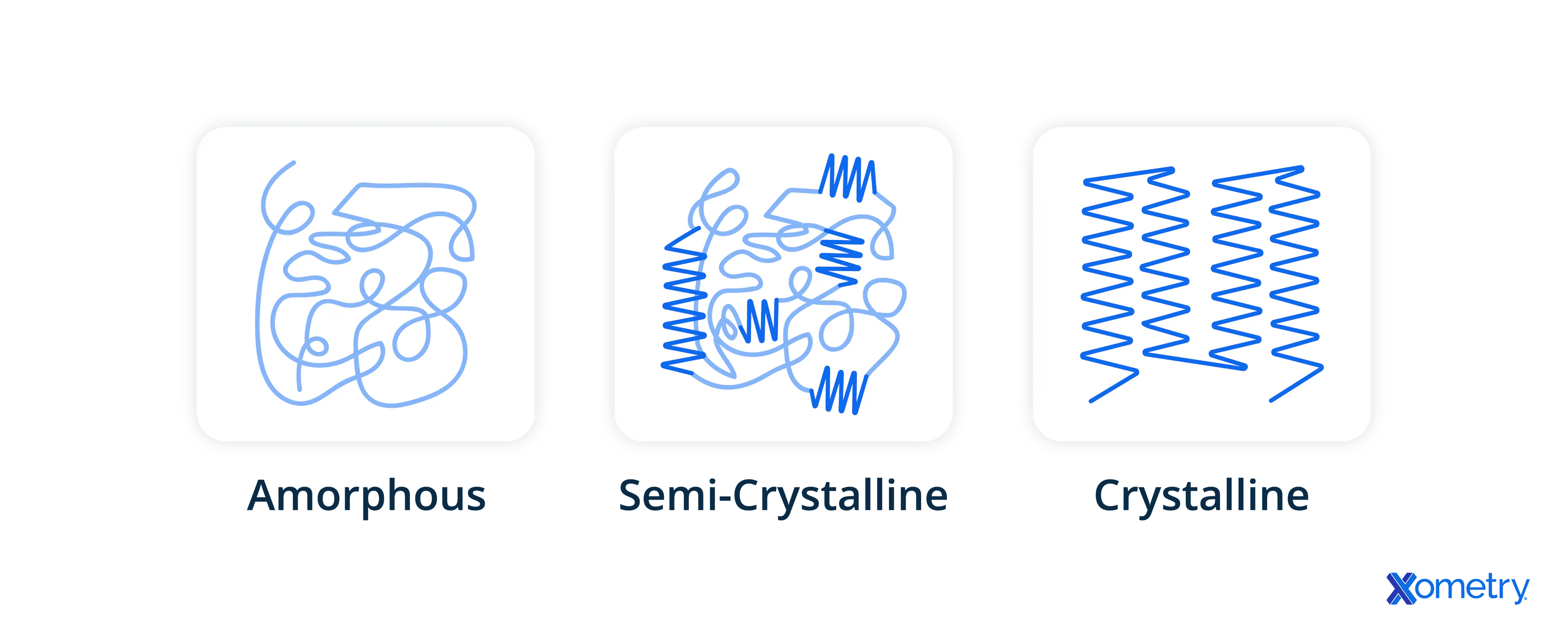

  5. Most polymers are either semi-crystalline (with both ordered and disordered regions) or fully amorphous.
Amorphous, semi-crystalline, and crystalline structures
What Is the Structure of a Polymer?
Polymers can have different molecular structures: linear, branched, cross-linked, or networked. Cross-linked and networked polymers are closely related, since both involve bonds between parallel chains, but they are sometimes described separately depending on the density and connectivity of those bonds. Linear polymers consist of a chain of monomers, typically called the backbone in branched and cross-linked polymers. Bonded to the backbone are pendant groups, which can include atoms such as hydrogen, chlorine, or fluorine, or more complex functional groups. These pendant groups hang from the carbon chain like charms on a bracelet. When pendant groups connect to other parallel chains, the result is a network or cross-linked polymer. In general, higher crosslink density increases stiffness and strength, while fewer or longer crosslinks allow greater flexibility.

Because plastics are polymers, they can have linear (like PVC), branched (like low-density polyethylene), or cross-linked (like bakelite and melamine) structures. The chemical composition of the monomers that form the plastic determines its structure and type of polymer. Plastics can be amorphous, with disordered molecular chains, or semi-crystalline, containing both ordered crystalline regions and amorphous regions.
