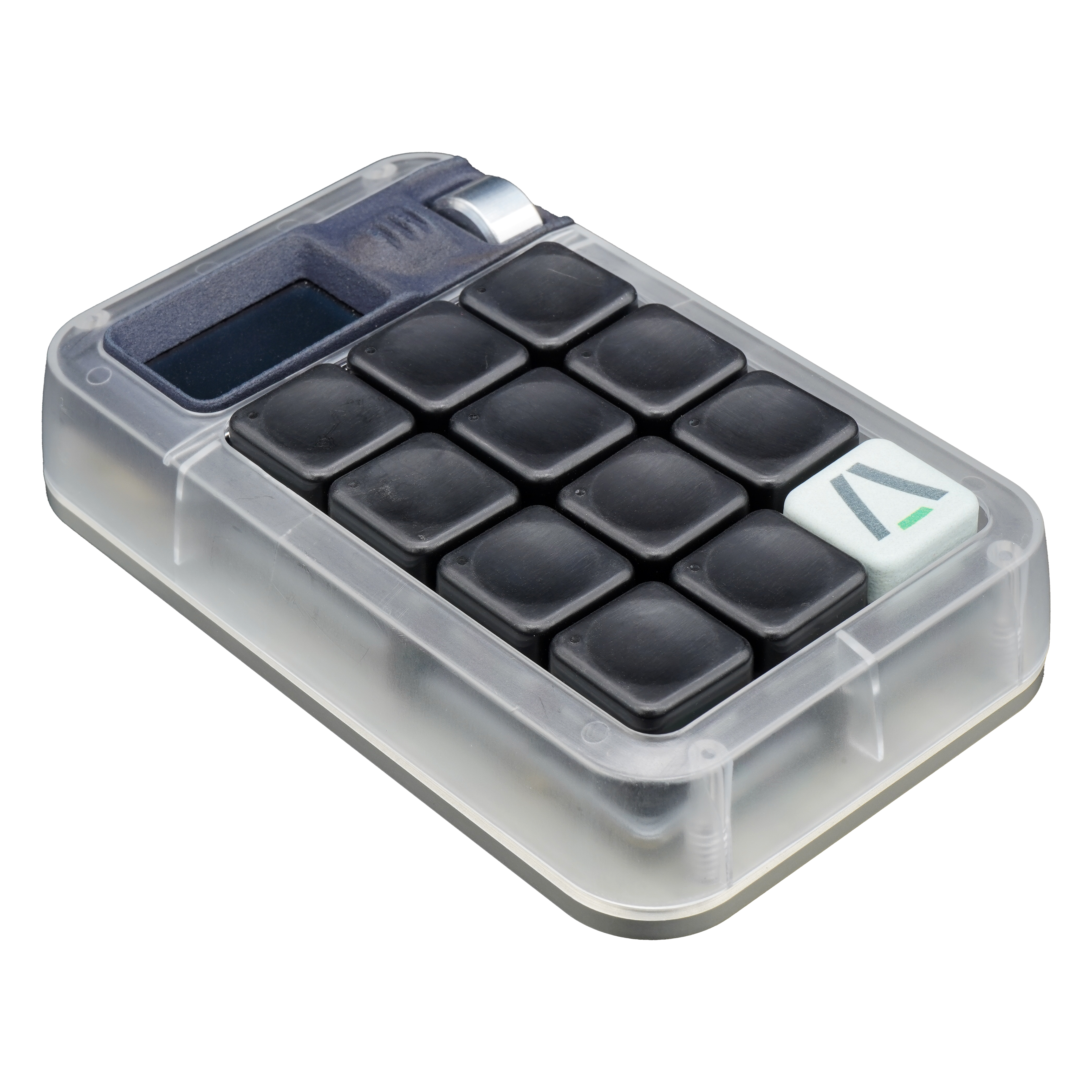

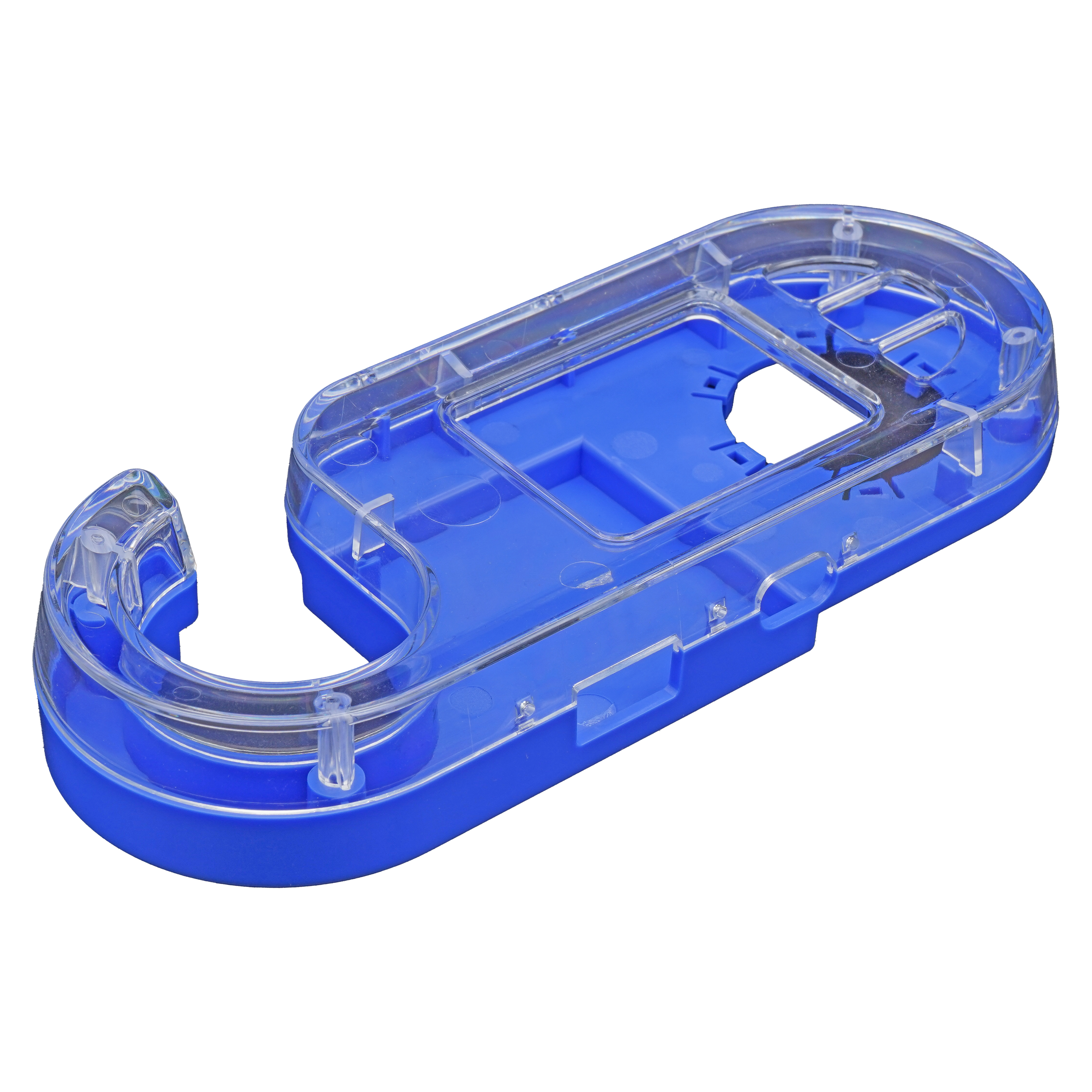

    Plastic injection-molded device casings in multiple color options.

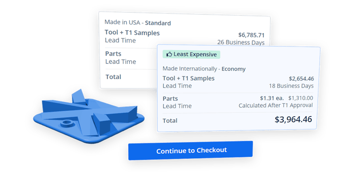

    Instant Quotes and Checkout
    Xometry simplifies and accelerates the injection molding process. Just upload your design to the Xometry Instant Quoting Engine®, receive an automatic injection molding quote, and check out instantly to kick off the order without any pauses or delays. Once your order is placed, you'll receive dedicated support from our team of experts, including in-depth DFM reviews and tooling strategy reports prior to production.

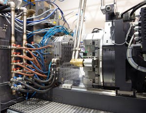

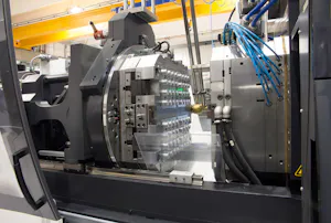

    The plastic injection molding process requires an injection molding machine, raw plastic material, and a machined mold. The raw plastic material is first melted and then injected into the mold—most often machined from steel or aluminum—where it cools and solidifies into the final plastic part, and then finally ejected from the machine.
    Injection molding machine diagram.
    At Xometry, we can review your injection molding project for manufacturability and consult with you to ensure your specifications, lead time, and price fit your needs. We use your 3D CAD to CNC machine a high-quality injection mold. Once tooling is created, Xometry sends samples (T1) for approval. Once samples are approved, Xometry begins production. We use this process to mold everything from the smallest medical insert up to large automotive, aerospace, and defense parts.

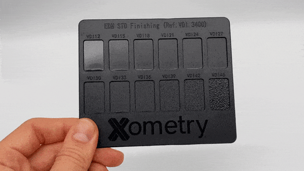

    Injection Mold Finishes & Post-Processing Options
    Standard Finish
    Moldmaker's choice of finish. Typically SPI B-2, depending on geometry and drafts. Interior, non-cosmetic faces, are typically as-machined.
    SPI Finishes
    Range of Society of Plastics Industry (SPI) finishes from Grade 3 diamond / high polish to 320 stone low polish. Finishes include: SPI A-1, SPI A-2, SPI A-3, SPI B-1, SPI B-2, SPI B-3, SPI C-1, SPI C-2, SPI C-3, SPI D-1, SPI D-2, and SPI D-3.
    • SPI A-1 — Super high gloss, polished with a Grade #3 (6000-grit) diamond buff to Ra 0.012–0.025 µm. Used for lenses, light pipes, and mirror-finish cosmetic parts.
    • SPI A-2 — High gloss, polished with a Grade #6 (3000-grit) diamond buff to Ra 0.025–0.05 µm. For cosmetic surfaces that don't need a full mirror finish.
    • SPI A-3 — Normal gloss, polished with a Grade #15 (1200-grit) diamond buff to Ra 0.05–0.10 µm. The most economical of the polished A grades.
    • SPI B-1 — Fine semi-gloss, finished with 600-grit paper to Ra 0.05–0.10 µm. Smooth appearance that still hides minor tooling marks.
    • SPI B-2 — Medium semi-gloss, finished with 400-grit paper to Ra 0.10–0.15 µm. A common choice for general-purpose cosmetic surfaces.
    • SPI B-3 — Normal semi-gloss, finished with 320-grit paper to Ra 0.28–0.32 µm. Slight visible texture, suited to less critical cosmetic faces.
    • SPI C-1 — Fine matte, polished with 600-grit stone to Ra 0.35–0.40 µm. Diffuses light and hides fingerprints and small blemishes.
    • SPI C-2 — Medium matte, polished with 400-grit stone to Ra 0.45–0.55 µm. For functional surfaces where gloss isn't wanted.
    • SPI C-3 — Normal matte, polished with 320-grit stone to Ra 0.63–0.70 µm. The most economical of the stone-polished grades.
    • SPI D-1 — Satin texture, dry blasted with #11 glass bead over a 600-grit stone base to Ra 0.80–1.00 µm. Uniform low-sheen appearance.
    • SPI D-2 — Dull texture, dry blasted with #240 aluminum oxide over a 400-grit stone base to Ra 1.00–2.80 µm. Masks flow lines and knit lines.
    • SPI D-3 — Rough texture, dry blasted with #24 aluminum oxide over a 320-grit stone base to Ra 3.20–18.0 µm. The coarsest SPI finish, used for grip surfaces.
    MoldTech Finishes (Mold Texturing)
    Range of finishes including matte, swirls, lines, and patterns. Our most common texture finishes include: MoldTech MT11010, MoldTech MT11020, and MoldTech MT11030. Other textured finishes can be added by request.
    • MoldTech MT11010 — Fine matte texture, 0.001 in (0.025 mm) deep, needing roughly 1.5° of draft. The finest of the three most common MT110xx grades.
    • MoldTech MT11020 — Medium matte texture, 0.0015 in (0.038 mm) deep, needing roughly 2.5° of draft. A more pronounced, uniform grain than MT11010.
    • MoldTech MT11030 — Coarse matte texture, 0.002 in (0.051 mm) deep, needing roughly 3° of draft. The deepest of the three most common grades, for grip and defect hiding.
    Other Textures - VDI
    VDI 3400 Surface Finish (commonly known as VDI surface finish) refers to the mold texture standard set by Verein Deutscher Ingenieure (VDI), the Society of German Engineers. This is mainly processed by EDM machining, producing fine to coarse matte finishes.
    As Molded

    Instant Pricing and Lead Times
    Streamline your budgeting and procurement process with the Xometry Instant Quoting Engine®. Upload your 3D CAD files to receive instant pricing and lead times, so you can plan and kick off your project without the typical delays of manual quoting. Get the information you need up front and checkout when you’re ready to move forward, or have our team of experts thoroughly review your project. Either way, our dedicated team will guide your project to success.
      quote engine

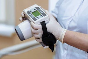

      Medical Injection Molding Service
      High-quality Injection Molded Parts Including ISO 13485 Certified Medical Device Manufacturing | $500 off Your First Mold.
      An injection molding machine. Image Credit: Moreno Soppelsa/Shutterstock

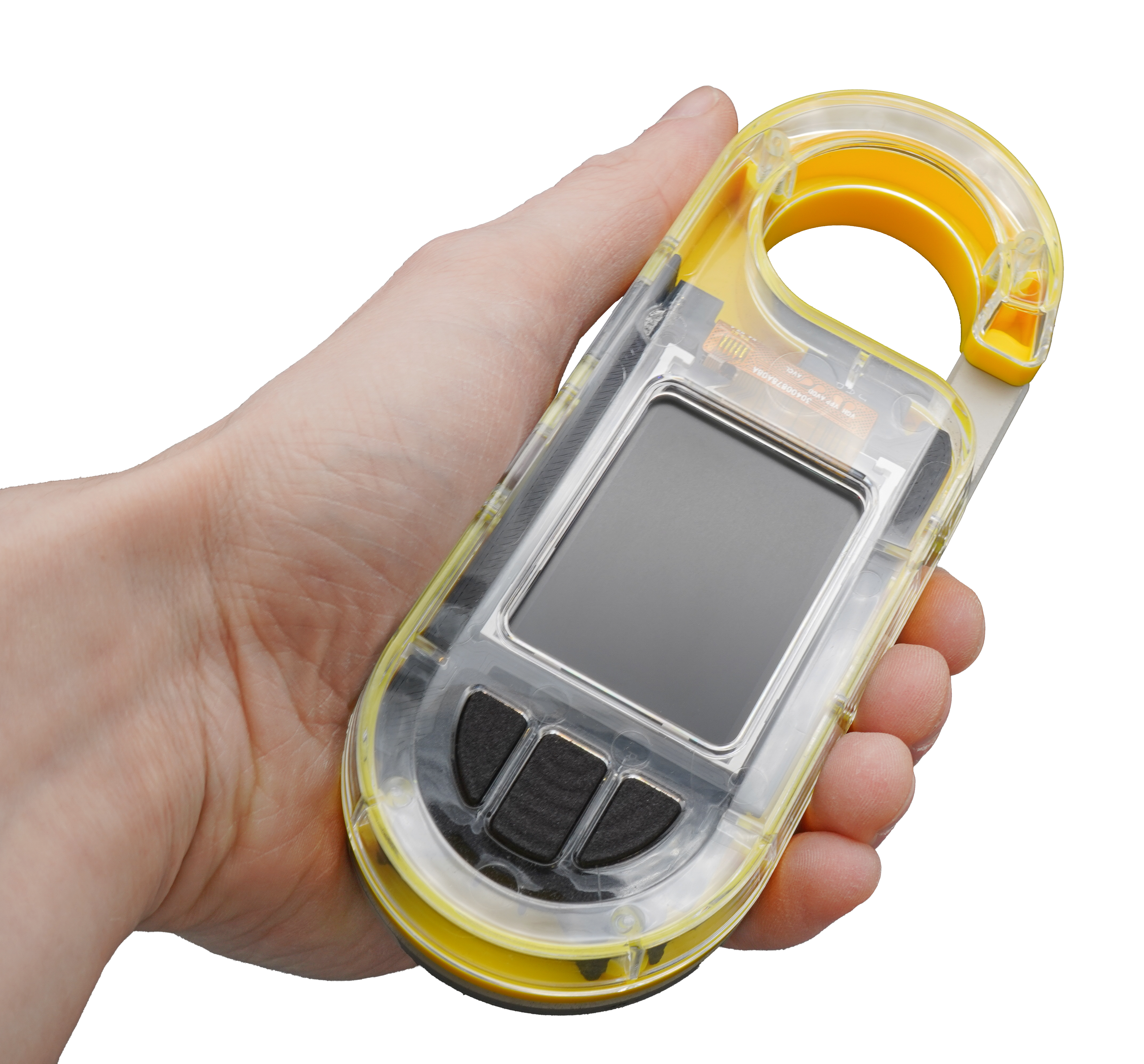

      Keypad with a clear enclosure and over-molded buttons from Xometry.
