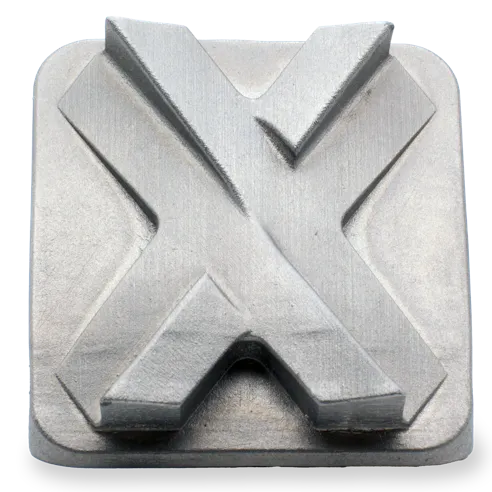

        The front of a binder jet printed Xometry tile printed in 316L stainless steel.
