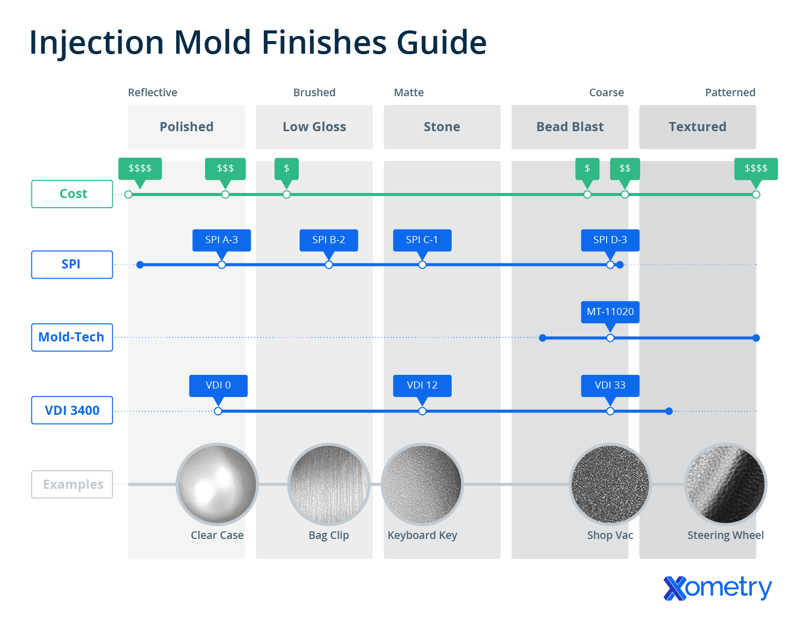

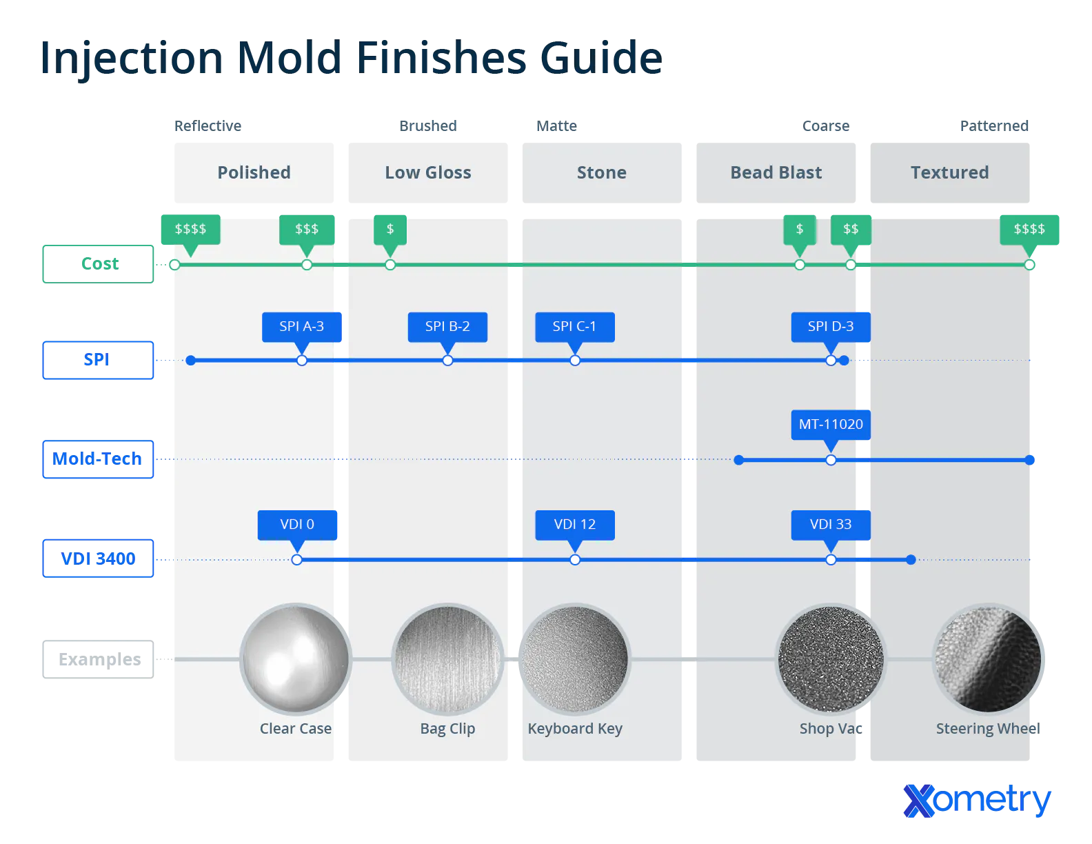

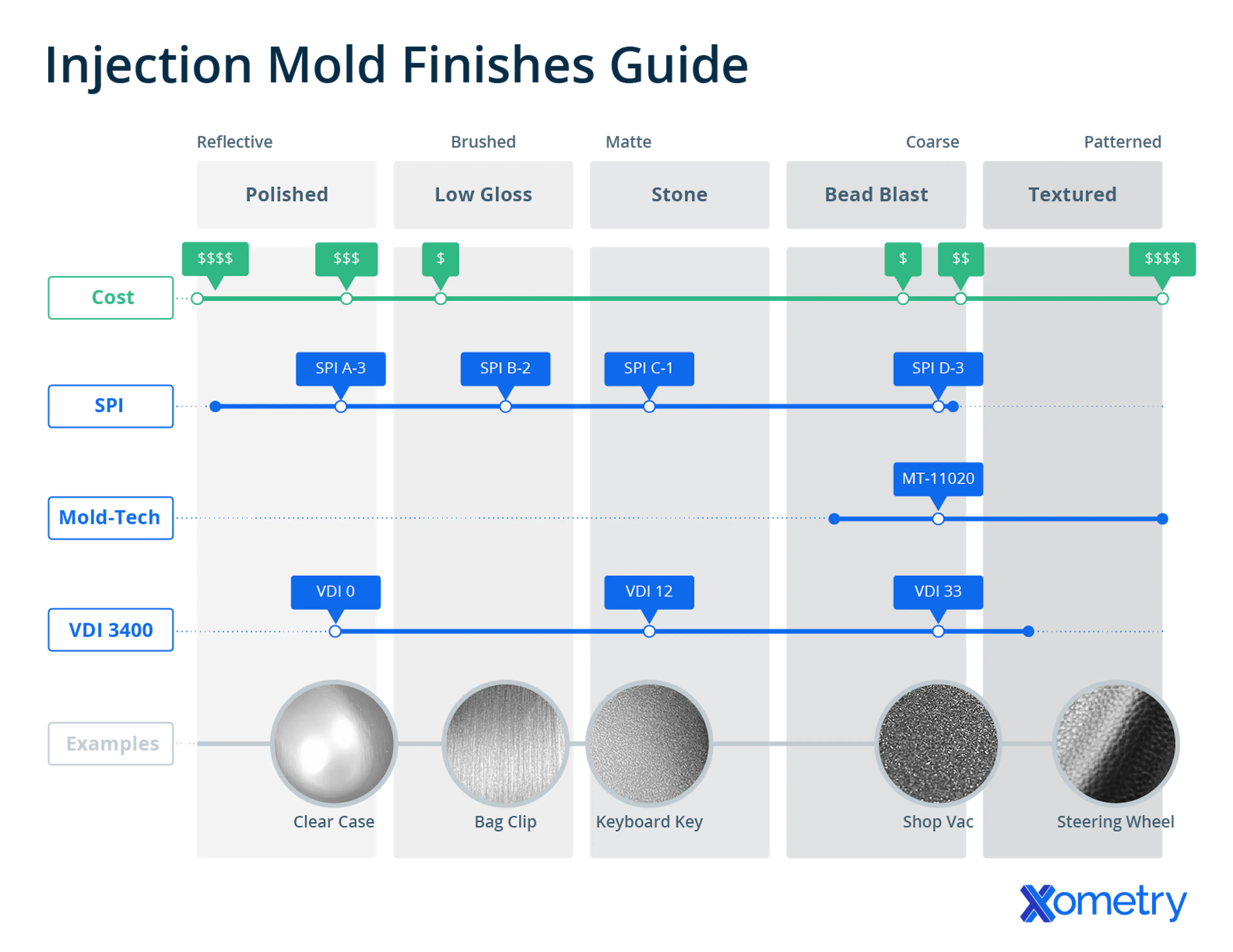

A common question we hear at Xometry is, "What do your molded parts look like?" The answer is: however you want it! Xometry has access to a diverse marketplace of molding suppliers and all standard mold finishing options. Our mold finishes include SPI, MoldTech, VDI (EDM), and others. Mold finishes can range from glossy to matte to even patterned. Finishes applied to the surface of the mold cavity transfer to the surface of the molded part. For example, a mold surface that is polished to be reflective will make a reflective (or transparent) part. Mold finishes are different from finishes for CNC machined, or 3D printed parts, where each component is treated individually. Adding a finish or texture can change the tool's price depending on the process required, but it does not alter the price of the individual parts.

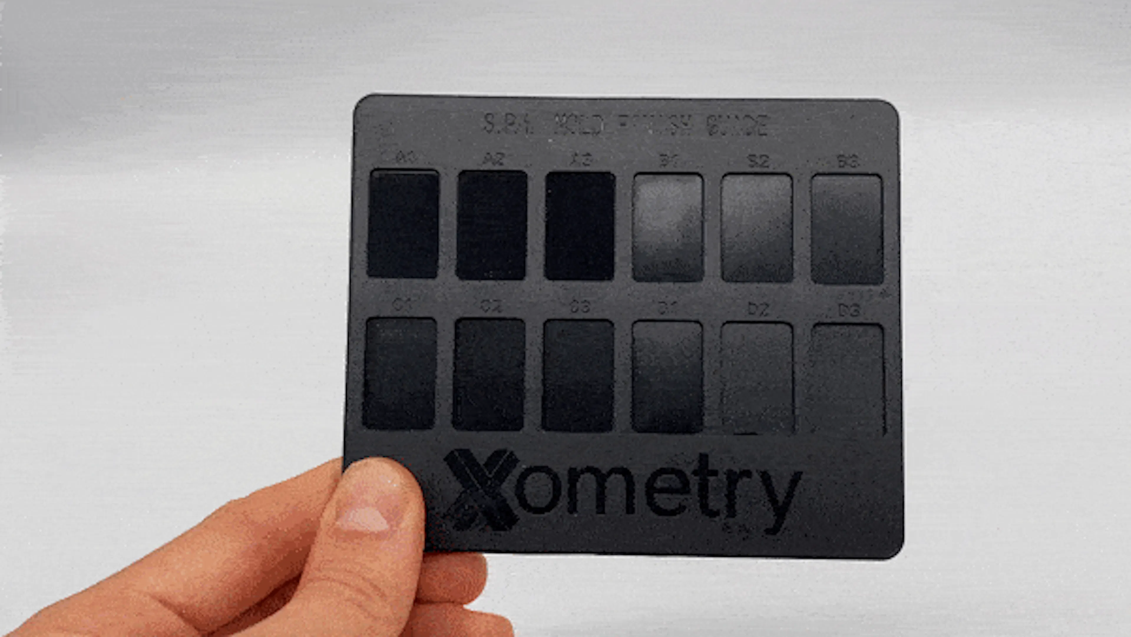

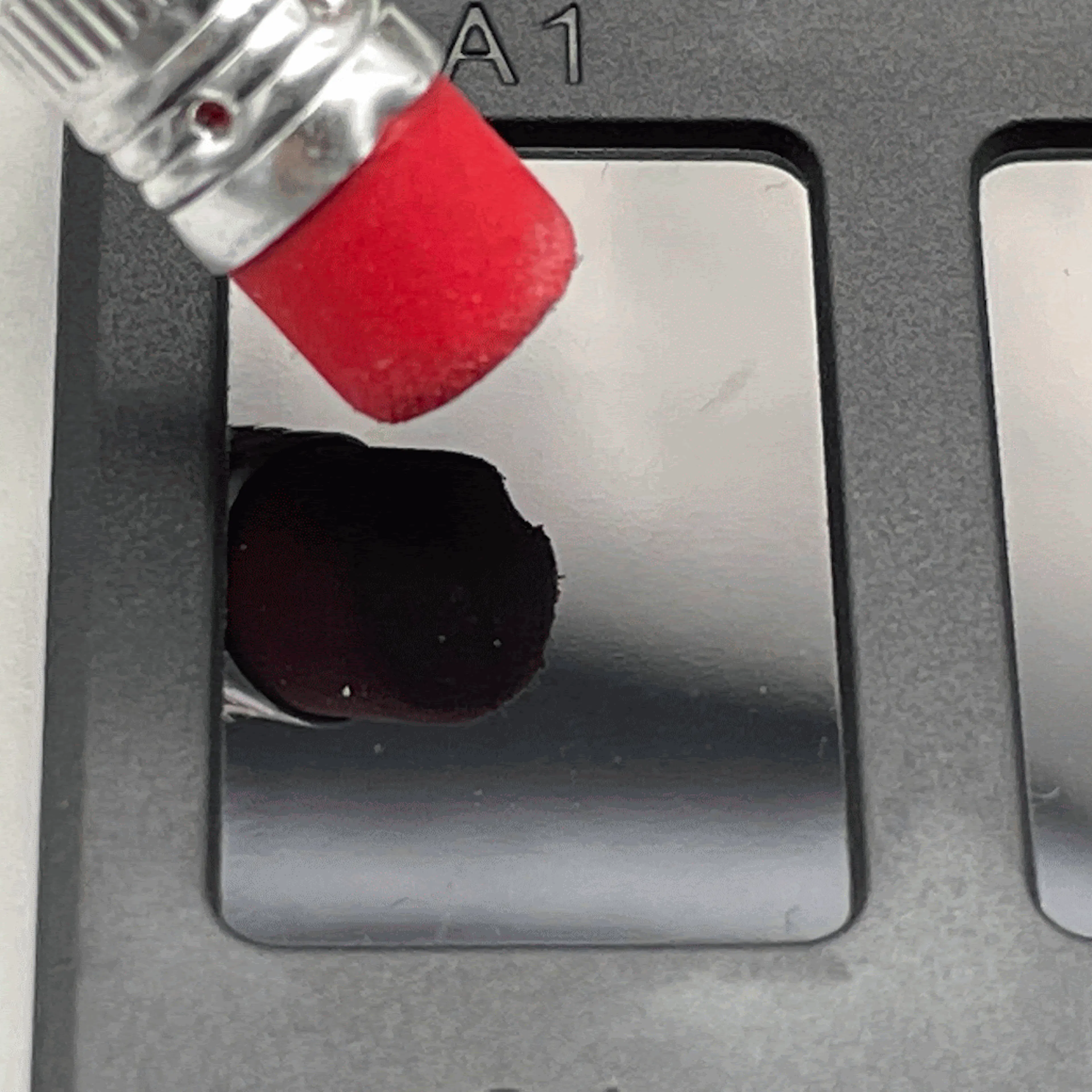

The most common finishes used include those from the Society of the Plastics Industry (SPI), which are a set of standard mold finishes starting from heavily polished (SPI A) to semi-gloss (SPI B) to fine and coarse matte (SPI C and SPI D). Where polished textures can increase a parts' cosmetic reflection or transparency on transparent polymers, matte finishes can help provide more subdued tones and even help prevent fingerprints on handled products (e.g., your laptop's frame and keyboard).
Injection molded finishes guide: SPI, Mold-Tech, and VDI 3400
Get your Free Xometry Injection Molding Finishes Card

Society of Plastics Industry (SPI) Mold Finishes
Standard SPI Injection Molding Finishes

SPI A-1
Description
Grade #3, 6000 Grit Diamond Buff
Typical Applications
High polish or transparent parts, optically clear
Surface Roughness (Ra µm)
0.012 - 0.025

Standex Engraving Mold-Tech is a standardized mold texturing option typically used for commercial or saleable goods. Mold-Tech is serialized in four series, A through D. Most commonly the Mold-Tech Series A finishes are used on products as it has a range of fine to coarse matte finishes that do not require laser, masked chemical etching, or other engineered texturing processes. Mold-Tech finishes are categorized by their serial number and texture depth. A more aggressive draft angle is needed with Mold-Tech because mold texturing has more coarse features than SPI finishes, it is recommended to add 1.5° of draft for every 0.001" of texture depth.

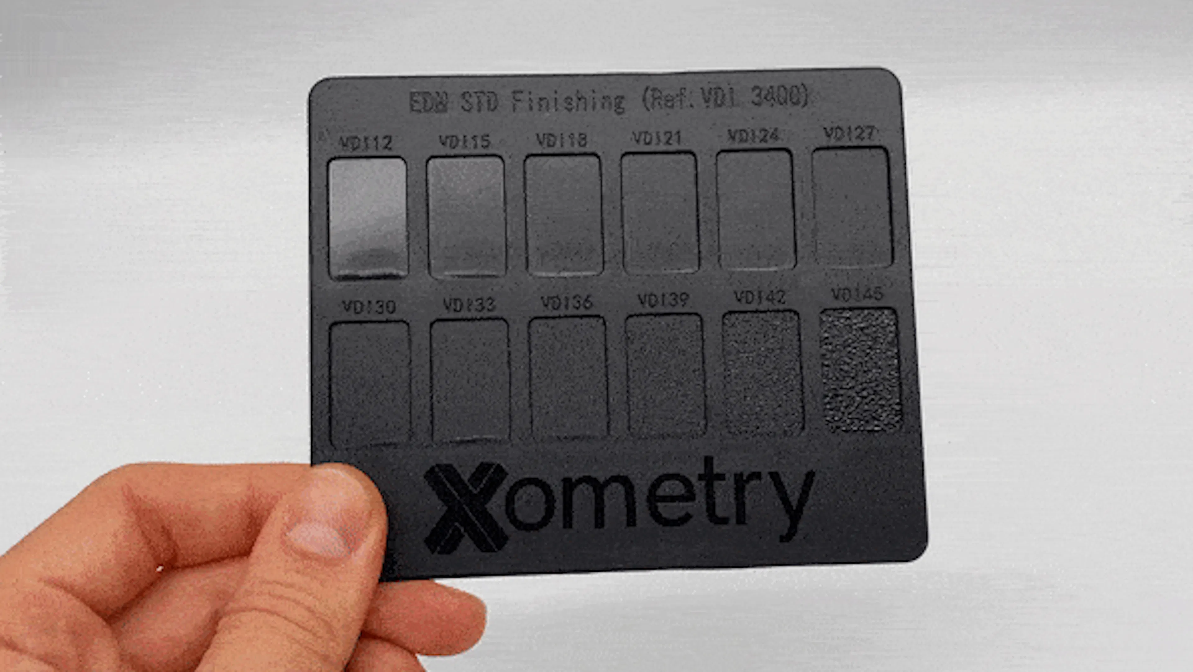

VDI 3400 Surface Finish (known as VDI surface finish) refers to the mold texture standard Verein Deutscher Ingenieure (VDI), the Society of German Engineers. The VDI 3400 surface finish is mainly processed by Electrical Discharge Machining (EDM) when mold machining. VDI is an international standard for mold texturing of matte surfaces. The EDM surface gives a fine-to-coarse grain depending on the selection. VDI is not the same as Mold-Tech, which is applied through various techniques from manual finishing to laser etching to chemical etching with patterns. However, some textures may have near equivalencies, such as SPI D-3, VDI 33, and MT-11020, all looking very similar. In similar aspects, VDI 12 and SPI C-1 are equivalent.
VDI (EDM) Mold Texture Values
