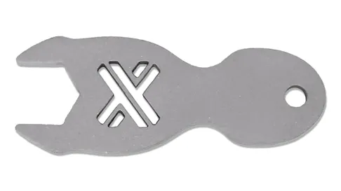

Parts will be separated, the tab will be ground off, and all burrs will be removed. Additionally, parts are cleaned to remove discoloration, surface debris, manufacturer markings, and scratches.
Parts will be separated from each other, and the source sheet and any vestigial tabs will be ground off. The area where tabs are removed may have a slightly different texture or appearance than the rest of the part.

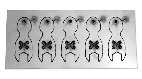

Reduce costs by receiving the parts tabbed together on the source sheet, to each other, or a support structure. You are then responsible for separating the parts from the sheet. Laser and waterjet cut parts may have fine burrs after cutting.

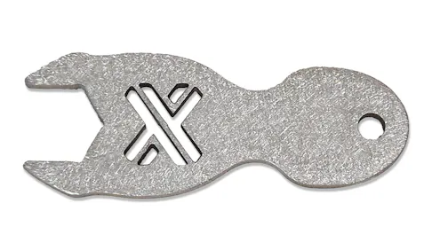

Parts are finished in a blasting cabinet with a high-pressure stream of fine glass beads, typically using 80-grit media applied between 70-100 psi. This gives the surface of the parts a uniform matte or satin-like cosmetic appearance.

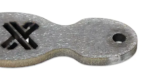

Kerf refers to the material that is burnt or cut away during laser cutting. Kerf is the gap thickness created by the laser and is usually around 0.008” with a +/- 0.004” tolerance depending on the process and material thickness.
Waterjet cutting has a stream thickness of between 0.04” to 0.05”. Think of it as a regular sharpie with medium pressure regarding detail resolution.
Xometry’s typical part tolerance is +/- 0.010” for laser cutting or waterjet cutting; this includes compensation for kerf. Small holes, thin gaps, and relief cuts may be slightly larger than dimensioned if their design is close to the kerf thickness.
Extruded materials such as metals and some plastics will have a grain direction. This is presented by linear features, which are generated as the material is created. Hardwood and wood veneer will also have a grain direction based on the growth.
Parts are weaker or may crack more easily along their grain. If grain direction is important to a part's function or cosmetics, please identify that using an attached technical drawing or notes. Otherwise, Xometry’s suppliers will use their best practices when cutting the parts.
Laser beams have a slight cone shape and will show a small taper from the top cut to the bottom face of a material. This is more exaggerated over thicker parts. Waterjet cutting will also spray in a tight cone, showing a small reverse taper from top to bottom.
In both laser cutting and waterjet cutting, there will be vertical striations on a cut surface. This differs from a CNC milled, or CNC routed edge, which will appear smoother.

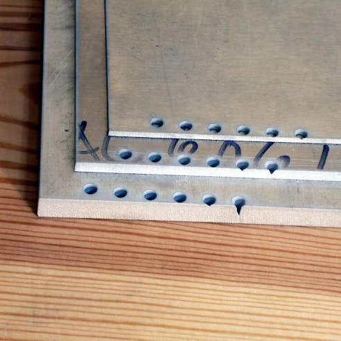

The holes a laser can cut or a waterjet can cut are rougher than a standard drill due to the edge condition. If the holes are tolerance-critical it is recommended to undersize the hole by 0.005” and post-drill the feature.
