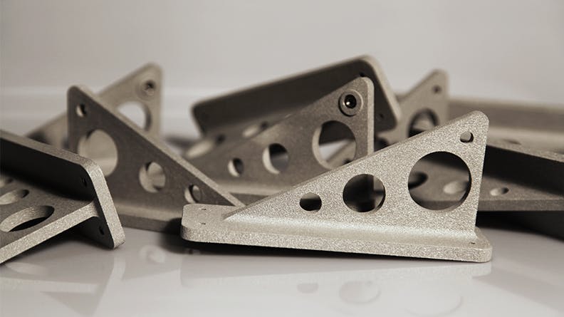

Nylon 12 Aluminum-filled (AF) produces beautiful parts due to its high metallic shine, giving it the appearance of cast aluminum. As a result of its aluminum fill, it has good stiffness and thermal conductivity. AF materials are great for showcasing models, automotive underhood mechanisms, rapid tooling, and fixtures. The material is not electrically conductive.

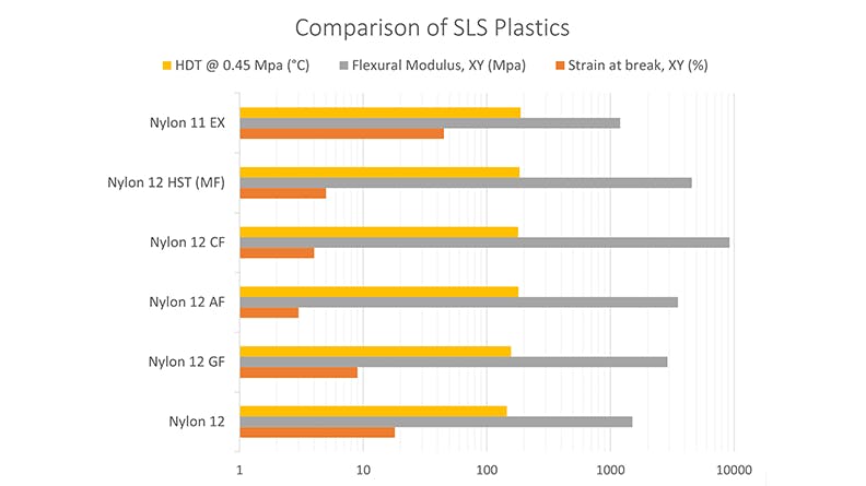

Technical Specifications for Xometry SLS Materials
MaterialsCommon NamesShore HardnessElongation at Break (%)Impact Strength, Notched (kJ/m²)
Materials
Nylon 11 EX
Common Names
Ductile plastic, PA11, Rilsan® Invent Natural
Shore Hardness
77D
45%
No break
Materials
Nylon 12 CF
Common Names
High-performance plastic, carbon-filled PA12, PA 602-CF, carbonmide
Shore Hardness
N/A
4%
5.3 kJ/m²
Materials
Nylon 12 AF
Common Names
Metallic gray plastic, aluminum-filled PA12, alumide
Shore Hardness
76D
3%
4.6 kJ/m²
Materials
Nylon 12 HST
Common Names
Heat-resistant plastic, mineral fiber-reinforced PA12, PA 620-MF
Shore Hardness
75D
3-5%
N/A

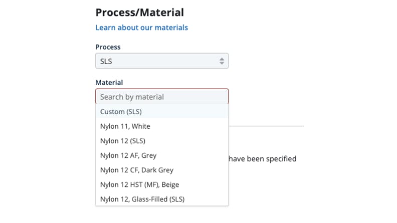

How to Get a 3D Printing Quote in SLS Nylon
Step 1: Upload your 3D model to the Xometry Instant Quoting Engine℠
Step 2: Click “Modify part” and under process, choose “SLS” from the drop-down menu.
Step 3: Select your material and add any features or notes.
Step 4: Review your price, lead time, and specifications before heading to checkout.
