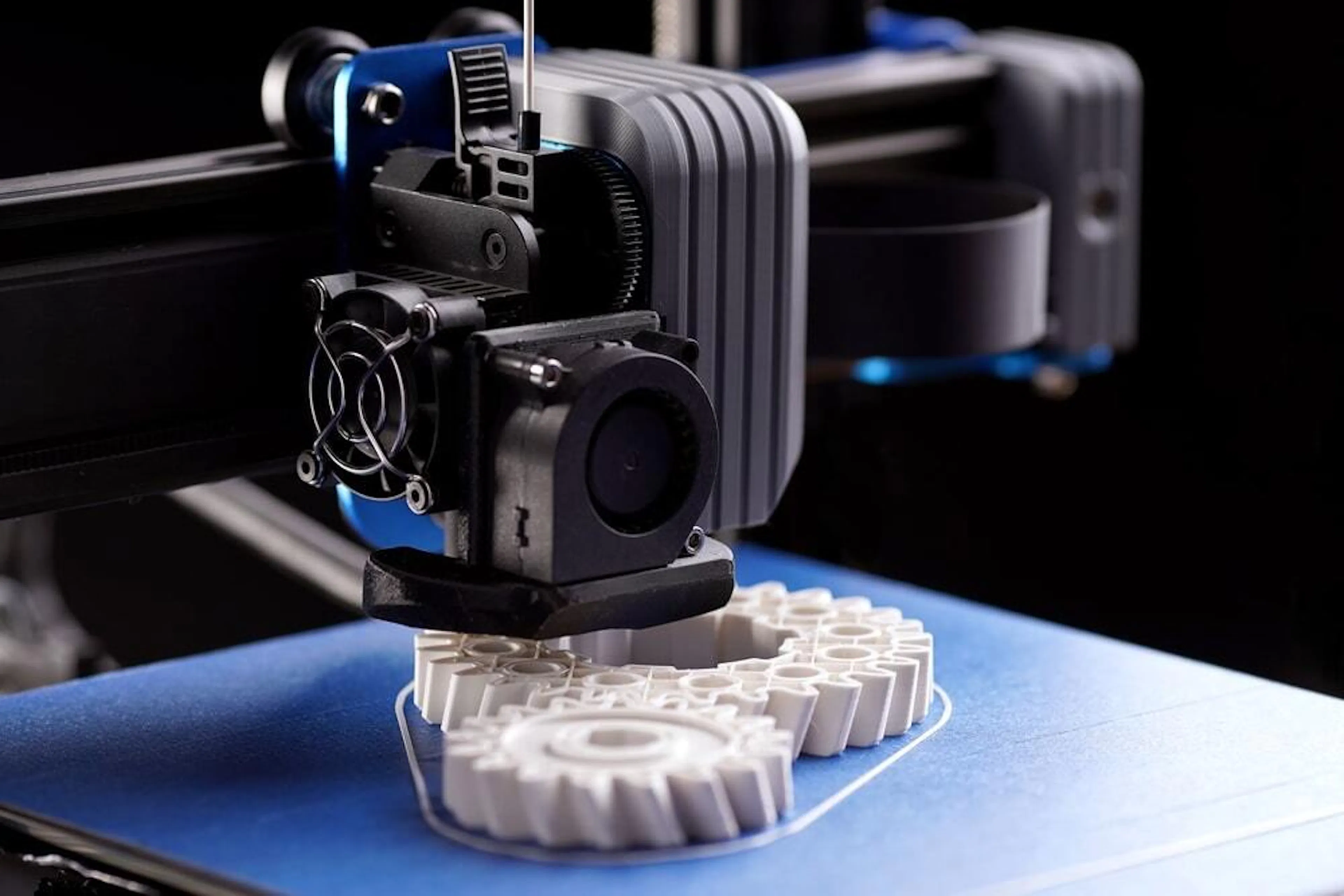

An FDM 3D printer. Image Credit: Shutterstock.com/R_Boe

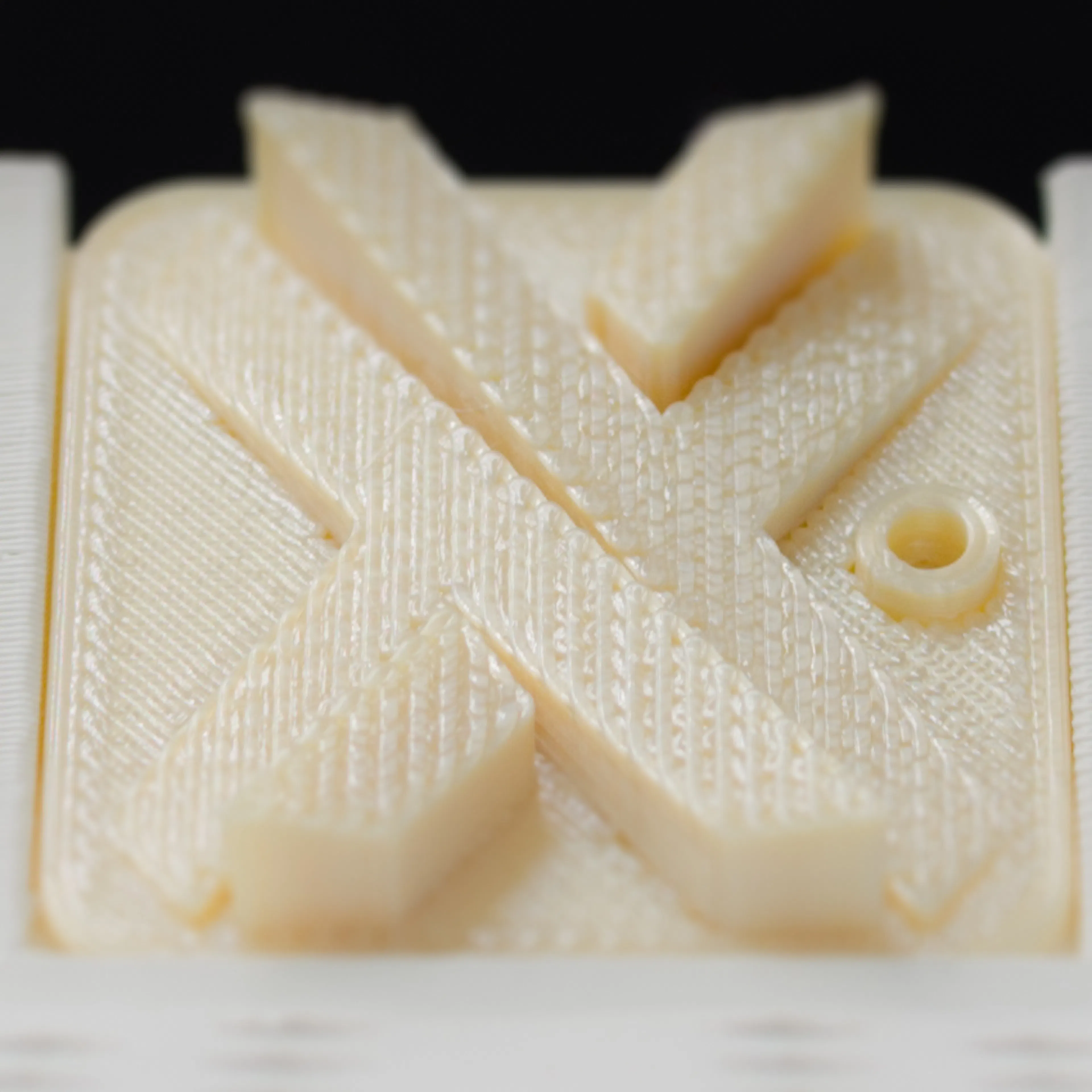

tan fdm ultem
Tan FDM Ultem

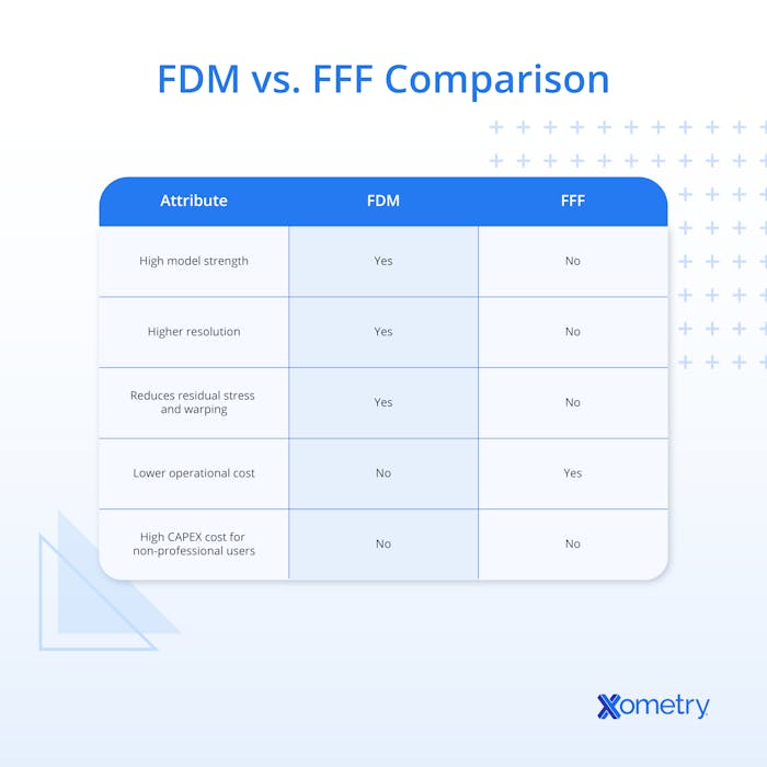

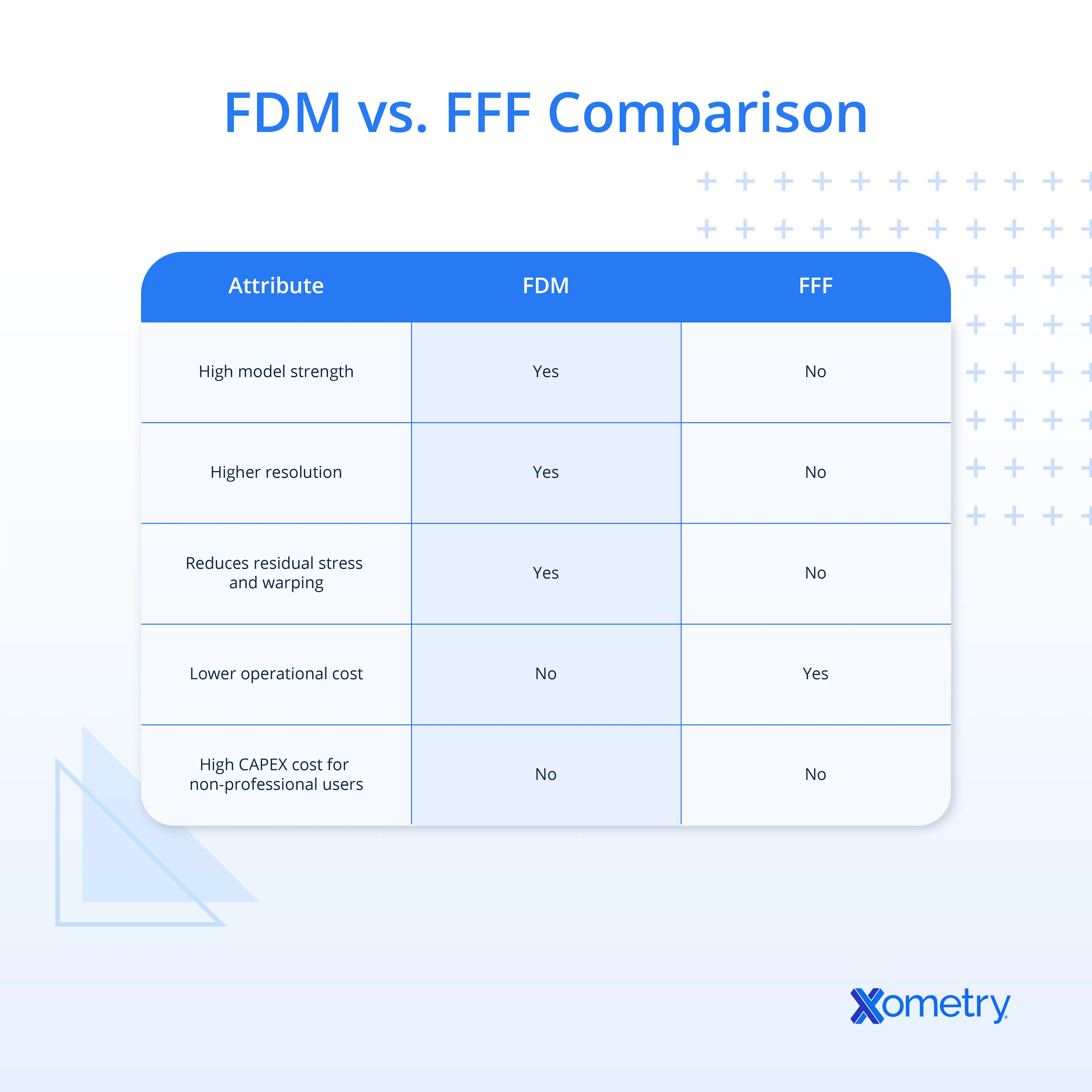

Comparison Table Between FDM and FFF
The table below compares FDM vs. FFF:
FDM vs. FFF Comparison
The critical advantages of FDM over FFF are: the resolution of the build (better-looking and more accurate models), and the reduced risk of distortion and porosity that results from a haphazard temperature environment.
