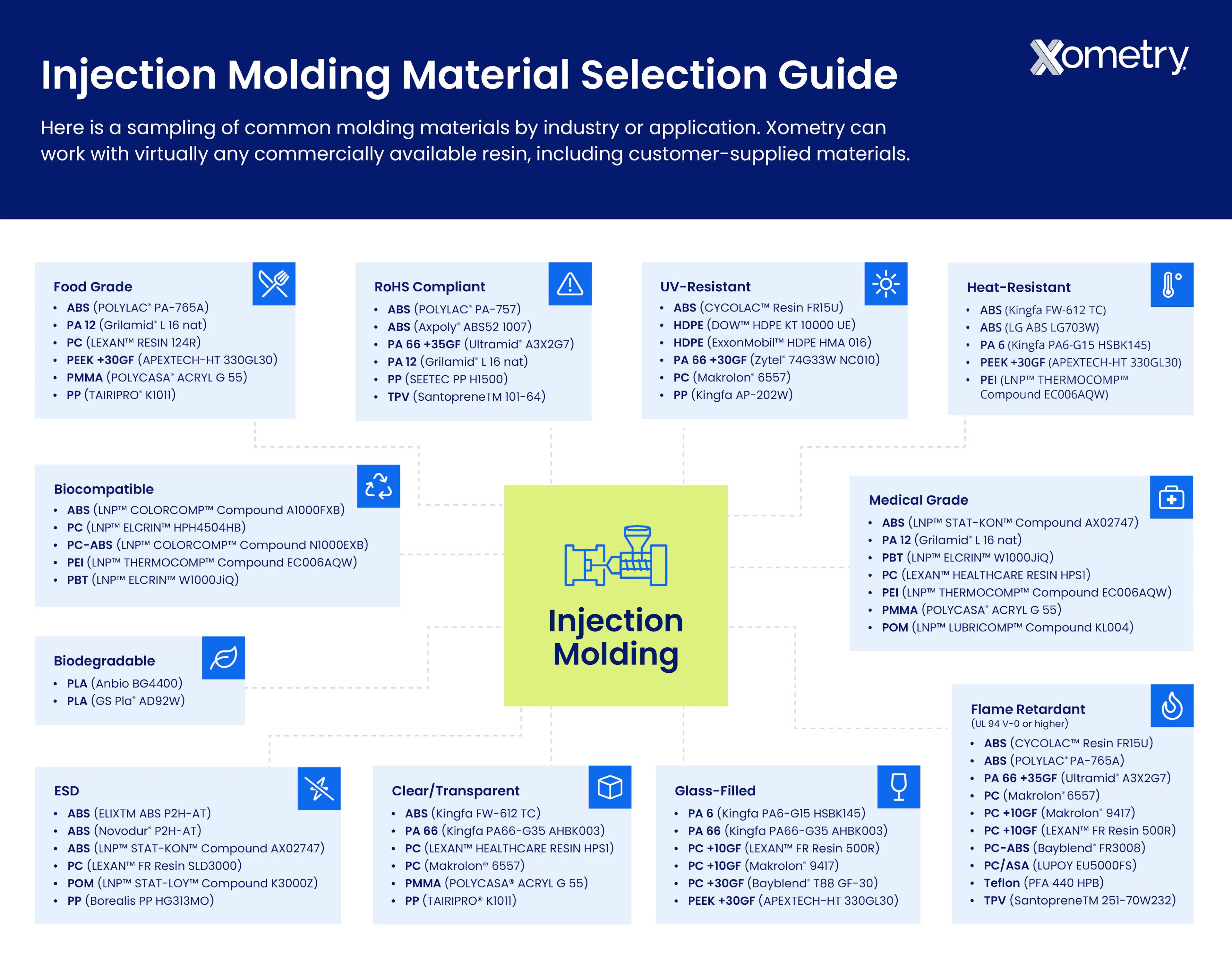

Injection molding materials
Preview of material selection guide
Material Selection GuideDownload

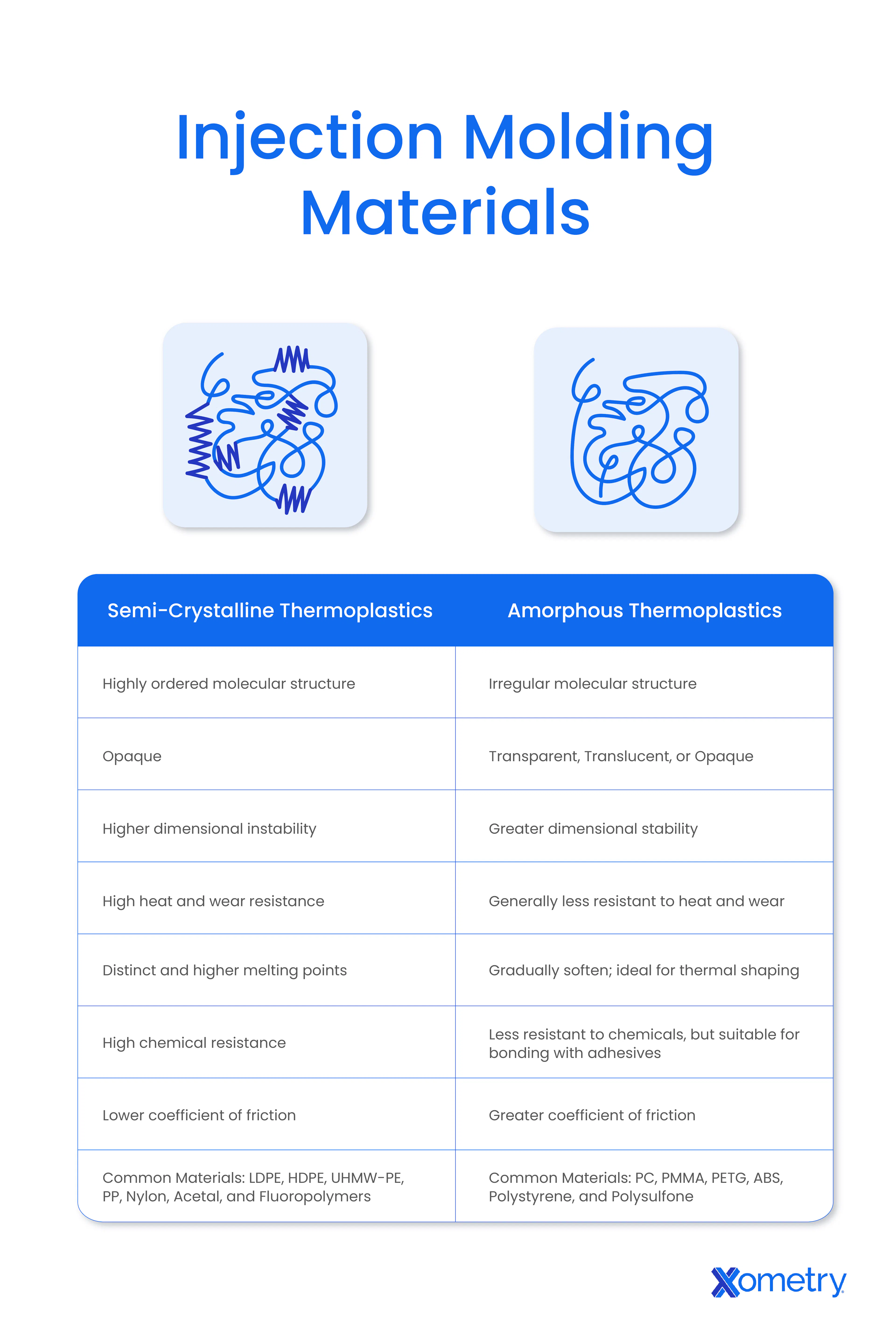

Injection Molding Materials
