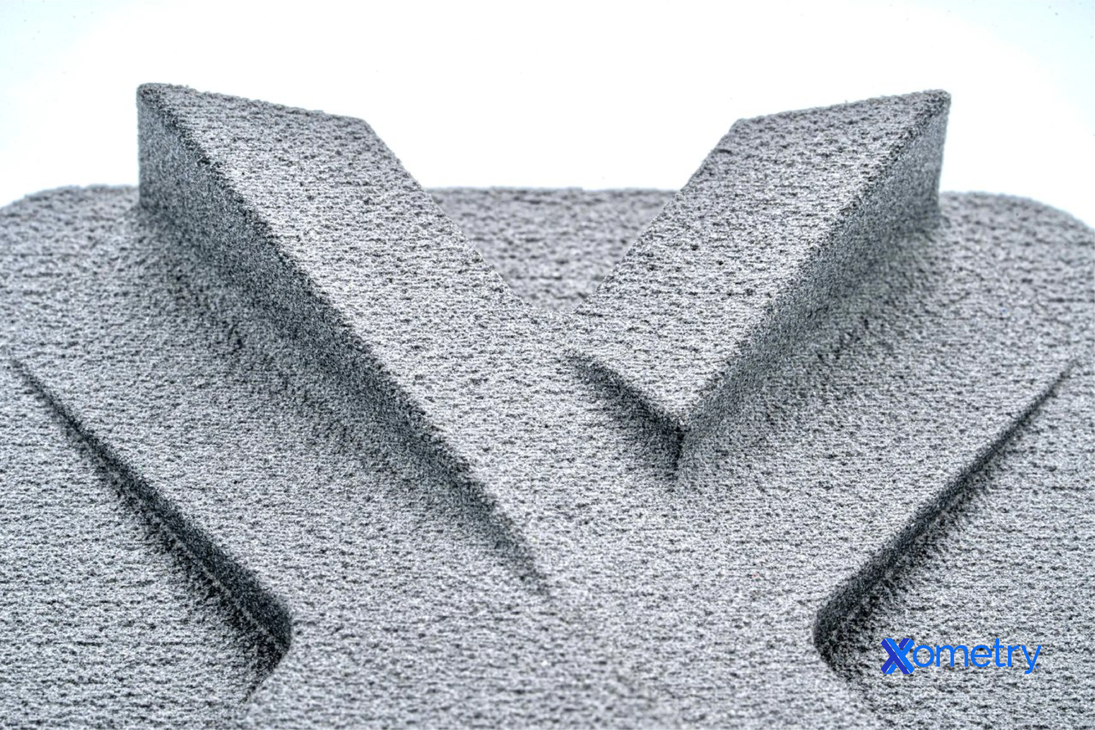

Originally developed and made commercially available in 1988 by Scott Crump, fused deposition modeling is one of the most popular methods of 3D printing today. It works by pumping a thin thermoplastic filament through a heated nozzle and depositing it layer-by-layer to make the part. It’s relatively cheap compared to MJF printing—which is more popular in industrial settings—and is usually easier to get hold of.
The beauty of FDM printers is that they are compatible with filaments from different companies, but MJF printers are limited to materials from HP. FDM does have a couple of drawbacks, too, especially when compared to MJF, which we’ll discuss later. For starters, it produces parts with a low-quality surface finish. Another disadvantage is that FDM printed parts tend to be anisotropic, meaning they’re not as strong in the z-direction because of poor interlayer bonding. We have an article on FDM 3D Printing which we recommend you check out for more information. This is an image of a part made using FDM printing:
fdm part
FDM printed part

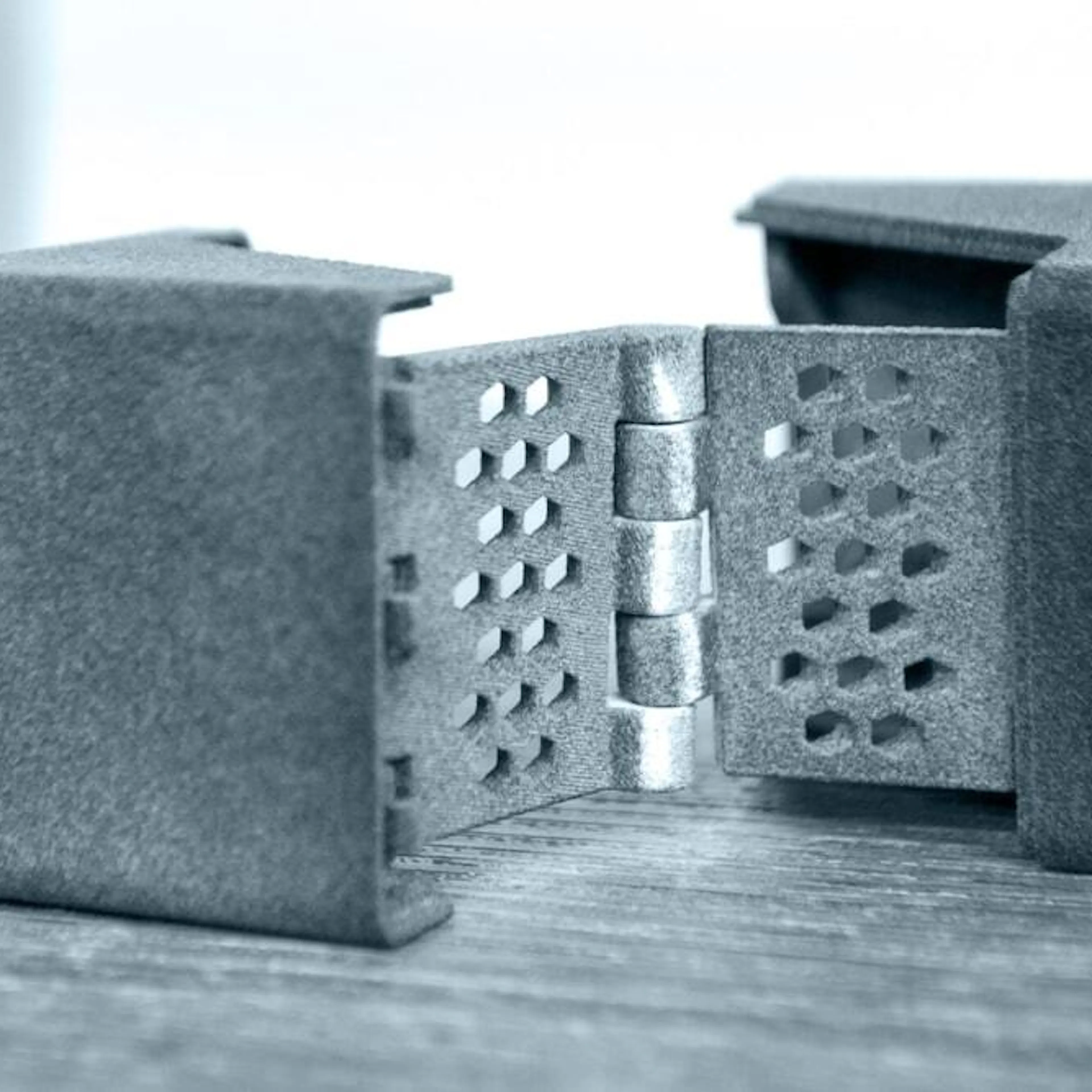

Multi-jet fusion is another type of 3D printing that was created by the company HP in 2016. It’s quite different from FDM in that it requires several steps before a part is complete, the first of which is adding a thin layer of powder to the printing bed and heating it to just under its sintering temperature. The next part is adding a fusing agent to the powder in the shape of the part’s cross-section. Then a detailing agent is added to the exterior edges to help them be sharper and more crisp.
When that’s done, a source of heat is passed over the plastic, which sinters the particles together wherever the fusing agent is. It’s pretty clear that MJF is more advanced than methods like FDM, and that’s why it’s used a lot in high productions. MJF has some further advantages when compared to FDM, including that its parts come out highly accurate and faster, and that’s partly because you can print more than one part at a time. Also, unlike FDM, MJF parts are isotropic, making them uniform when it comes to their mechanical properties, regardless of direction.
On the other side of the coin, however, MJF printers are among the most expensive types of 3D printers available today—way more expensive than the most advanced FDM printers. They also have a very limited amount of color options, and can only be dyed black, whereas FDM printers can print in lots of different colors. You can check out our article on MJF to learn more about it. The following image shows a part printed using an MJF printer:
mjf part
MJF part
