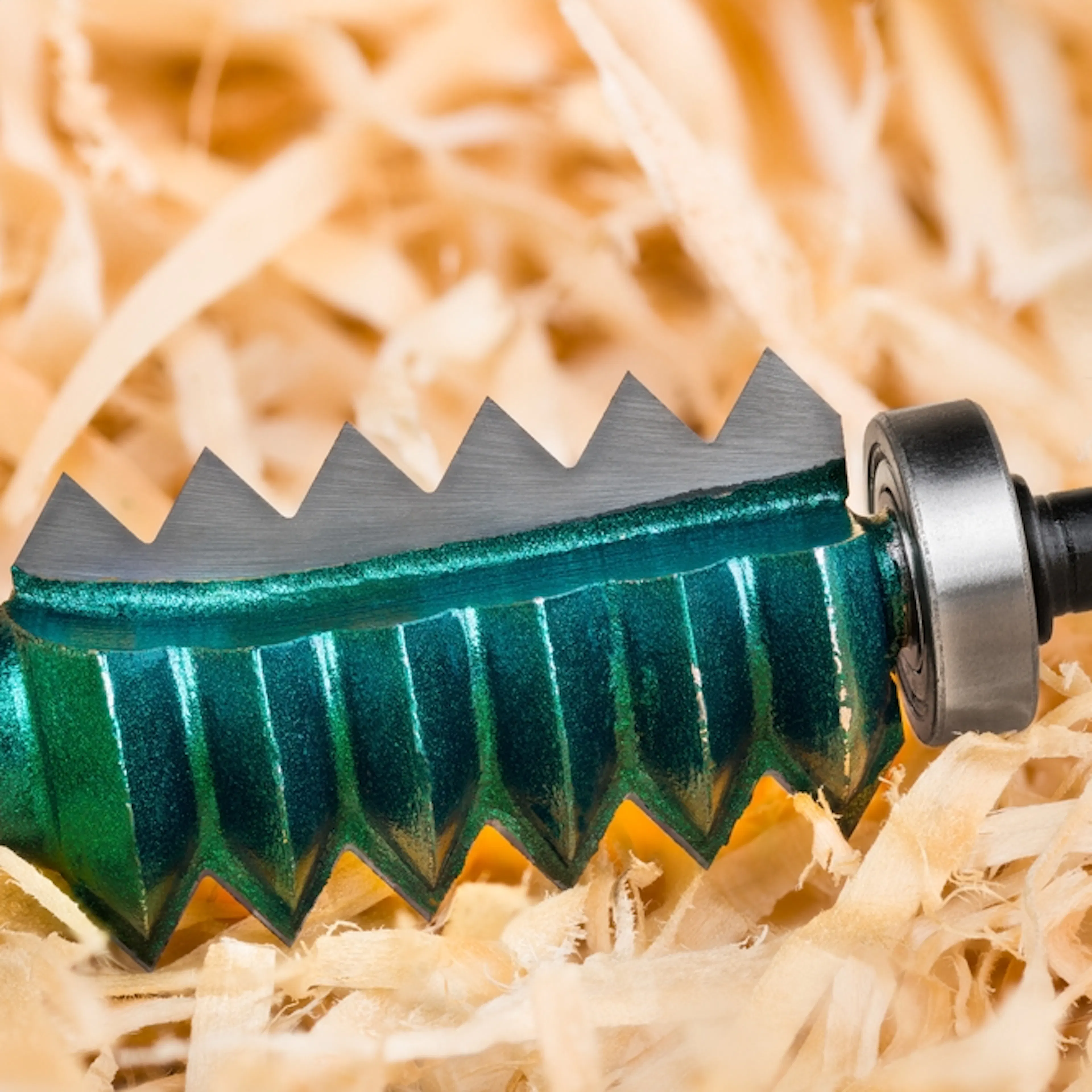

Form milling is a specialized milling technique that involves creating a cutter specifically designed for machining a particular profile. Unlike standard milling cutters, form milling cutters can be manufactured to any specific shape required for special profiles—from simple radii and bevels to intricate patterns. This makes the technique highly versatile and enables the production of complex and unique components with relatively short machine times.
This article will discuss what form milling is, how it works, its types, and its advantages and disadvantages.
What Is Form Milling?
Form milling is a manual and, more commonly, CNC milling technique used to create irregular, consistent, and generally complex contours. It involves the use of customized form milling cutters, which are designed specifically for the job at hand. These cutters are often manufactured with unique profiles that suit various applications' particular profile needs. There are also many types of standard form milling cutters, for concave and convex curves, thread profiles, edge beads (such as Roman coving), etc. Form milling is a process with applicability to high-volume production due to the time and cost involved in manufacturing custom cutters. It is also an essential tool in low-volume and high-value production of unique features and forms.
