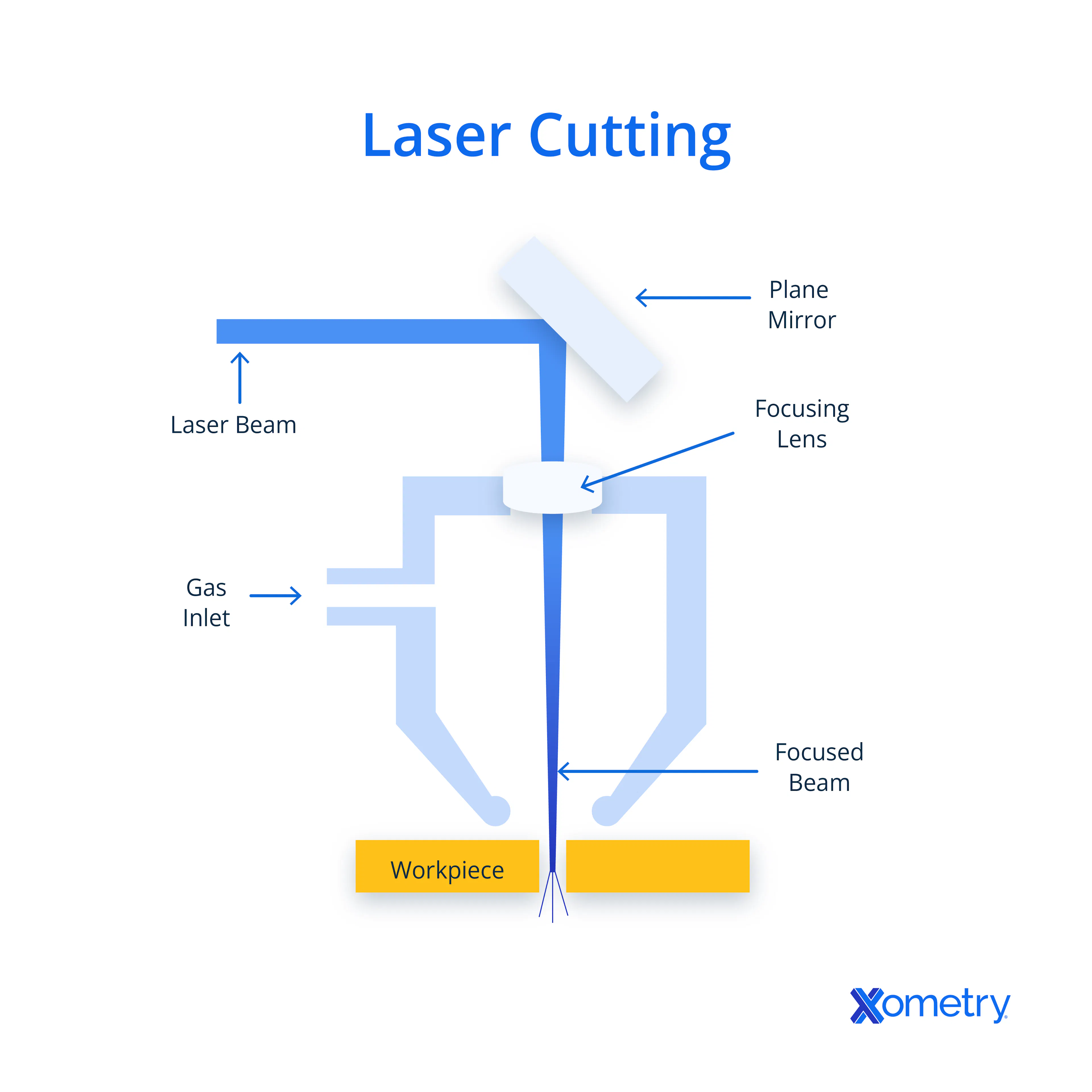

laser cutting diagram
How the laser cutting process works
