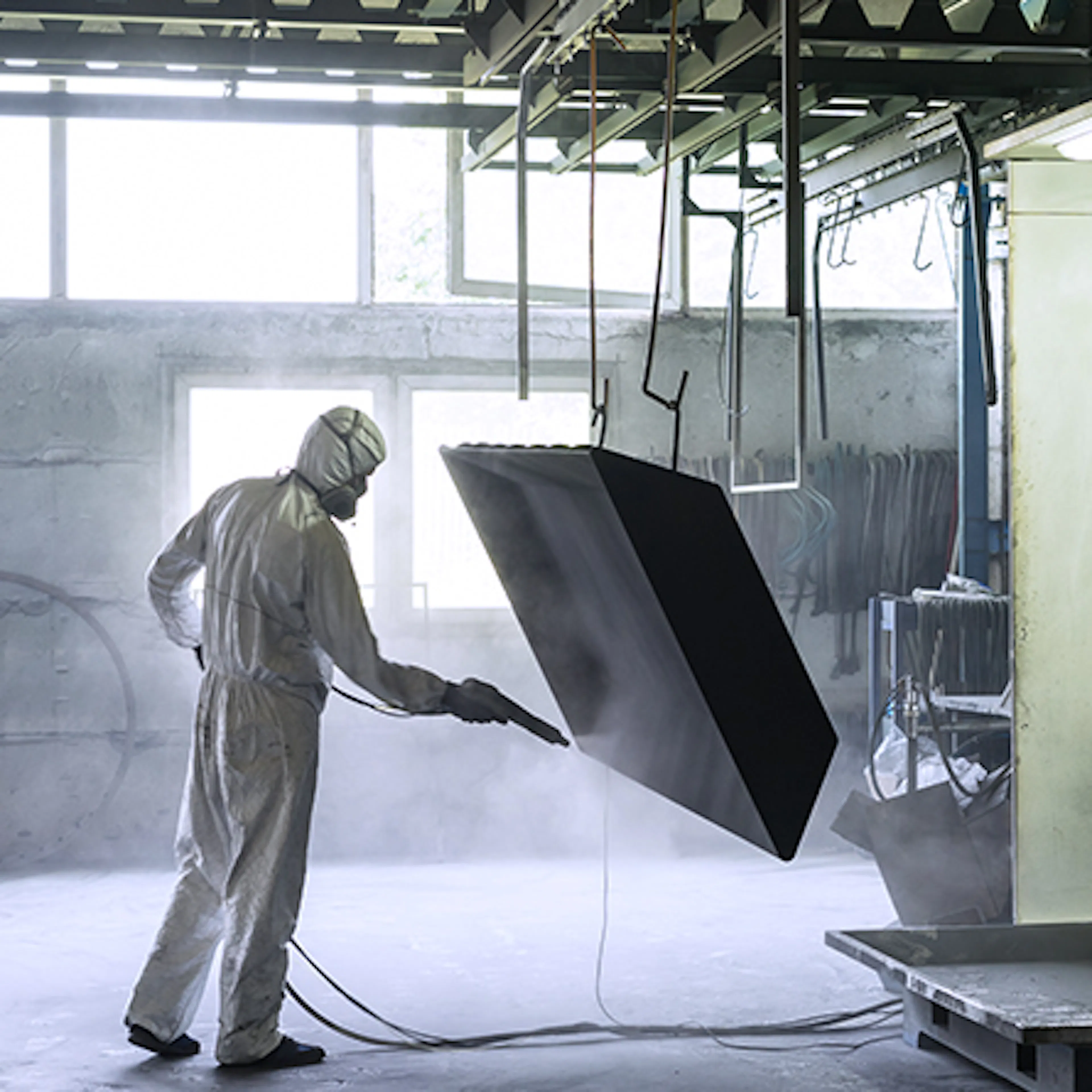

Worker Bead Blasting a Metal Box. Image Credit: FreePik.com/ keko64
Bead blasting is the projection of a blasting media onto a surface using compressed air. The beads are commonly made from glass or plastic. Many factors affect the quality of a bead blast, and neglecting any number of them can result in a poor bead blast that can ruin a beautiful workpiece.
