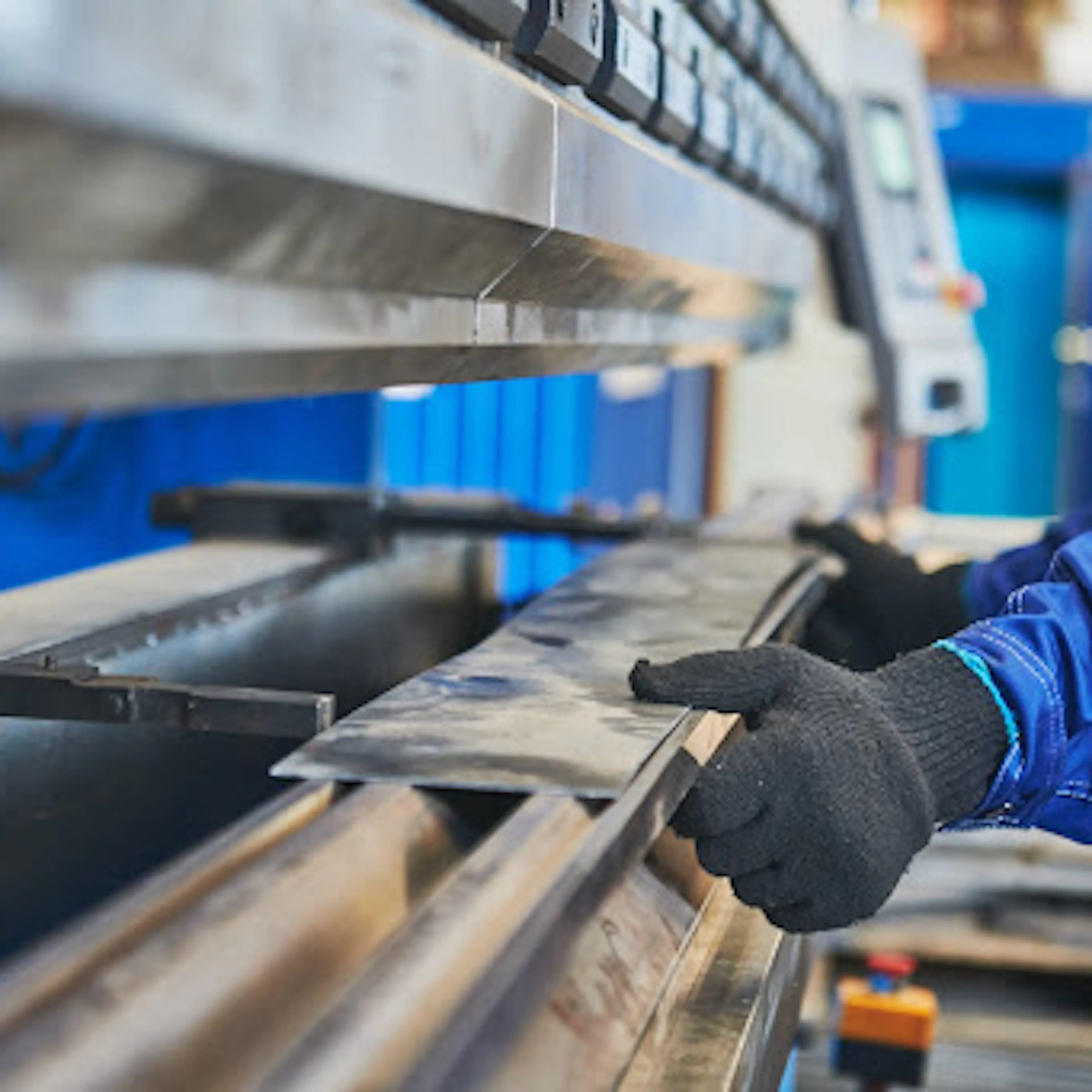

If you're working with sheet metal, you are very likely to add a bend to your part. Understanding the variables that affect an angle bend and how they can influence the quality of a bend is critical to ensuring you create a product without an out-of-spec angle bend.

Grain Direction
Sheet metals have grains. These have a direct impact on the bending process and the quality of a bend. The grain direction results from the mill’s rolling process, and grains are parallel to the rolling direction. Rolling sheet metal results in the directional alignment and stretching of metallurgical structures, forming a grain.
Bending along the grain will be easier and requires less bending force, but it is also very likely to induce cracks on the outside radius of the bend. The cracking can be reduced by increasing the bend radius. Bending transverse to the grain will require more bending force, but a tighter bend radius can be achieved before cracking appears on the outside bend surface.
Minimum Bend Radius
The minimum bend radius is a very complex variable that directly affects the quality of a bend. Not only does it vary by material type (e.g. steel, aluminum, stainless steel, etc.) but also by sheet thickness and heat treatment. A material specification sheet, available from the raw material supplier, should contain minimum bend radius advice for bends parallel and transverse to the grain.
Note that the recommended minimum bend radius will likely be different whether you’re bending parallel or transverse to the grain direction. Each material will have a minimum radius-to-thickness ratio for each grain-to-bend orientation. The fundamental principle is that thicker, harder materials will have a larger bend radius.
Springback
Anyone who’s ever bent sheet metal knows that the bend opens up, resulting in an out of spec angle bend. This can be frustrating, and understanding why this happens can help you compensate for it.
