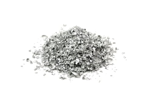

Magnesium powder. Image Credit: Shutterstock.com/Fablok
