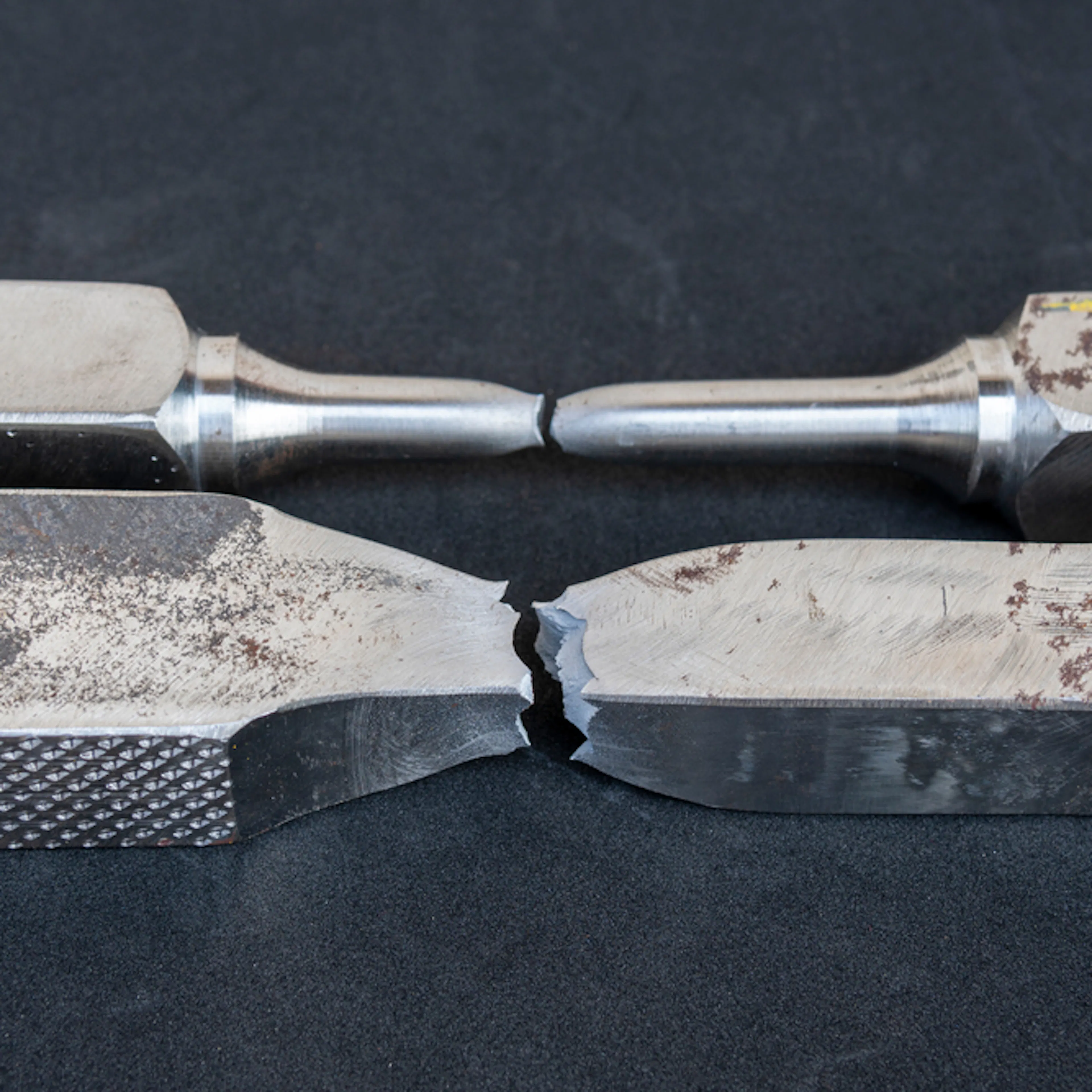

Tensile test on metal. Image Credit: Shutterstock.com/Thaweesak Thipphamon

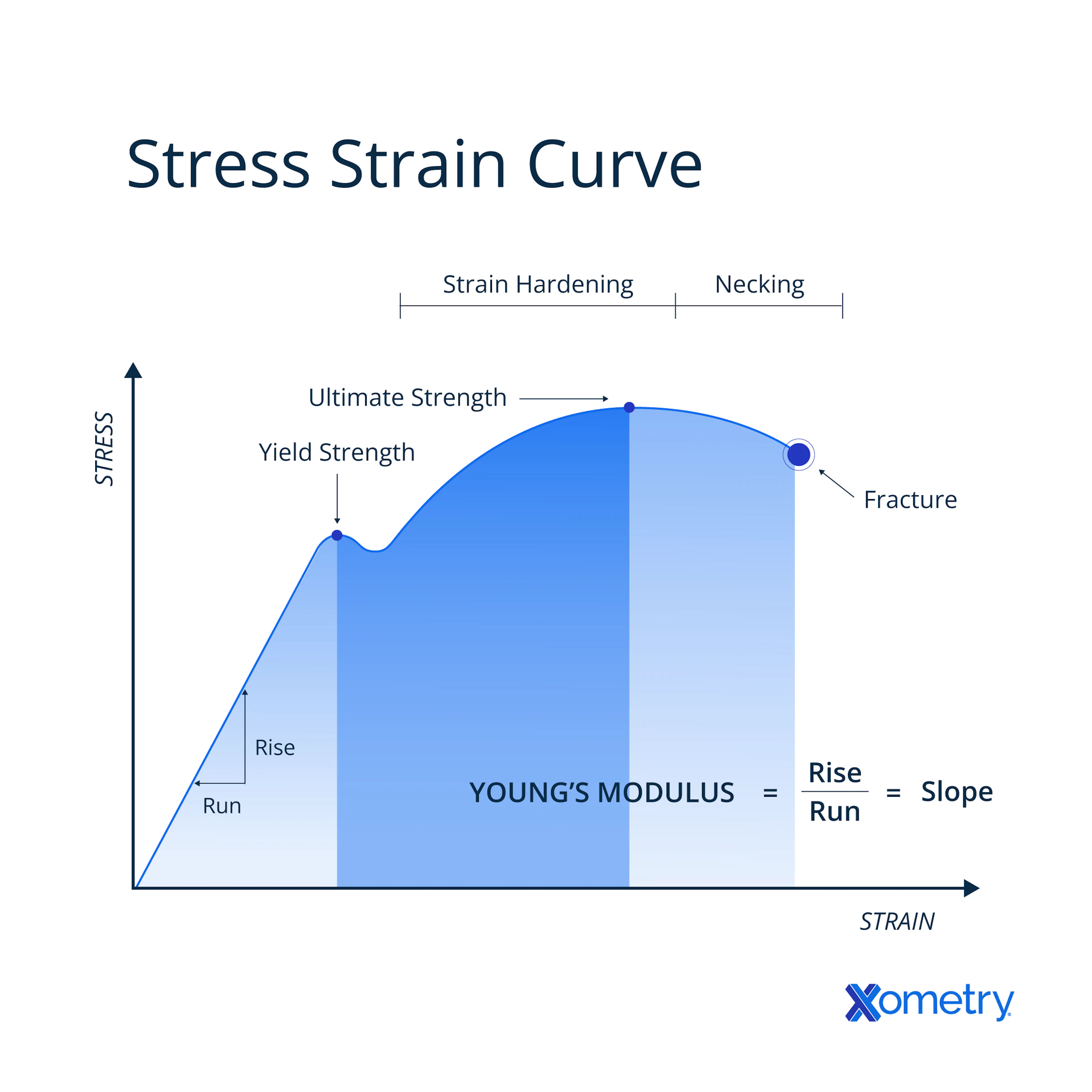

What is the Stress Strain Curve?
The stress-strain curve is a graph showing how a material deforms under a continuously increasing load. The plot places stress (force per unit area) on the vertical axis and strain (deformation ratio) on the horizontal axis. A tensile test provides the data points needed to construct the diagram. The curve reveals the mechanical behavior of the material from the initial loading stage to the final failure point. Key regions identified on the graph include the elastic region (linear slope), the plastic region (curved section), and the fracture point (the break). The shape of the curve distinguishes between ductile materials (copper) and brittle materials (glass). The modulus of elasticity is determined by the steepness of the initial straight line. Yield strength marks the transition where permanent deformation begins. The graph serves as a roadmap to understanding the strength and toughness of a substance. Precise plotting allows engineers to determine the maximum capacity of a part. Visualizing the relationship between force and strain is a requirement for safety analysis. Every material produces a unique signature on the graph. The diagram is a requirement for modern material characterization.
How Does the Stress Strain Curve Describe Material Behavior?
The stress strain curve describes material behavior by illustrating the transition through different mechanical states under a load. The initial linear portion represents the elastic stage, where the substance returns to its original shape upon unloading. The slope of the line indicates the stiffness (Young's modulus) of the material. The curve reaches the yield point as the load increases, marking the start of the plastic region. The plastic stage involves permanent deformation due to changes in the crystal structure (dislocation movement). Ultimate tensile strength represents the maximum stress (force per unit area) the material withstands. The final point on the graph indicates the fracture region where the material breaks. Engineers analyze the area under the curve to measure toughness (energy absorption). A wide plastic region signifies a ductile material that bends before breaking. A short curve characterizes a brittle substance that fails suddenly. The graph provides a comprehensive overview of the ability of the material to handle pressure failure. Accurate interpretation of the curve is a requirement for mechanical part design.
Does the Stress Strain Curve Show Elastic?
Yes, the stress strain curve shows both the elastic and plastic regions of material behavior. The initial straight line on the graph represents the elastic region where the relationship between stress and strain remains linear (Hooke's Law). The material behaves like a spring in the section and recovers its size when the load is removed. The yield point signifies the boundary where the linear behavior ends. The curved region following the yield point represents the plastic stage. The plastic region shows permanent deformation where the substance undergoes an irreversible change in shape. The distinction helps predict permanent deformation during the design phase. Engineers use the distinction to set safe operating limits to machinery (turbines) and structures (columns). Accurate visualization of the stages prevents the accidental overloading of components. Understanding the shift from reversible to permanent change is a requirement for structural safety. The curve indicates macroscopic yielding; plastic deformation in metals is primarily due to dislocation motion.

the Stress-Strain curve

Stress strain curves are generated through controlled mechanical testing in a specialized laboratory environment. A universal testing machine (UTM) applies a continuous force to a standardized specimen of the material. The equipment pulls (tension) or pushes (compression) the sample at a constant rate. Load cells measure force, not stress; stress is calculated from force divided by cross-sectional area. Simultaneously, deformation sensors (extensometers or strain gauges) track the change in length of the specimen. The raw data points are recorded continuously by a computer system connected to the sensors. The recorded force is divided by the original area to find stress once the test is complete. The change in length is divided by the original length to find strain. The coordinates are plotted to form the characteristic shape of the material behavior curve. The process follows strict international standards to ensure the repeatability of the results. Detailed data collection provides a high-resolution view of the mechanical response of the substance. Load and deformation are recorded continuously to ensure the data is accurate.
What Testing Methods Are Used To Create Stress-Strain Curves?
The data is recorded and plotted to form the curve using tensile, compression, and torsion tests. Tensile testing involves pulling a sample until it fractures and remains the industry standard for determining material properties. The process records how the material elongates under a pulling force. Compression testing pushes a sample together and is used to test materials (concrete or stone) that carry heavy weights. Torsion testing twists the specimen to measure shear properties. Load cells measure force in all tests, but extensometers are primarily used in tensile tests; torsion uses angular measurement devices, and compression may use displacement sensors. Data points are recorded continuously to ensure the resulting curve captures every transition in behavior. Standardized specimens are used to ensure the failure occurs in the monitored section. The choice of the test depends on the expected load in the real-world application of the part. Accurate measurements provide the necessary data for structural analysis and material certification. High-precision equipment ensures that the resulting curve reflects the performance of the substance. Controlled mechanical testing provides a reliable map of material strength.
Is Tensile Testing Required To Generate the Curve?
Yes, tensile testing remains the industry standard to generate the most comprehensive stress strain curve for ductile materials. The procedure involves pulling a standardized sample until the sample reaches the point of fracture. Other mechanical tests, like compression or bending, generate stress strain data. The tensile test provides detailed information about the elongation and necking behavior. Industry standards define the specific requirements for conducting the test. The resulting diagram identifies the yield point, ultimate strength, and ductility of the substance. Tensile testing reveals properties difficult to measure in other loading modes. Engineering handbooks publish data derived from tensile experiments for design calculations. The data is plotted to form the characteristic curve used by engineers globally. Compression tests are used on brittle materials that do not stretch. The tensile test provides the baseline for characterizing the strength of metals and polymers. Precise execution of the test ensures the accuracy of the resulting material behavior model.

What Are the Stages of the Stress-Strain Curve?
The stress strain curve consists of several distinct stages that represent the mechanical response of a material to an increasing load. Understanding the phases is a requirement for predicting how a part performs in real-world conditions.
  • Elastic Stage: The material undergoes reversible deformation, where the material returns to the original shape after the load is removed. The phase follows a linear relationship between stress and strain (Hooke’s Law). The stage represents the stiffness of the atomic bonds.
  • Yielding Stage: The material reaches a limit where permanent deformation begins to occur. Atomic layers slide past each other irreversibly. The point marks the transition to the plastic region.
  • Plastic Stage: The material deforms permanently without a significant increase in load in specific cases. Dimensional changes occur as the microstructure shifts. The phase demonstrates the ductility of the substance.
  • Strain Hardening: The material becomes stronger as the crystal structure undergoes further deformation. The curve rises as the resistance to further stretch increases. The process is common in manufacturing to strengthen metals.
  • Necking Stage: The material begins to thin out at a localized point of the specimen. After necking begins, engineering stress decreases due to area reduction, while true stress may continue to increase. The stage leads directly to the final failure.
  • Fracture Stage: The material physically breaks at the necked region. The point marks the total failure of the component. The coordinate represents the end of the test.

How Do You Read a Stress-Strain Graph?
Read stress on the vertical axis and strain on the horizontal axis to understand material performance. Start at the origin, where both values are zero, and follow the line upward. The initial straight section shows the elastic region where the material recovers its shape. The steepness of the line indicates the stiffness of the material. Locate the yield point where the line begins to curve, marking the start of permanent deformation. The plastic region follows, showing how the material stretches under continued load. Find the highest point on the curve, which represents the ultimate tensile strength. The curve drops toward the fracture point where the material breaks after the peak. The shape and length of the curve reveal the ductility and toughness of the substance. A ductile material typically shows a long plastic region with significant strain before fracture. A short, steep curve characterizes a brittle substance. Key points like yield, ultimate strength, and fracture reveal the limits of the part. The curve shape reveals material properties. Accurate reading prevents the misuse of materials in industrial applications.
What Do the Axes and Key Points Represent on the Graph?
The axes and key points on a stress strain graph represent the fundamental mechanical properties and limits of a material. The y-axis represents stress, and the x-axis represents strain. The origin shows the state of the material before any load is applied. The initial linear slope represents Young's Modulus, which indicates the stiffness of the substance. Key points include yield strength, which is the limit of reversible deformation. Ultimate tensile strength is the peak of the curve, representing the maximum stress the material withstands. The fracture point marks the breaking stress and strain, representing the end of the test. Ductility is determined by the total strain at the moment of fracture. Toughness is represented by the total area under the curve. The markers are used by designers to set safety margins for mechanical parts. Accurate identification of the points prevents the overloading of structural systems. The graph serves as a tool for material comparison and engineering analysis. The points indicate material limits and guide the design process.
Can a Stress-Strain Graph Predict Material Failure?
Yes, a stress strain graph can predict material failure by identifying the critical points where a substance loses its structural integrity. The graph shows where failure occurs by marking the ultimate tensile strength and the final fracture point. The ultimate tensile strength indicates the maximum stress the material can withstand. Localized necking begins once the peak is passed, signaling imminent breakage. The fracture point marks the breaking stress where the material physically separates. Engineers use the values to establish safety factors, ensuring that the working stress stays below the failure limits. Monitoring the curve helps avoid dangerous load conditions that lead to sudden collapse. Brittle failure is predicted by a lack of a plastic region, while ductile failure is preceded by stretching. Accurate data from the graph allows for the prevention of accidents in construction and manufacturing. The diagram provides a reliable way to assess the risk of breakage in real-world applications. Engineers use the fracture point to avoid unsafe loads.
What Are the Different Regions of the Stress-Strain Curve Graph?
The different regions of the stress strain curve graph are the elastic, plastic, and fracture regions. Each region represents a distinct material response to the applied force. The elastic region is the initial phase where the material returns to its original shape upon unloading. The relationship between stress and strain is linear in the section. The plastic region follows the yield point and shows permanent deformation. Plastic deformation occurs primarily through dislocation motion within the crystal structure. Strain hardening and necking occur as the material nears its limit in the plastic region. The fracture region is the final part of the curve where the material breaks. Transitioning between these regions signals a behavioral change. Recognizing these phases helps engineers design structural systems that remain safe under peak loads. The diagram serves as a map to the performance of any substance. Precise identification of the regions prevents the misuse of materials in industrial applications. Each region represents a distinct material response.
How Are Plastic and Fracture Regions Defined?
The plastic and fracture regions are defined by the permanent change and final failure of a material. The plastic region starts immediately after the yield point, where the material can no longer return to its original shape. Plastic deformation in metals occurs primarily through dislocation motion, while polymers may deform through chain alignment and sliding. Elongation occurs significantly in the section of ductile materials. The plastic region includes the peak of the curve, known as the ultimate tensile strength. The fracture region begins after the ultimate strength is reached, and localized necking occurs. The engineering stress decreases after necking due to area reduction, while true stress may continue to increase. The fracture point itself is the coordinate where the specimen breaks into pieces. The regions are used to evaluate the ductility and toughness of a substance. Engineers analyze the plastic behavior to determine if a part provides a warning before failing. Fracture data is used for failure analysis and fracture mechanics.
 The total area in the regions determines the energy absorption capacity of the part.
Does Each Region Indicate a Change in Material Behavior?
Yes, each region of the stress strain curve reflects a different mechanical response and change in the internal behavior of the material. Elastic is reversible, plastic is permanent, and fracture is failure. The shift from one region to the next signals that the material has reached a physical limit. Strain hardening in the plastic region shows that the material becomes more resistant to further deformation. Necking indicates that the material has begun to fail locally due to area reduction. The fracture region marks the complete separation of the material structure. Each region reflects a different mechanical response and behavioral change. Recognizing these changes is critical in design to avoid permanent damage to parts. High-stress parts must remain in the elastic region to ensure long-term functionality. Safety margins are calculated based on the proximity of the operating load to the plastic transition. Proper understanding of these shifts prevents catastrophic failures in engineering systems.
