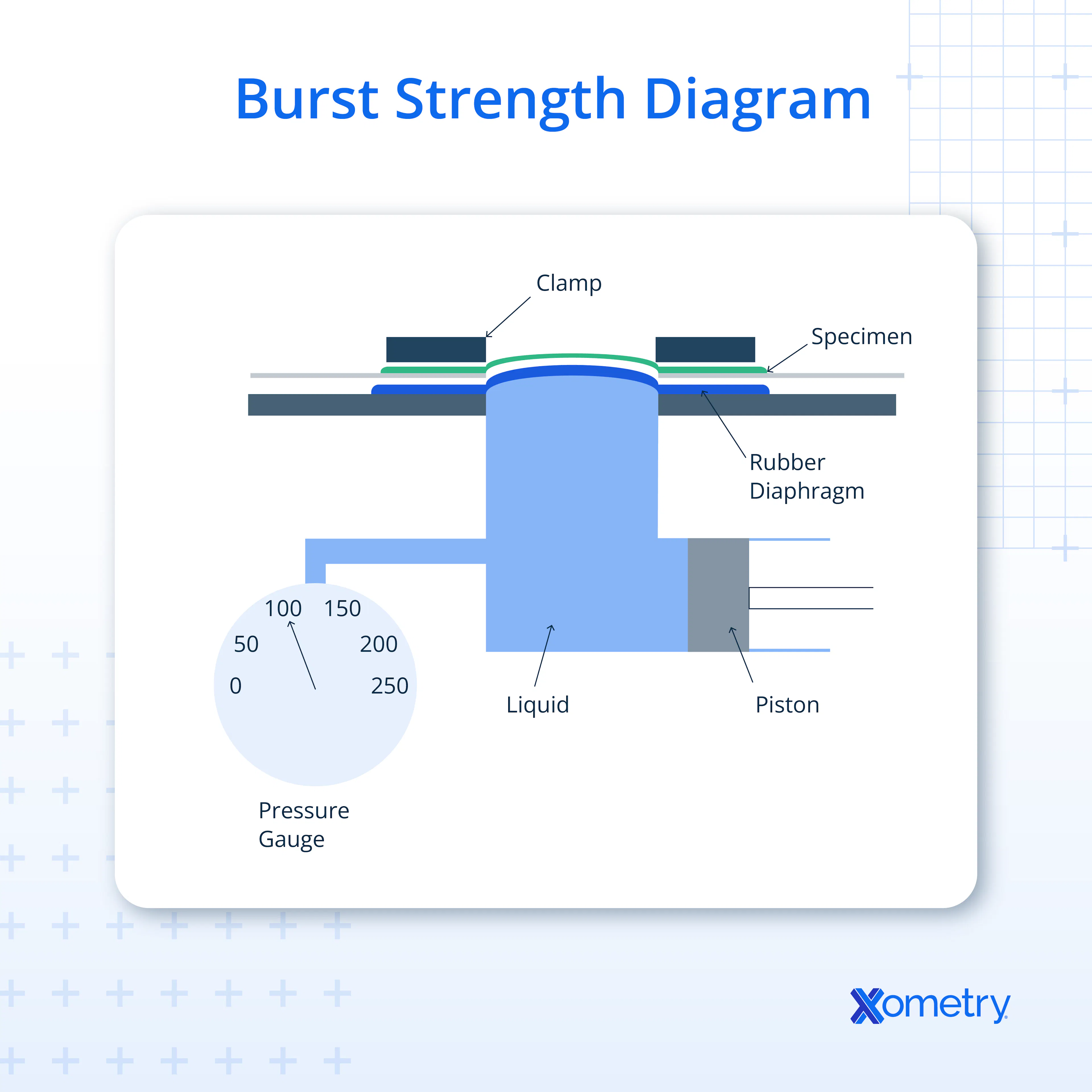

A material’s burst strength is the maximum pressure it can withstand before rupturing. It’s measured in PSI (pound-force per square inch) or kPa (kilopascals), depending on the standard used. When we say “bursting,” we mean rupturing to the extent of failure. The reason it’s called bursting and not, let’s say, breaking is because pressure is involved, so when these parts do fail, they tend to produce a bit (sometimes a lot!) of an explosion. Think of an over-inflated balloon or a full soda can if dropped on the floor.
An illustration of a burst strength diagram.
How Is Burst Strength Measured?
Burst strength is measured using a hydraulic burst strength tester. A sample is first prepared by cutting a circular piece of the material to be tested. The sample is then placed on the rubber diaphragm of the burst strength tester. After this, pressure is gradually applied until the sample bursts. The pressure at which the sample bursts is the burst strength of the material.

What Machine Is Used for Burst Strength Testing?
To test a material’s burst strength, hydrostatic pressure is applied to a sample of it until it bursts. There are different types of pressure depending on what’s being tested. These are:
  • Hydraulic: Uses liquid, like oil or water, to apply force to a material externally
  • Pneumatic: Similar to hydraulic pressure but uses compressed air or gas
  • Internal pressurization: Uses fluid or gas inside packaging
  • Internal air pressure: Similar to internal pressurization but just uses air
For paper, a version of the test, known as a Mullen test (after its inventor, J.M. Mullen), is used, which entails applying hydraulic pressure to a rubber diaphragm, which then transfers the force to the sample until it bursts.
The specific machine used to test this is simply yet aptly named a burst strength tester. These devices are widely available and have everything needed to do the test, but they must be properly calibrated beforehand for an accurate result. The device consists of:
  • A sample holder that clamps and holds the material in place
  • A plunger used to apply force to the material (often a diaphragm)
  • A hydraulic or pneumatic system to provide the pressure
  • An analog or digital pressure indicator that shows the amount of pressure put on the sample (can be shown on a computer screen as a graph)
  • The controls (buttons and knobs) to operate everything, although some testers nowadays are fully automated and need minimal human intervention
To perform a burst strength test, you’ll need a controlled environment, as temperature and humidity can affect the strength of many materials, like paper. Since there’s some bursting involved (no surprise there), appropriate safety precautions should be taken, i.e., wearing PPE and using shielding. You’ll also need to be fully trained on the method, the equipment, and the relevant standards, some of which can be found in the table below.
