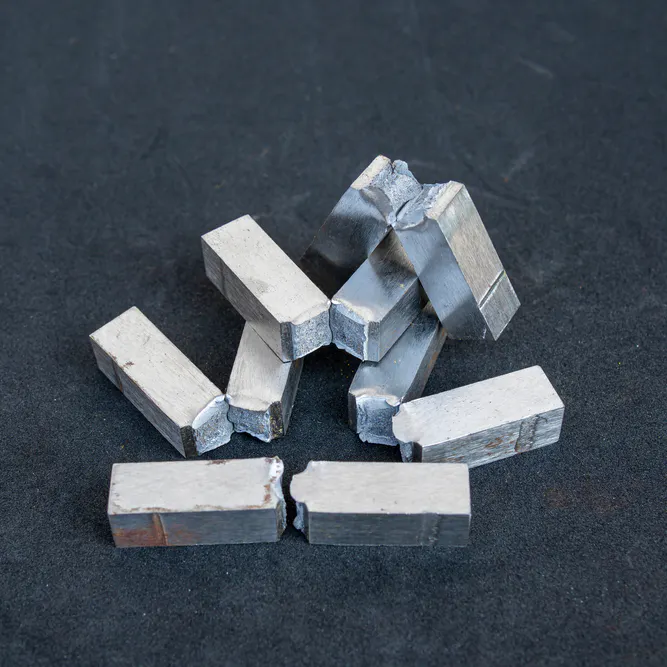

1. Charpy
The Charpy impact test, also known as the V-notch test, is a type of impact test where a weighted pendulum hammer is released from a specified height and strikes the part. A Charpy impact testing apparatus, a device with a pendulum with various locking points at specified heights and a fixture to hold the test specimen, is used to determine Charpy impact strength.
The standard test specimen is described in ASTM E23. It has a V-shaped notch cut into it. It is oriented so that it is simply supported on both ends horizontally and so the hammer strikes the face opposite the notched surface. The difference between the initial height of the pendulum and the height it reaches during the pendulum’s continued travel after striking the test specimen is used to calculate the energy absorbed by the material on impact. This is because it is assumed that all the potential energy before the pendulum is released is converted into kinetic energy when it strikes the specimen.
The Charpy impact test is most commonly used for ductile materials such as metals and thermoplastics. The test can be conducted at different temperatures and is often used to determine the ductile-to-brittle transition temperature of a material.

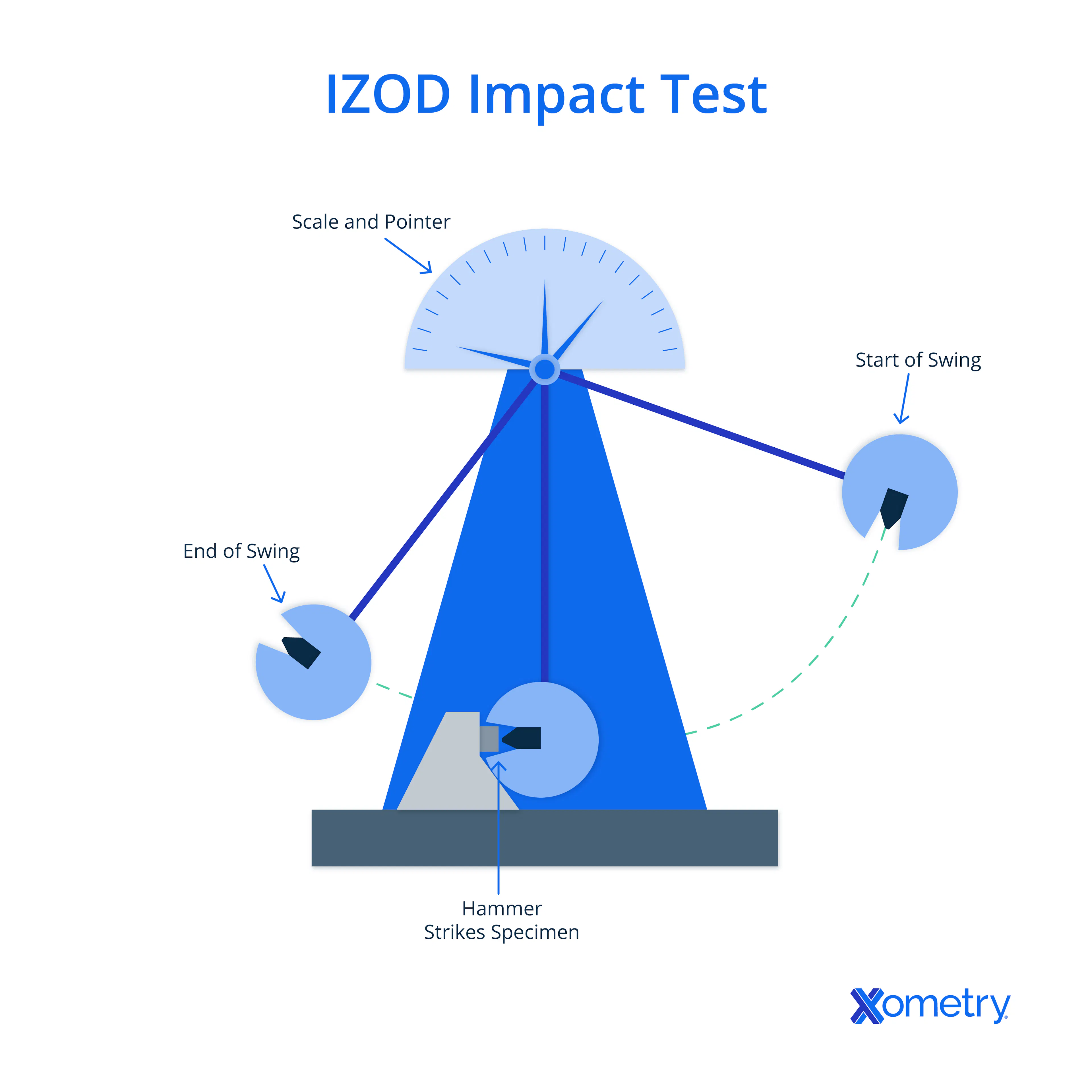

2. Izod
The Izod impact test is similar to the Charpy test in that a weighted pendulum hammer strikes a test specimen containing a V-shaped notch. An Izod impact testing apparatus — which is essentially identical to a Charpy impact testing machine — is used to determine Izod impact strength. The primary differences between the Izod and Charpy impact tests are the size of the test specimen, how it is restrained, and which side is struck by the pendulum hammer. The test specimen in the Izod test is fixed vertically on only one end, and the surface facing the notched surface is the surface struck by the hammer, in contrast to the Charpy test, for which the specimen is fixed at both ends and is struck on the side away from the notched surface. The test procedure for the Izod test is otherwise identical to the Charpy test. The test specimen is first prepared and mounted into the machine. Then, the pendulum is raised to a specified height and released to strike the upper tip of the specimen.
The Izod test, governed by ASTM D256, is most commonly used for thermoplastics. However, it can also be used for metals. Like the Charpy test, the Izod test is used to determine a material’s toughness and its ductile-to-brittle transition temperature.
How the IZOD impact test works
