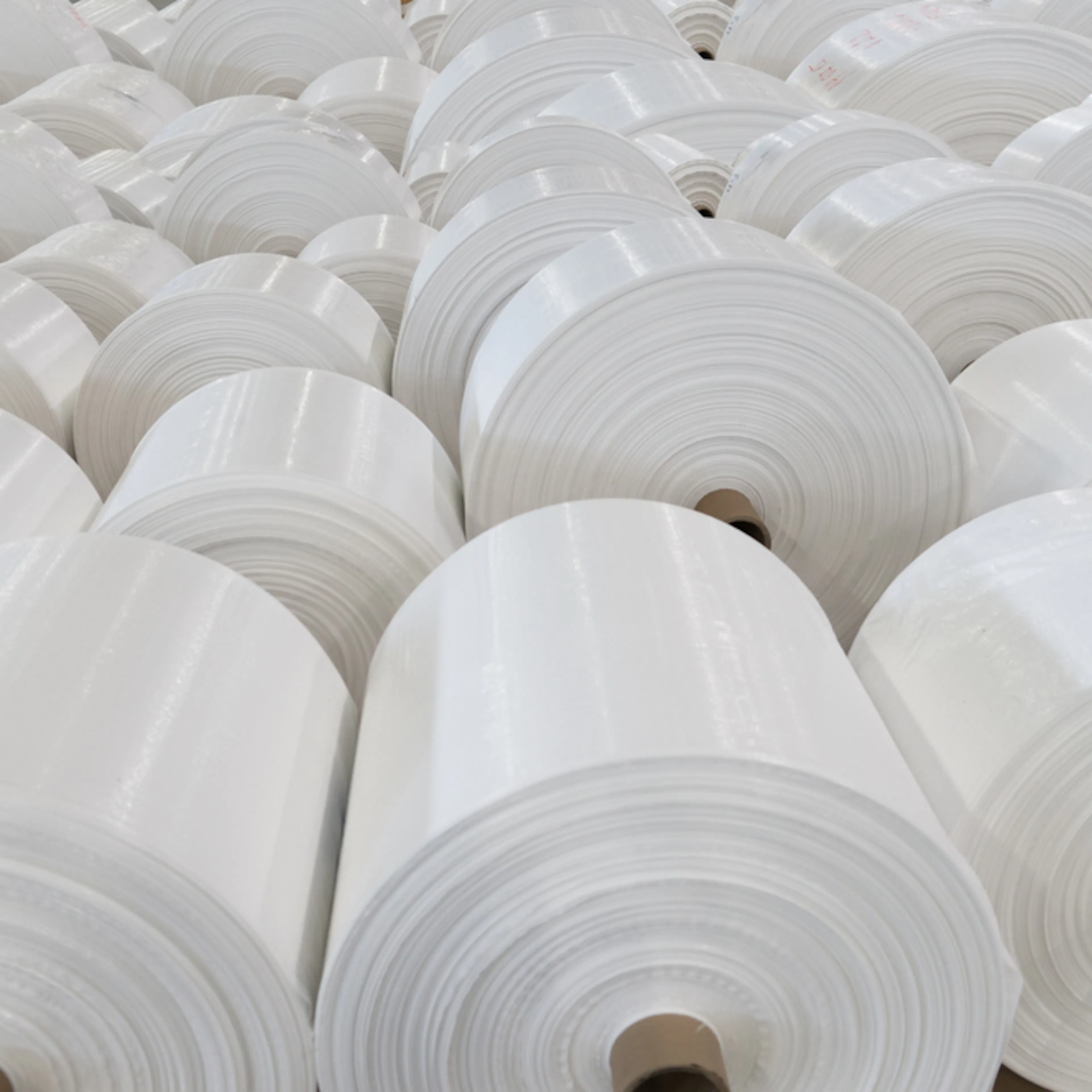

Polypropylene rolls. Image Credit: Shutterstock.com/AYRAT ALPAROV
