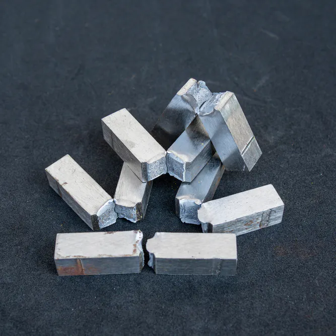

Striking standard size test pieces for impact test. Image Credit: Shutterstock.com/Thaweesak Thipphamon

A notched specimen is used for IZOD tests because the notch produces a stress concentration at the root of the notch and forces the fracture to occur at a repeatable location. By localizing stresses, the notch promotes crack initiation and propagation and minimizes plastic deformation. If the first hammer weight selected for the test does not break the sample, successively heavier hammers are used until the sample does break.
