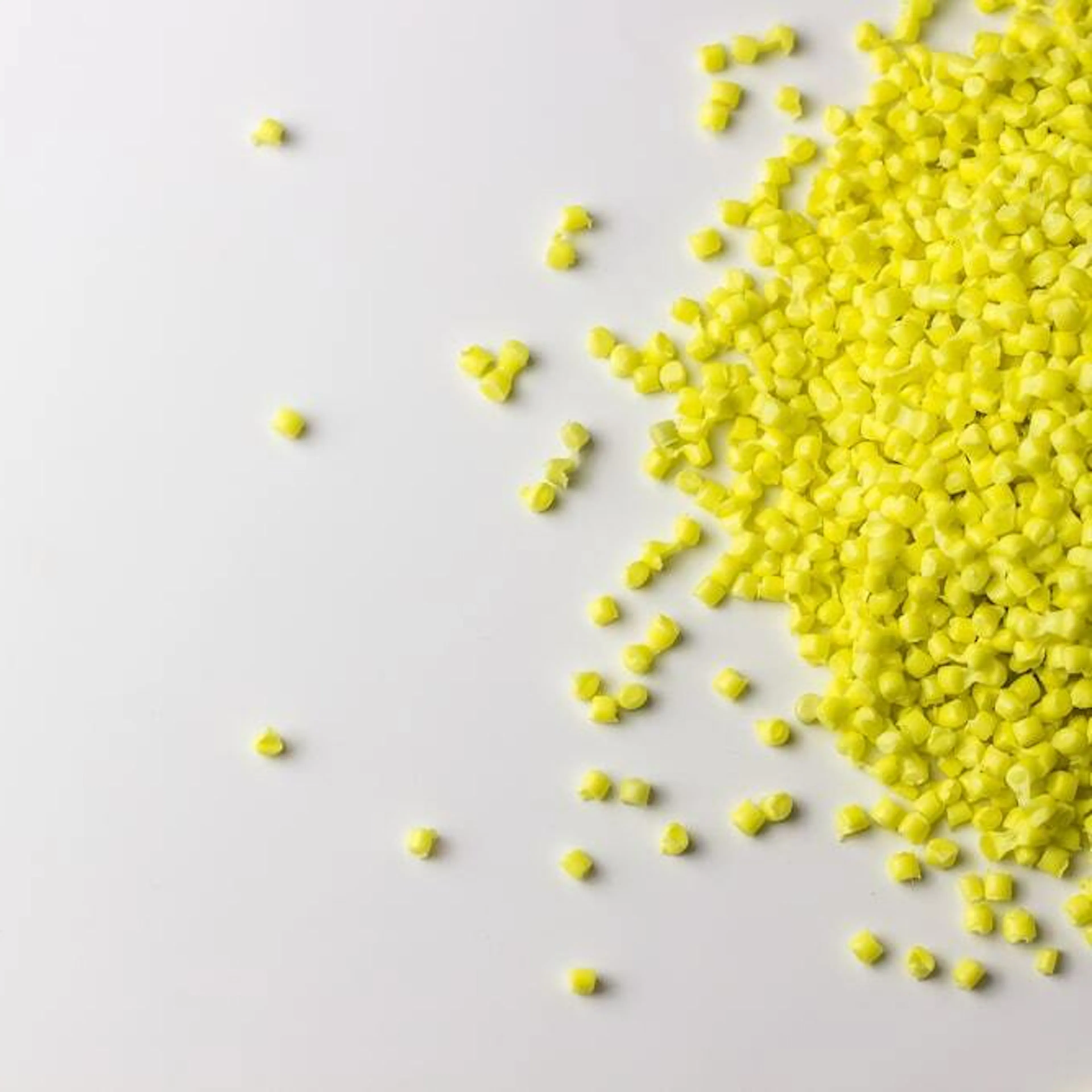

Yellow granules of polypropylene on a white background. Image Credit: Anastasiia Burlutskaia/Shutterstock.com

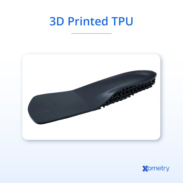

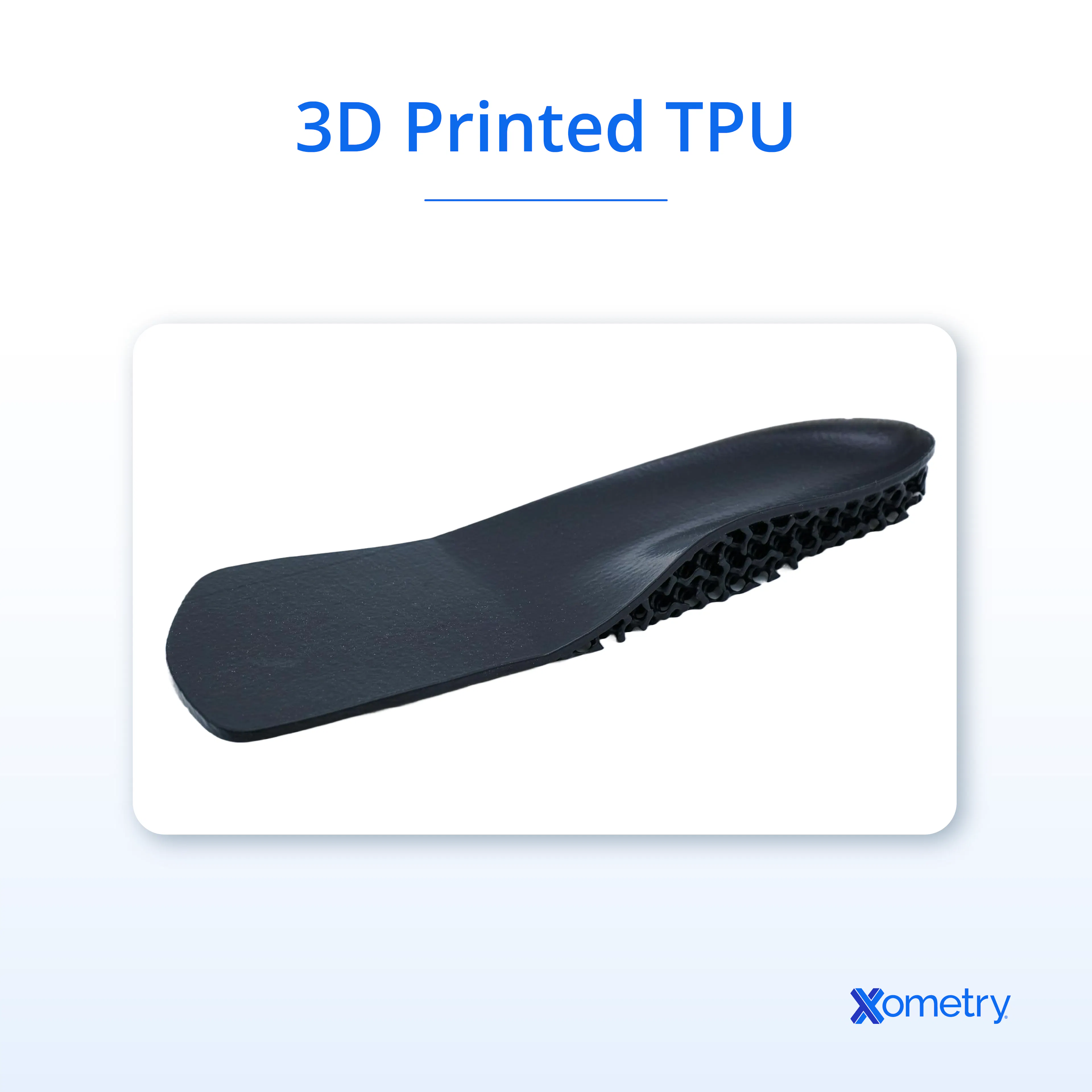

  • Thermoplastic Polyurethanes (TPU): The TPU delivers high abrasion resistance and elasticity, with strong mechanical strength across a wide temperature range. Their clarity and toughness support use in flexible films, footwear, and industrial components.

A photograph of 3D printed TPU.
