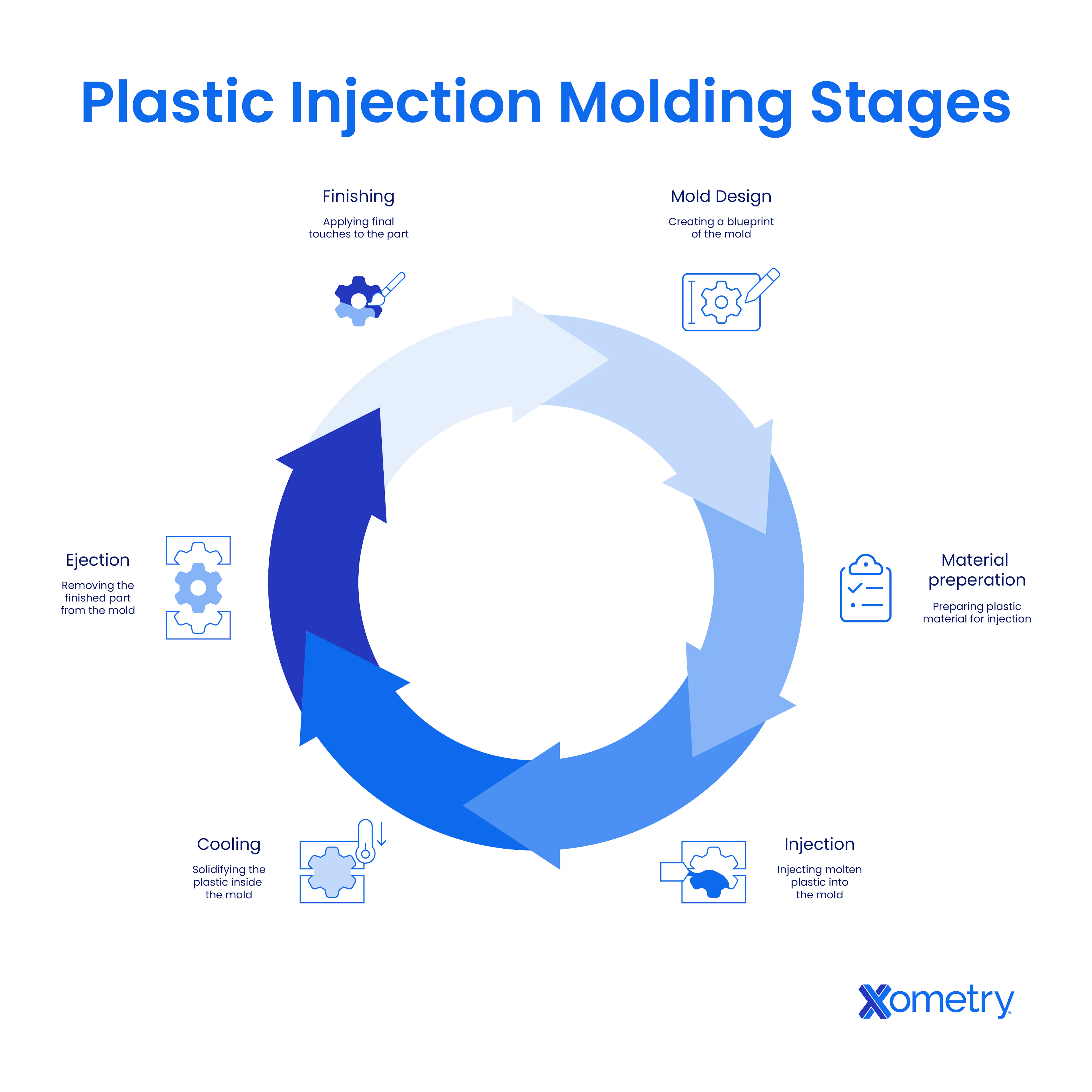

How Does the Plastic Injection Molding Process Work?
The plastic injection molding process works by following six steps. First, mold design involves creating a detailed blueprint using CAD software. Engineers select appropriate materials (typically hardened tool steel for production molds or aluminum for prototypes) for the mold and design cooling channels, venting systems, and ejection mechanisms to ensure efficient and high-quality production. Engineers use computer-aided design (CAD) software to ensure the mold produces the desired part with accuracy. Second, material preparation involves selecting and feeding plastic pellets into the injection unit. The pellets are melted and homogenized by a reciprocating screw inside a heated barrel before injection. The material is heated to a molten state, making it ready for injection.
Third, inject the molten plastic into the mold cavity under high pressure. The molten plastic is injected into the mold cavity under high pressure and controlled speed, ensuring the material fills the mold completely, including intricate details. Proper injection and packing pressure are crucial to prevent defects such as voids or sink marks and to ensure complete cavity filling. Fourth, the molten material is cooled within the mold, which solidifies it into the desired shape. Cooling time varies depending on the thickness of the part, mold material, and temperature. The cooling process must be carefully controlled to minimize shrinkage, warping, and internal stresses. Cooling time varies depending on the complexity and thickness of the part.
Fifth, ejection occurs after the part has cooled. The mold opens, and the finished part is ejected using systems like ejection pins or air blasts once the part has cooled and solidified. The ejection speed and force are carefully controlled to prevent part deformation or damage. Lastly, finishing processes, such as trimming, polishing, and painting, are applied to remove excess material, such as flash, and to enhance the part's final appearance. Secondary operations like overmolding, in-mold labeling, or assembly are often required, depending on the complexity of the part.
The steps are critical for the success of the plastic injection molding process because it relies on precise control of variables (temperature, pressure, and cycle time) to produce high-quality, accurate plastic parts. The plastic injection molding process ensures consistent, repeatable production with minimal waste.
