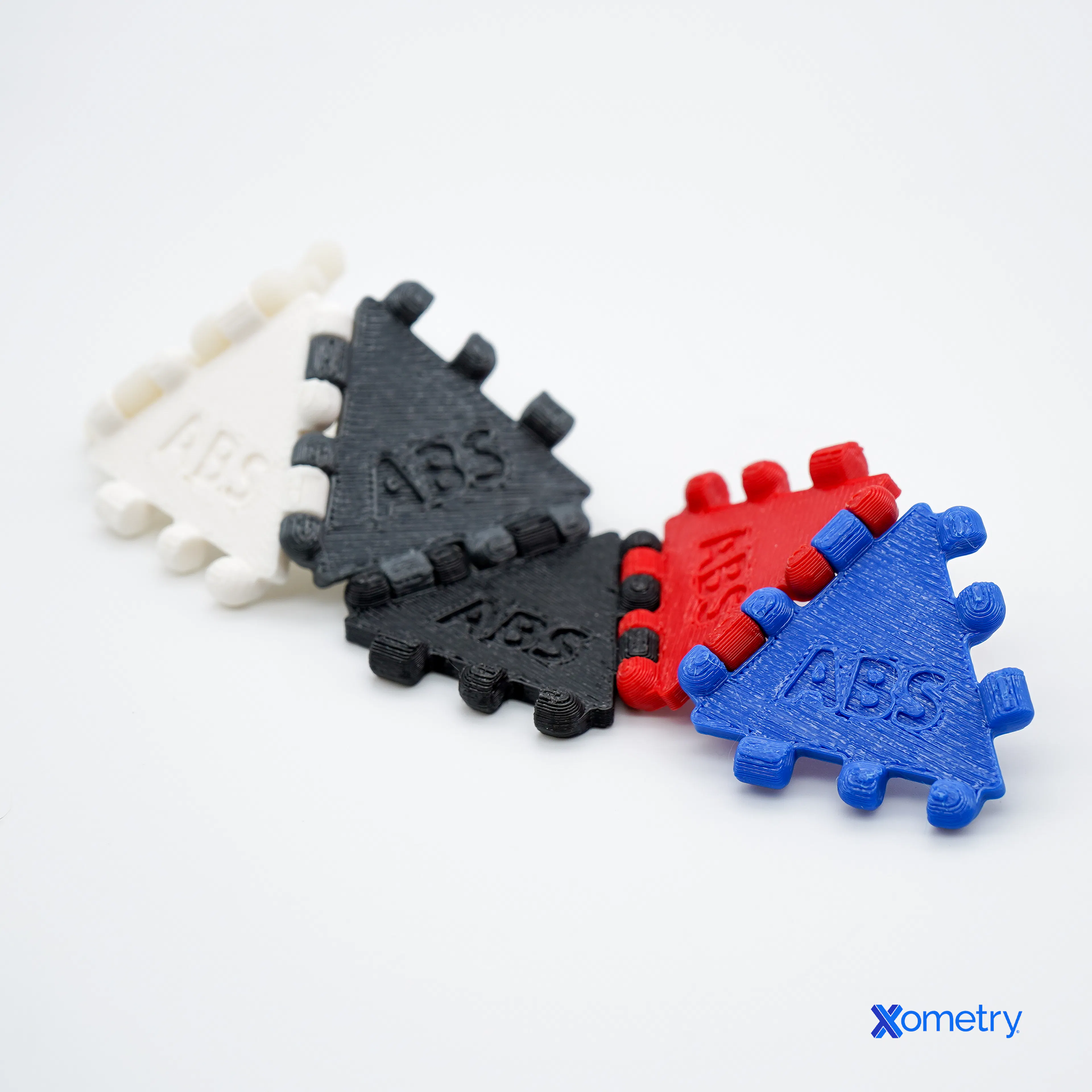

ABS Plastic
ABS (acrylonitrile butadiene styrene) is a high-strength general-purpose engineering plastic used for many commercial products. ABS is durable and lightweight. It is a terpolymer created by polymerizing styrene and acrylonitrile in the presence of polybutadiene. The proportions can differ from 15% to 35% acrylonitrile, 5% to 30% butadiene and 40% to 60% styrene.
What ABS Plastic Material is Used for Injection Molding?
ABS resin is an opaque thermoplastic polymer and an engineering-grade plastic. There are many advantages to using ABS. It’s tough, has good dimensional stability, resists impacts and scratching, and is hard to break. ABS is a good insulator and doesn’t conduct electricity or give off fumes if exposed to fire. These are essential considerations for product developers working on electrical devices.
What Products Are Best for ABS Plastic Injection Molding?
ABS is used to make products such as electronics, phone adaptors, keyboards, phone hardware, wall socket plastic guards, LEGO bricks, drainpipe systems, and kitchen appliances.
ABS polypanels
ABS polypanels
What is the Molding Temperature for ABS Plastic?
ABS has a low melting or molding temperature, making it ideal for injection molding. The process temperature is approximately 40-80 °C, preferably as high within that range as possible. Using a higher mold temperature tends to lengthen the molding cycle time, so the mold temperature setting depends on what is most appropriate for the individual product that is to be molded.

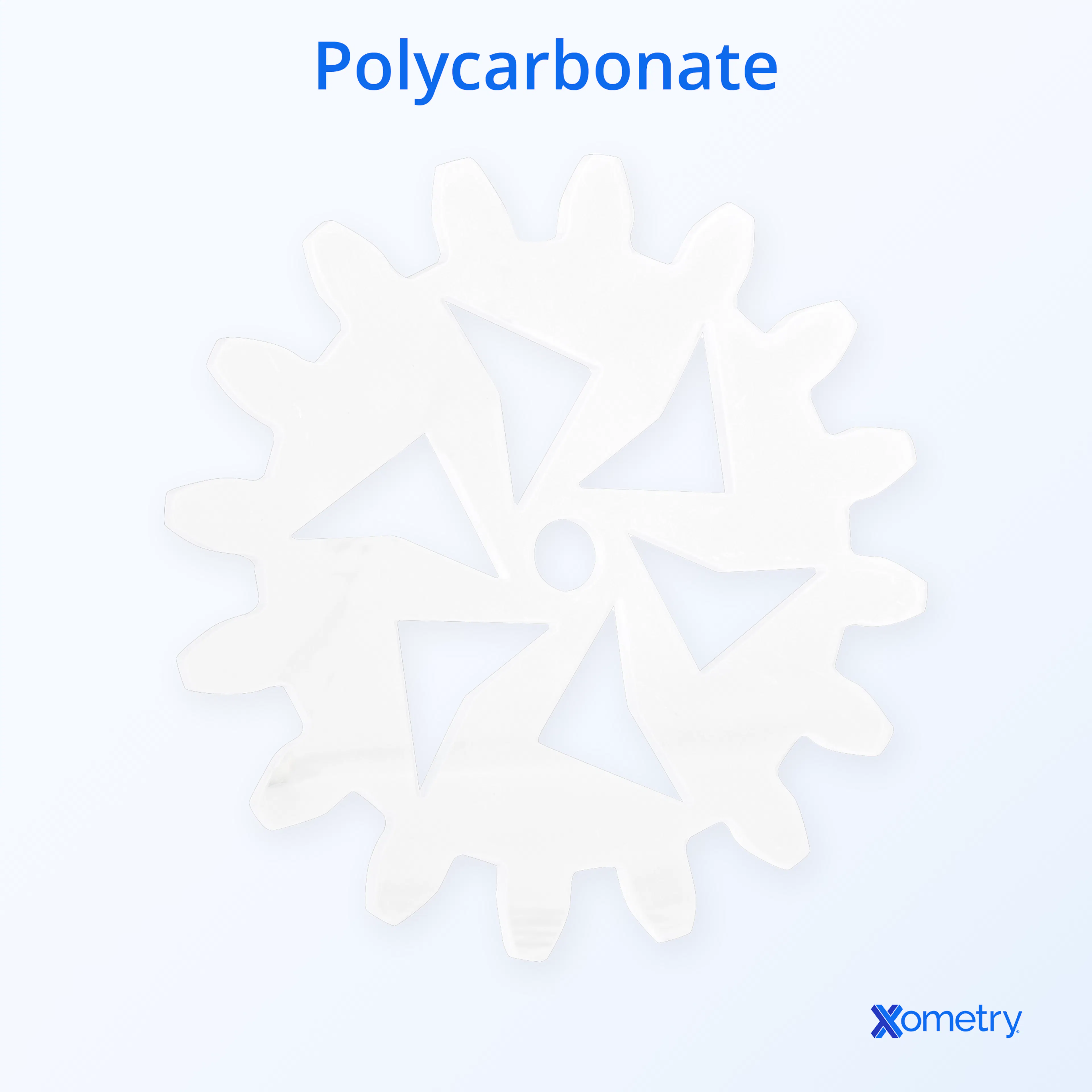

Polycarbonate (PC)
Polycarbonate is a high-performance, transparent, engineering-grade thermoplastic that can be used in higher temperature environments, due to its relatively high melting point (155°C). Those qualities come together with a higher price tag, but this aspect is balanced by the versatility polycarbonate.
The main features of this thermoplastic revolve around toughness and high strength, which translates into resistances to impacts and fracture resistance. These resistances are complemented by the material’s high density (1.2 – 1.22 g/cm3).
Advantages of Polycarbonate (PC)
The advantages of Polycarbonate (PC) for Injection Molding are listed below:
  • High transmittance (transparency)
  • Good operating temperature range (-20°C – 140 °C)
  • Flame retardant
  • Good electric insulation
  • Decent abrasion resistance
Disadvantages of Polycarbonate (PC)
The disadvantages of Polycarbonate (PC) for Injection Molding are listed below:
  • Susceptible to damage from hydrocarbons and bases
  • Low fatigue tolerance
  • Tends to turn yellow after exposure to UV
  • Mechanical properties degrade after prolonged exposure to hot water (>60°C)
Uses and Applications of Polycarbonate (PC)
The common uses of Polycarbonate (PC) include: safety helmets, bullet-proof glass, equipment housing, automotive parts, electrical connectors, and electrical insulators.

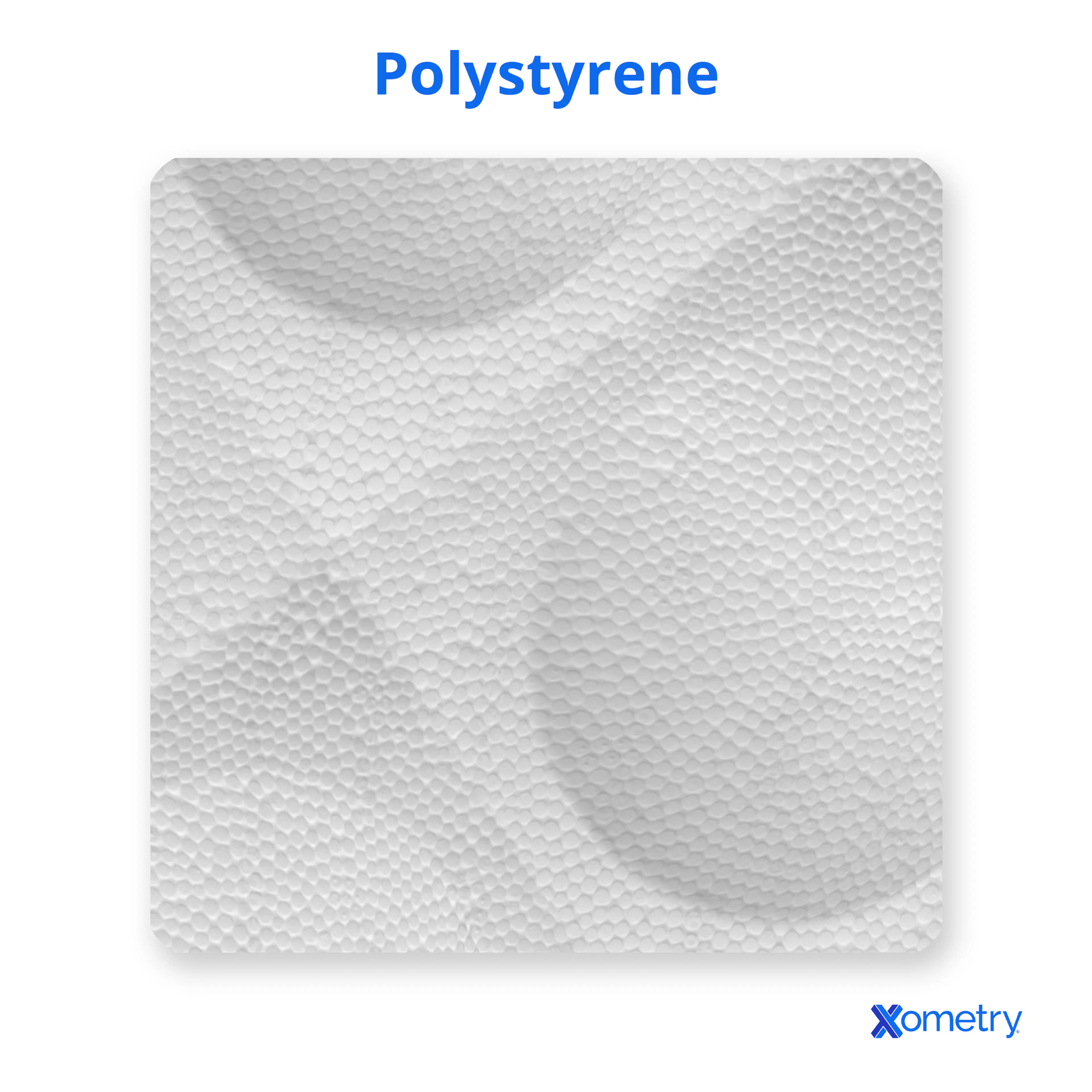

Polystyrene (PS)
Polystyrene is a very commonly used plastic in packaging applications and consumer goods due to its relatively low cost. However, PS-based litter takes a very long time to decay. Depending on the type, PS can either be classified as a thermoplastic or thermoset (a plastic that is not melted for processing).
Besides the low cost, polystyrene is easily processable for techniques including gluing, painting, cutting, and sanding.
Advantages of Polystyrene (PS)
  • Cheap
  • Transparent
  • Easy to mold and process
  • Good electrical properties
  • Rigid
Disadvantages of Polystyrene (PS)
  • Poor chemical resistance
  • Flammable
  • Brittle
Applications of Polystyrene
Applications and uses of polystyrene include: packaging, toys, cutlery, cassette cases, electronic housing, containers, glazing, and tool cases.
