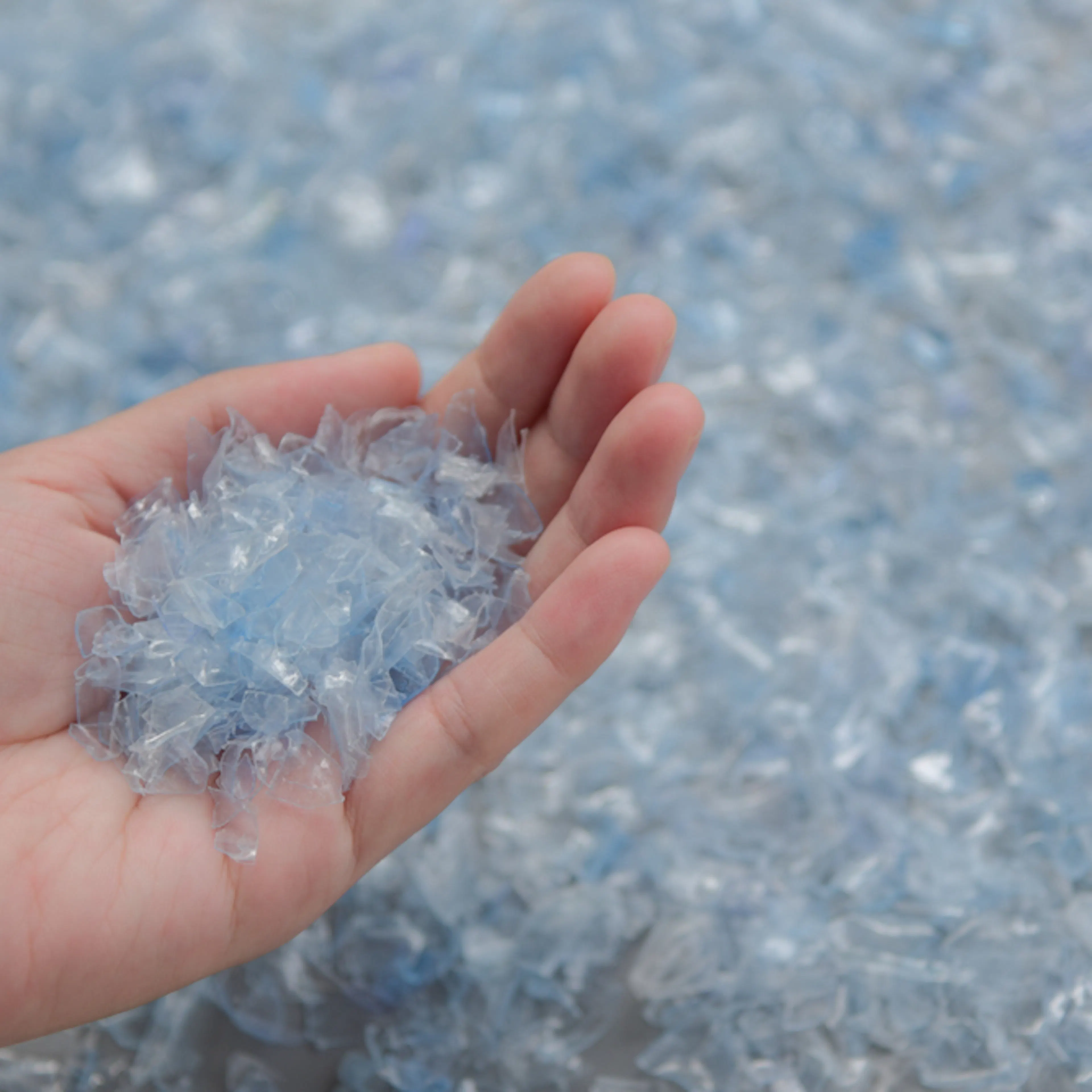

PET bottle flake. Image Credit: Shutterstock.com/RecycleMan

The mechanics of PET (polyethylene terephthalate) recycling are similar to that of HDPE—sorting, washing, shredding, and melting extrusion as chips. However, the manufacture of clear drink bottles consumes the largest amount of PET (after fabrics), so the sorting process is considerably easier as there is great homogeneity in the feedstock. This makes PET one of the only polymers that can sustain a truly circular supply chain. However, recycled material in its second incarnation is rarely used for high-quality bottles because of the potential for contamination during waste collection. Some use is made of twin films, where a thin, virgin material layer is used in the food contact surfaces. This is backed by a thicker, recycled layer. Most recycled PET is not made into bottles but goes to clothing/fiber production. Overall, although PET is highly recyclable, most markets make little use of recycling. Instead, the waste goes to incineration, landfill, or to the environment.
