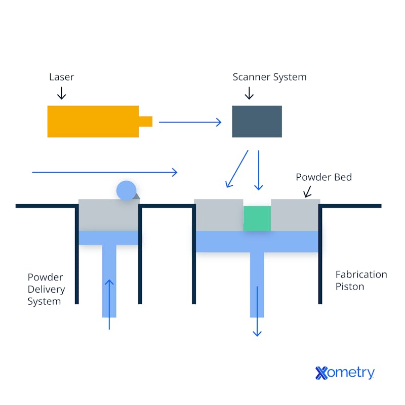

What Are the Primary Parts of an SLS 3D Printer?
The different parts of a 3D SLS printer are listed below:
  1. Laser: The laser (typically a CO2 laser) is used to sinter the plastic particles into each other. The laser is directed using a scanning mirror which directs the laser to trace out the layer cross-section.
  2. Material Delivery System: The material delivery system stores all the powder. As the part is built, this mechanism supplies material to the recoater.
  3. Recoater: The recoater drags material from the powder delivery system and lays it out onto the print bed/preceding layers.
  4. Print Bed: The print bed moves down as the part is printed, typically between 50 and 200 microns per layer depending on the required resolution. A thin layer of plastic is placed on the print bed for each new part layer by the recoater.
  5. Heaters: Heaters keep the build volume at an elevated temperature to assist with the sintering process by reducing the energy required by the laser to sinter the powder.
SLS 3D printing diagram
