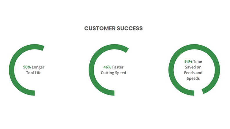

We surveyed G-Wizard customers and here’s what they told us:
Frankly, I was shocked at these results.  But, then I thought about the many conversations I’ve had with folks and I was a lot less shocked.  G-Wizard considers over 60 variables, and it uses machine learning (AI) techniques to optimize your cut depth and width for the best possible results.
