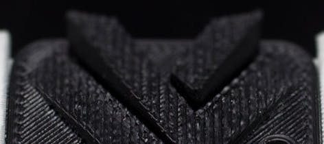

3D printing in PC using FDM technology does not typically give you many potential surface finishes. However, PC is available in black, white, or clear plastic. In addition to this, some basic surface finishes are listed below.
Standard: Support structures are removed and some light sanding is performed at the support locations. It must be understood that in general FDM creates a surface texture with visible layer stepping. If a completely smooth part is required right off the machine, other 3D printing technologies like SLS or HP Multi Jet Fusion should be considered.
